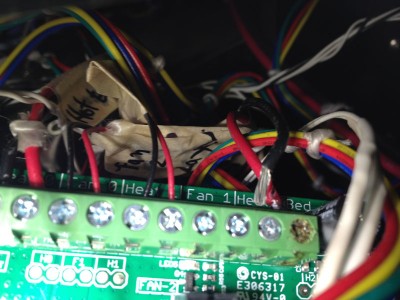

Finished rebuilding my Rostock V2 last week after some parts arrived. I ended up cutting off the molten section of the screw terminal and soldered two 12ga wires directly to the RAMBO. Since I only measured about 9.8V there I used that to control a relay which switches power to the bed on and off ...

Ok. So I am in the process of rebuilding my Rostock after the connector melt down. So far I cut off the part of the screw connector with the two melted terminals. I have rewired the heated bed with 14ga wire and also soldered 14ga wire directly to the Rambo board and secured it with kapton tape. I ...

I built this over a year ago and I *think* I followed the instructions - this means the hot bed should be 18ga? But, yes, the hot end wires are thicker. So, replacing the hot bed wires with a heavier gauge (15?) would be a good thing. I measured the resistance on the bed and it is 1.1ohms. Also, the ...

Thanks for the input.
15A fuse is fine
Looking at the trouble spot it looks to me as if the red and black wires which feed the bed heat are getting pretty hot during operation and over time weakened the insulation enough that the wires got exposed and shortened out.
15A fuse is fine

Rostock Max V2 heated bed short
After successfully installing & starting to use octoprint on my V2 (and printing a good number of stuff) today in mid-print I see the heated bed temp dropping. This was midway through a 4.5 hour job. At that time everything else was working fine except heated bed (although I didn't check in my haste ...
