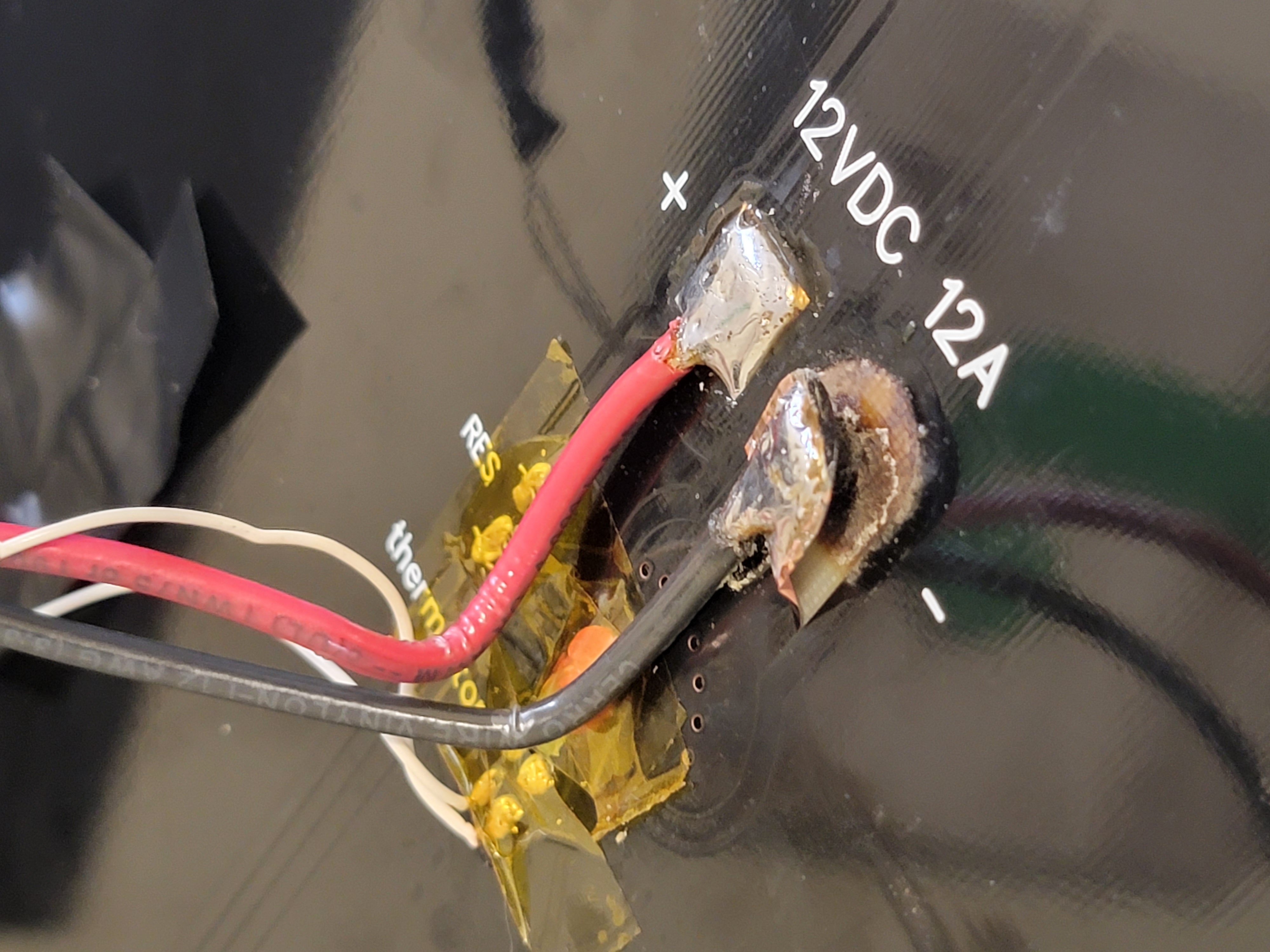

Wed Dec 01, 2021 11:50 am
Forum: Troubleshooting
Topic: Rostock Max V2 Preheat Causes Software Crash
Replies: 11
Re: Rostock Max V2 Preheat Causes Software Crash
Hi. Thanks for the reply. It was indeed a broken curcuit at the bottom of the heated bed. Is it possible to buy a replacement for the onyx rev7?

Fri Nov 05, 2021 3:22 pm
Replies: 11
Hi, Ive had my V2 since 2015, its been a wonderful time together, but lately im having an issue i cant solve. If the bed gets a current put to it ( to preheat) the software crashes. This is not random, it happens every time. the fuses on the RAMBo are fine, the wiring is not decaying. I recently ...
