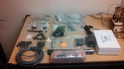

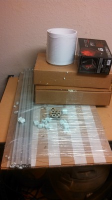

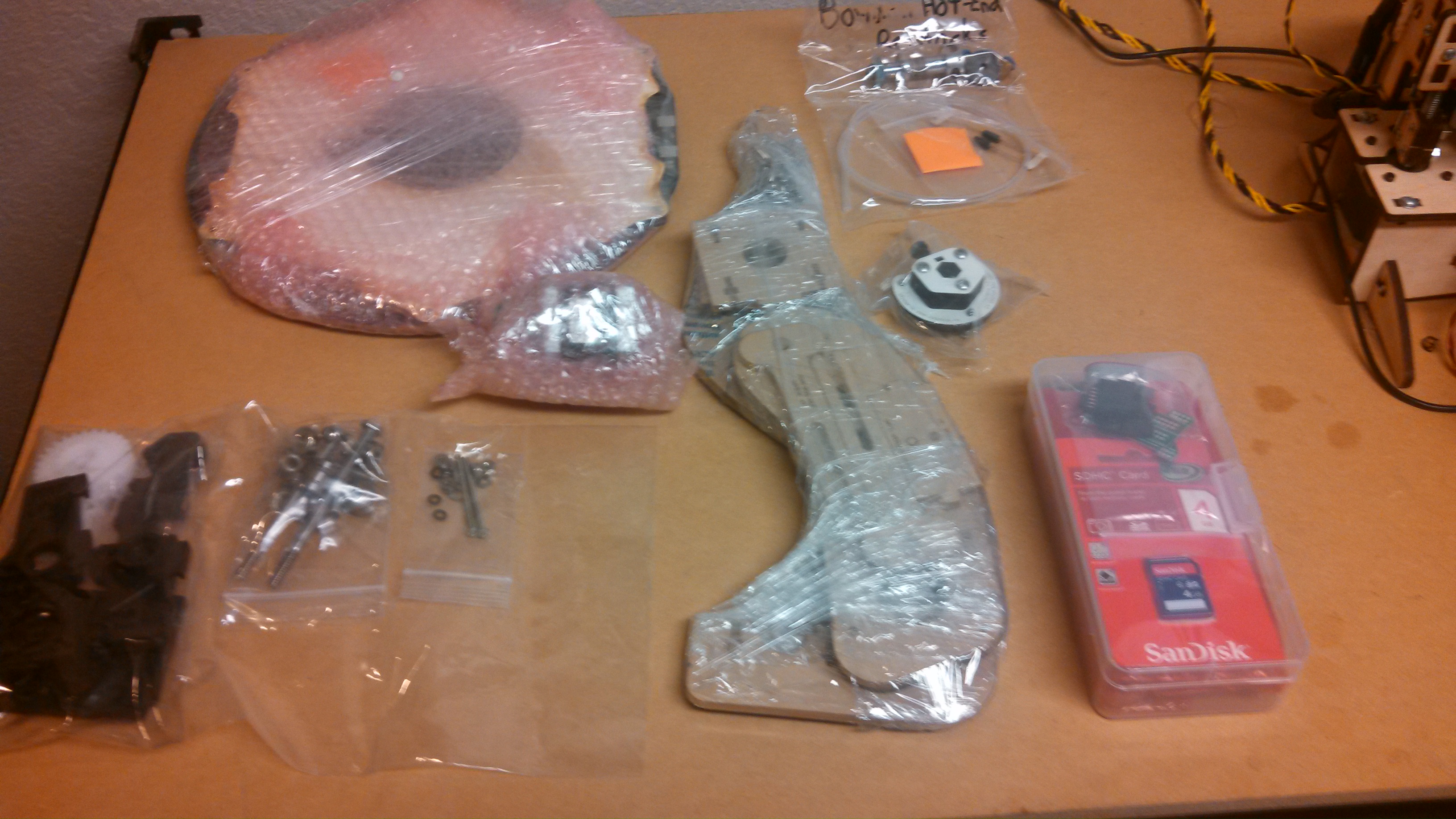

Re: dmlonestar - Rostock build
Items floating in the larger box (minus the 3 spools of ABS - maybe should have shipped those separate):
Smaller box (electronics, motors, arms, etc):
Larger box (add-a-struder + motor, LCD, Onyx, pen-holder):
