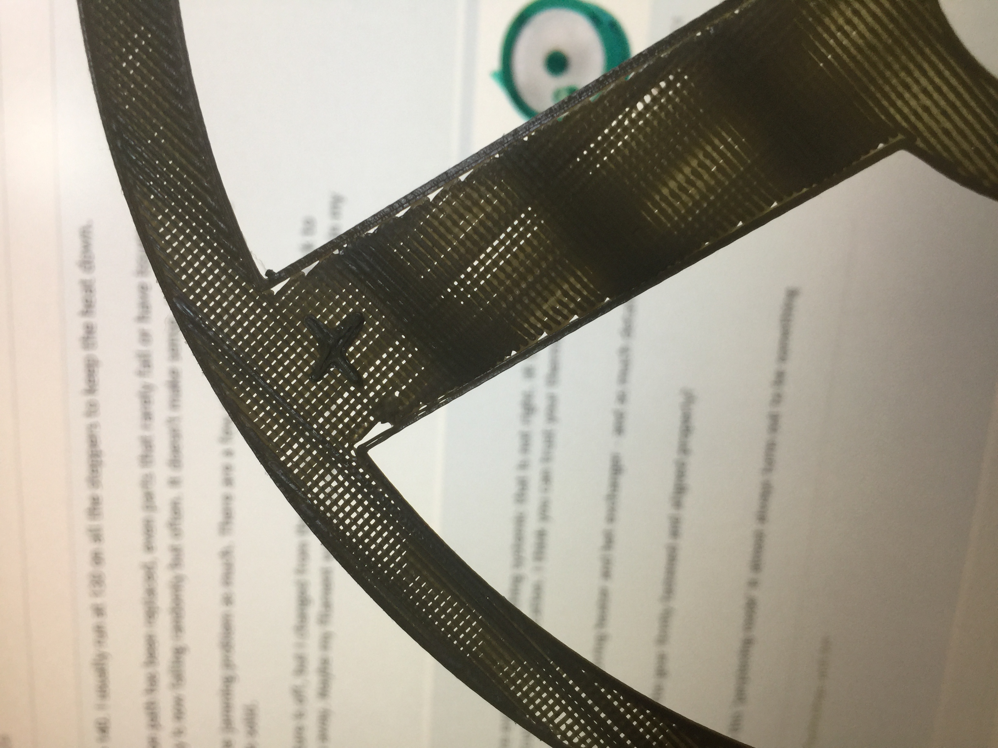

It looks like some of the lines overlap the perimeters and some don't. Unfortunately there is not always a simple answer. Due to the randomness of the end lines I might suggest you try changing the temperature you are printing this filament. Does your first layer look the same way? What type of ...

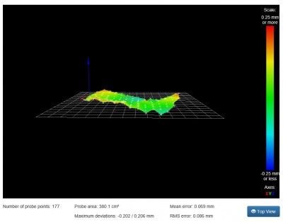

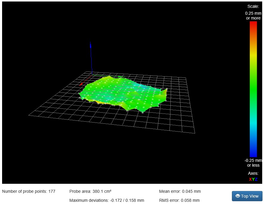

- Fri Jun 02, 2017 9:48 am
- Forum: Troubleshooting
- Topic: Another height map error
- Replies: 2
Re: Another height map error
Ok, sorry I did not wait for a reply. Here is a new map after changing my Z motor counts to 79:
Is this normal? Is there some other mechanical issue that might be causing this? Belt tension perhaps?
Or should I be looking to replace that stepper motor?
- Fri Jun 02, 2017 9:17 am
- Replies: 2
So this is fun. Here is a picture of my current height map: map.jpg This is after G32 calibrations. I rotated my print surface and the map came out the same. So it seems I have an issue with my Z tower, but not exactly sure what. Axis compensation perhaps. But I am thinking this problem has ...

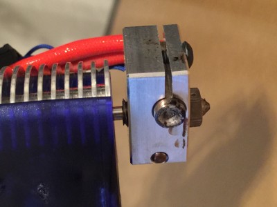

I checked the rotation of the extruder gear / shaft, no wobble. I think the dark area in the picture is just a shadow, when I shine a light on it there is no obvious mark. I did a small adjustment anyway, moving the gear out a bit. Ultimately no change. Back to the filament that clogs so well, high ...

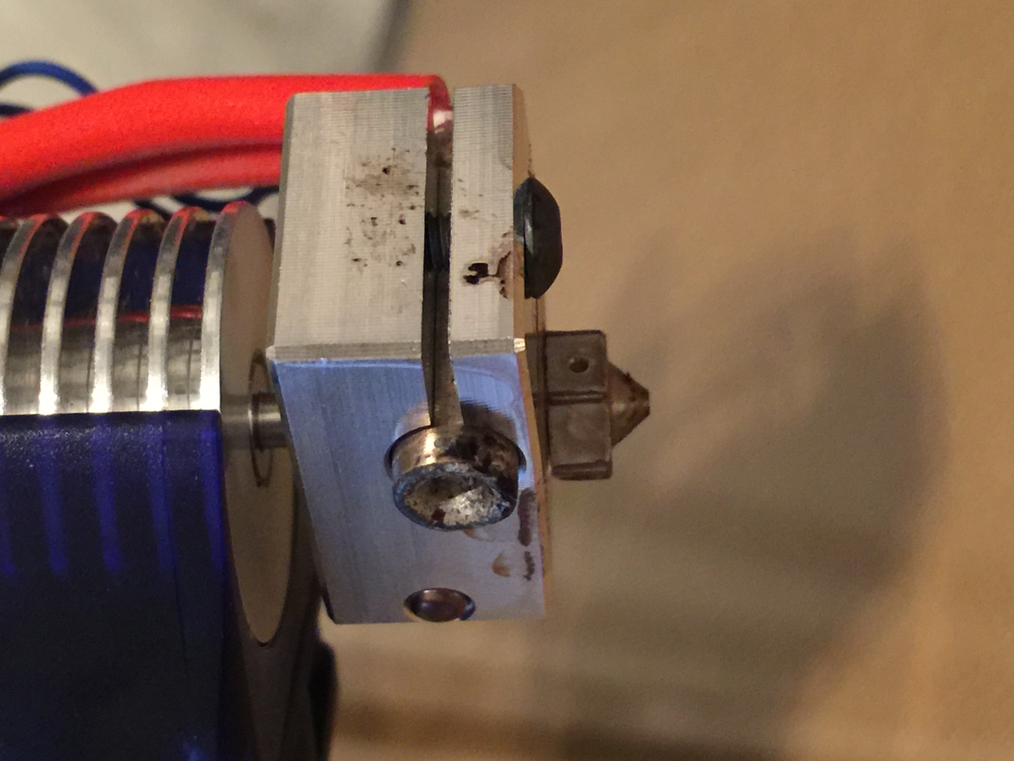

I did a close watch on an aggressive print (lost of short back and forth movement) The temp was stable, the cooling fan stayed on the entire time. I moved the wiring around to see if I could cause a problem but nothing changed. Here are some pictures: I think my extruder is aligned properly IMG_1975 ...
