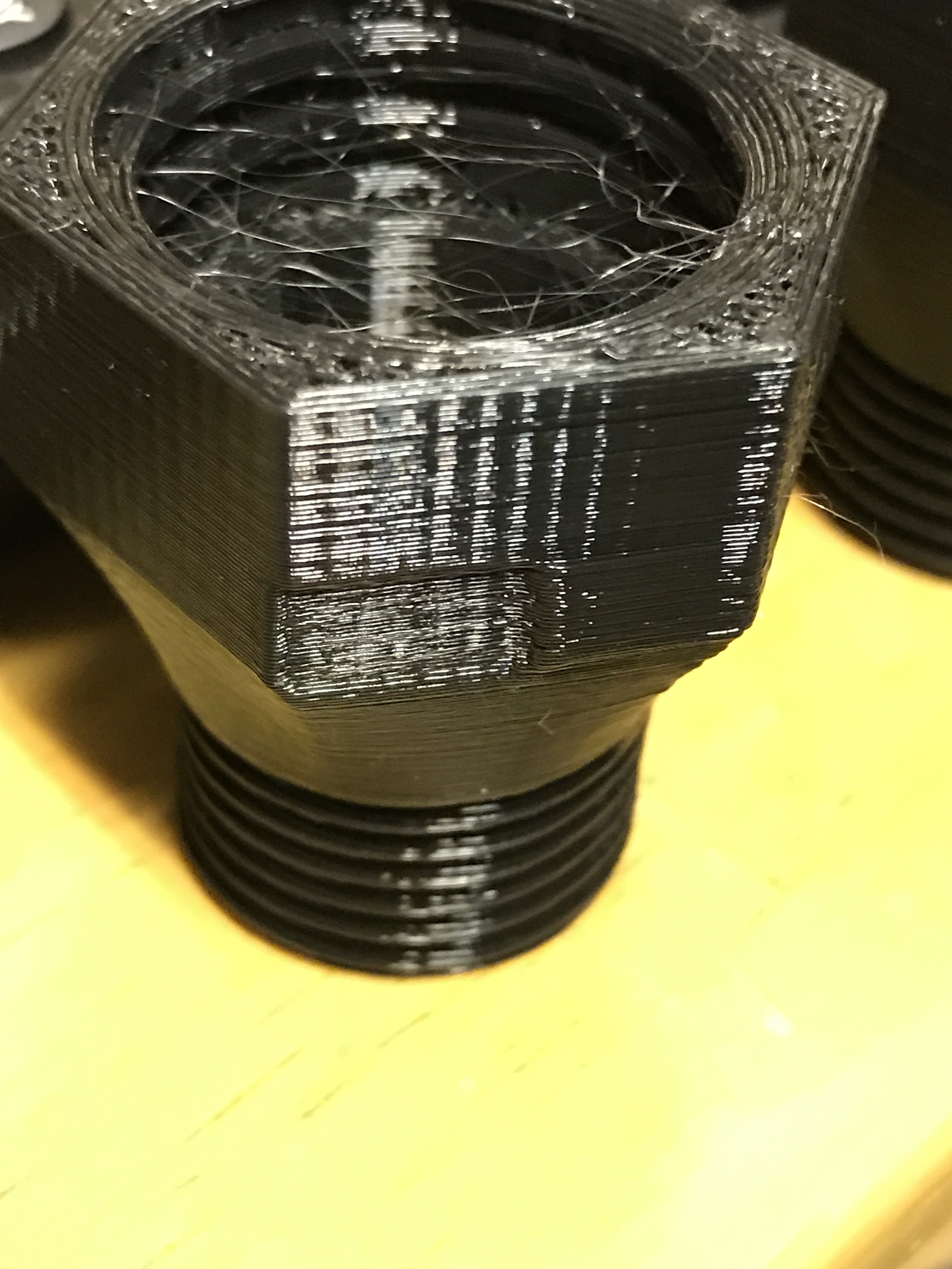

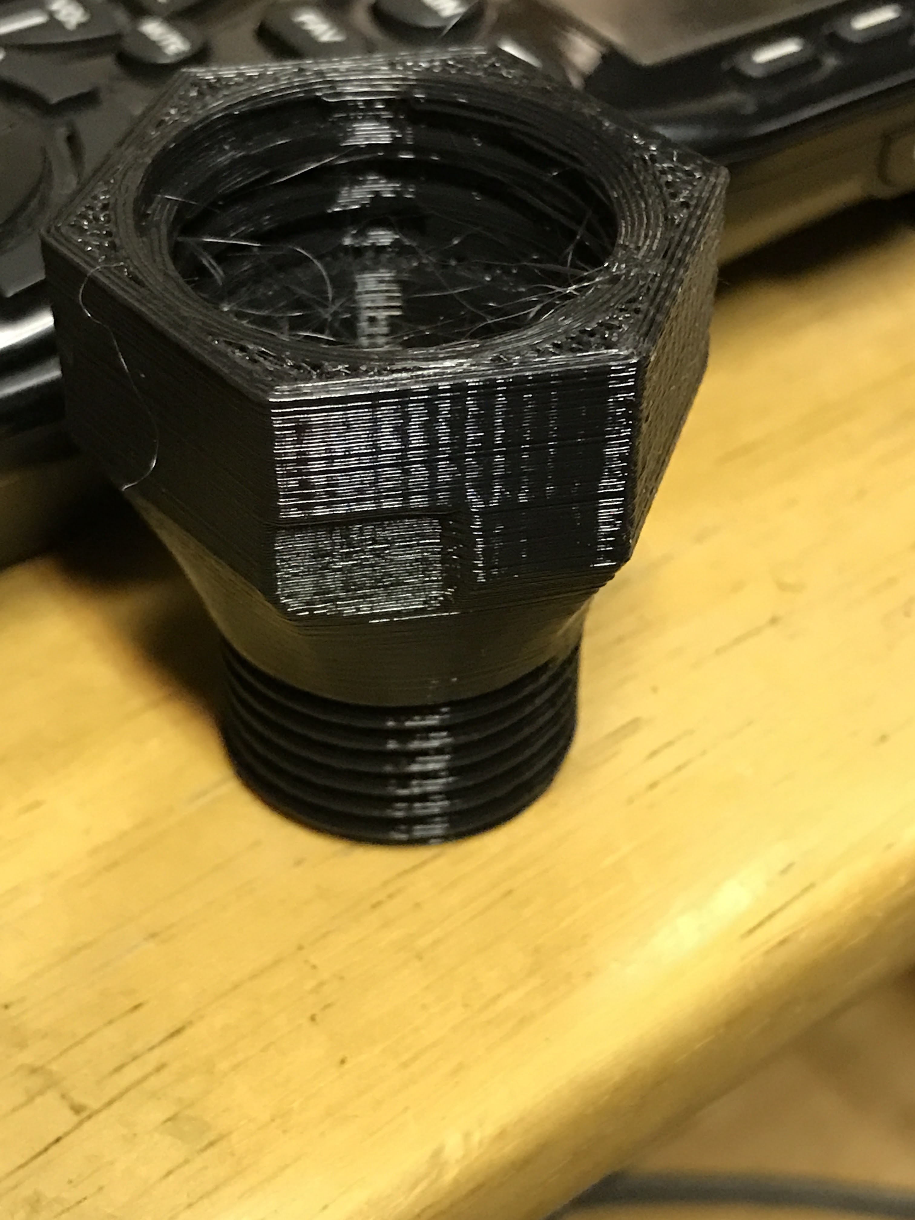

Re: KISS multiple copy bug?
Looks like rotating the STL 90 degrees avoids the sidewall bug on 6 copies, testing will continue.

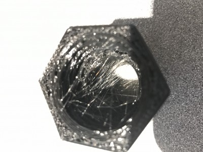

I think the STL looks ok, Blender found 11 thin faces, 1 sharp edge and 2464 Overhang faces. Everything else was 0.
I am trying a couple small changes to the slicing like Infill % and rotate to see if it makes a difference.

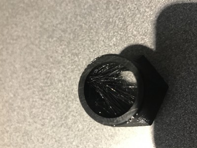

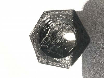

So... 1,2,3,4x copies print fine. 5,6,7 have issues on one or more of them. Cura graphical looks good, but I can't imagine that it is a mechanical issue due to the consistency of the issue, the fact that the center of the bed is fine for 1 copy, and has the sidewall error on the 6 and 7x multiples ...
Does anyone know of a KISSlicer bug in 1.5 where sidewall artifacts can be introduced when you make multiple copies of something? I have an STL that when I make 6x of them, 1/6 has the artifact, when I make 7 2/7 have the artifact. 1x,2x,3x,4x are fine running a test on 5x now. It doesn't appear to ...
