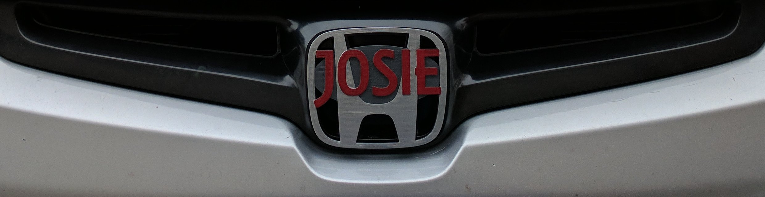

Grill ornament
I spent the holiday fixing up a 2003 Honda Accord for my daughter. I had to put a new grill on it and it was $25 just for the fancy logo. So I printed and painted my own. It's the first print from my Rostock Max V3. Not bad.
