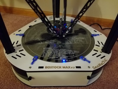

Xenocrates: since the beds are just clips, if you had a thicker heat spreader, you would likely need to print the hold downs since it is designed for the thickness of the bed and glass only, or use a heat spreader the same thickness as the glass. In the base is the power supply.. the wires ran to ...
by guanu
Thu Mar 17, 2016 10:58 am
Forum: The Lounge
Topic: Rostock Max V3 Sighting
Replies: 34
Re: Rostock Max V3 Sighting
To hit all your points U.S. Water Rockets: Yes No, I just had 1000 blue leds of that size from a project about 7 years ago and thought it would look cool so I put it on since I was bored when I built it. Correct They are. No, glass is flush with wood base so we used the same clips the eris uses as ...
