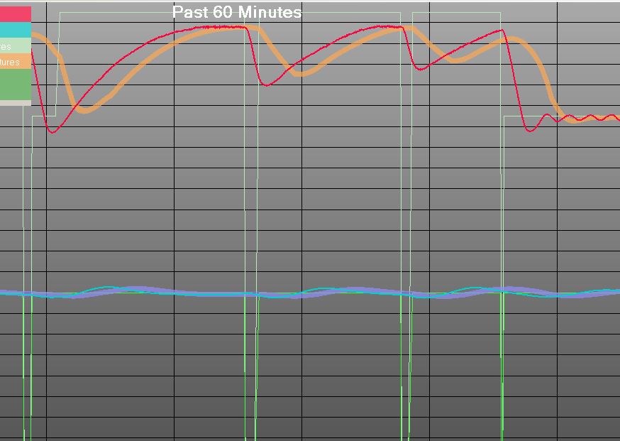

I found i can cheat it, by adding 10 degrees to my desired set point for the extruder, when it gets about 10 degrees away from hitting the set point i stop the extruder fan for about 15 seconds. this lets the extruder heat up to the set point and it starts printing. put the fan back on and it will ...

with the new numbers it takes longer to get there, and now stops about 10 degrees low. have played with the I value bumping it up, nothing. went back to original settings still nothing. i can set to preheat abs and it holds to the set point no problem.

So is it normal when i run the pid auto tune my new averages are significantly higher than the original set points. original P = 15.91 new average is 56.16 original I = .75 new average is 5.93 original D = 84.02 new average is 134.46.
i ran auto tune again and got even higher averages.

ok, replaced fuses and new thermocouple. it is heating up, but now for any print the extruder stops heating 3 degrees short of the set temp and the print never starts. i have tried changing my extruder temp from 235 (it stopped at 232) down to 225 (it then stopped at 222). i dropped to 220, it stops ...

troubleshooting extruder heater
for those of us who are not electronics wizards. is there a good troubleshooting guide or video on testing and troubleshooting heater problems. my extruder is no longer heating up on my orion and need a good place to start.
