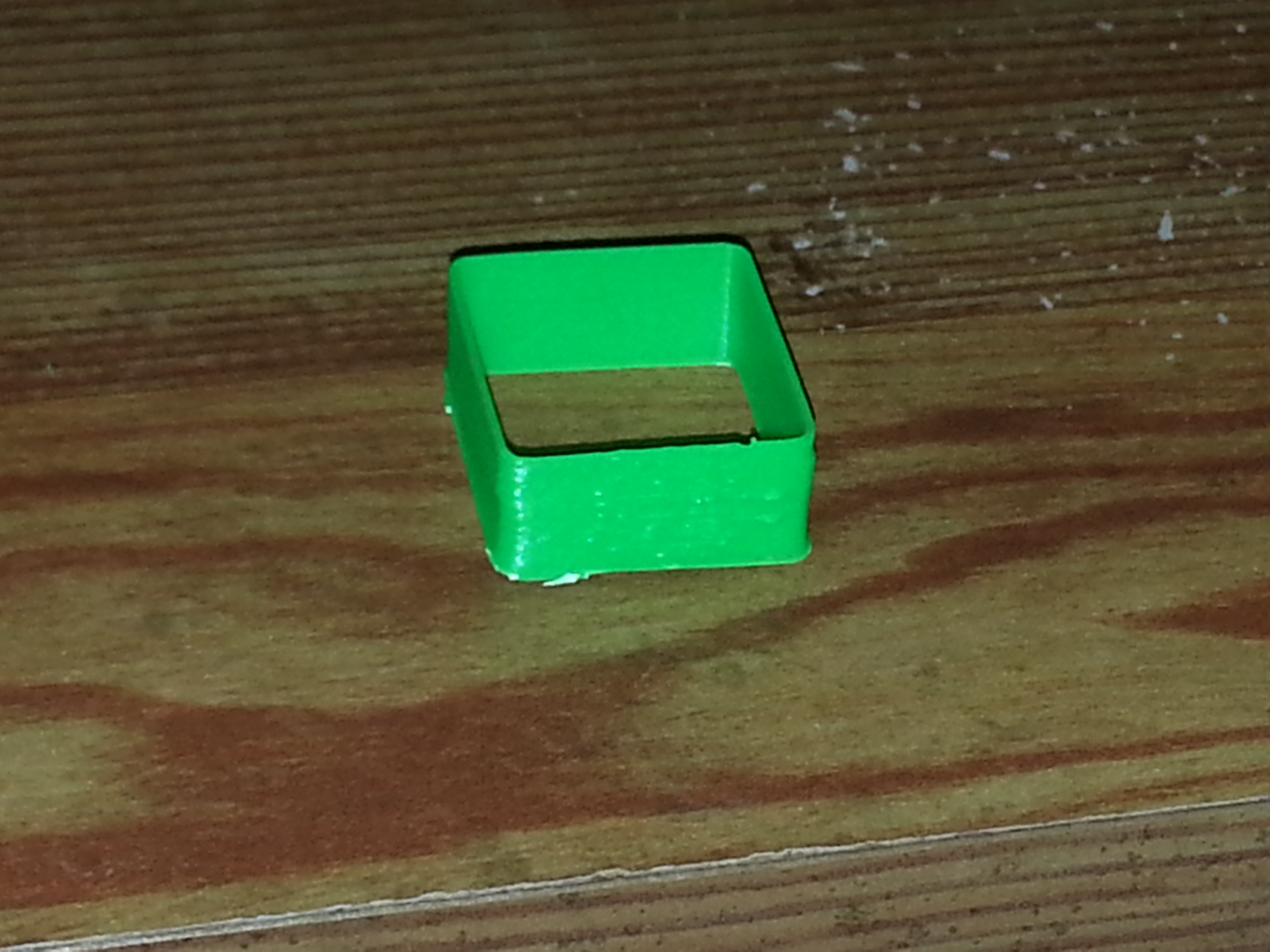

Re: Bad Layer Starts
Here are some pictures
The first shows the slant to the right.
The second two show the globs on the starting side.
I hope these are clear enough - they are the best shots I could get.
Thanks,
Jason
Thanks - I am done following the posts instructions. It is definitely an improvement, but there are still some globs. Is there an acceptable amount of globing or should it be perfect? I now notice that there is an overall slant to one side. it does not look like there was one slip, but just a steady ...

Bad Layer Starts
I am printing the .5mm thin wall cube. Everything is perfect except the one wall which the printer starts layers on. It is full of globs and a few holes. I tested the print with random start points but the wall was still a mess. What would cause this symptom?
Thanks,
Jason
