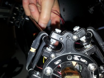

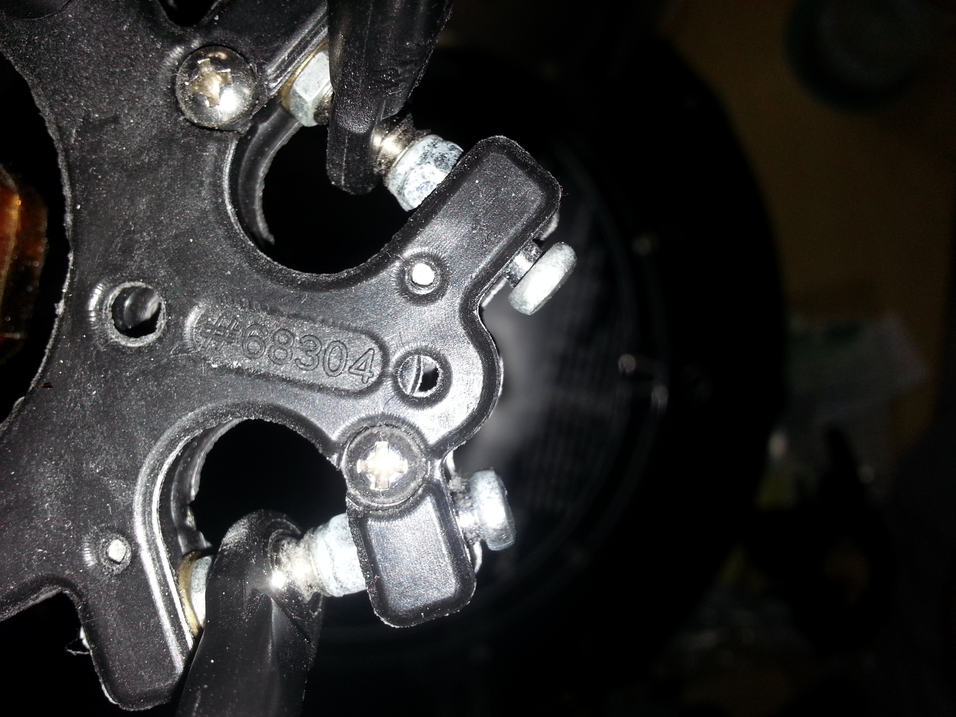

Thanks Eaglezsoar, I attached a pic showing the two screws that are in the way preventing me from slipping the shroud all the way on snug up against the platform and I circled the screws in red. Should these screws be screwed flush down against the platform to get them out of the way? Effector ...

Here's the top view of the platform:
Here's the bottom view of the platform:
I cannot slip the shroud onto the platform because the screws heads are sticking out a smidgeon so they are in the way. Your help in figuring this out is appreciated.

Thanks Eaglezsoar, I also noticed even if the slot in the shroud was wide enough that the screws in the platform will block it from going on all the way. Here is a pic showing the screws are not flush against the platform. Should the screws be screwed in all the way into the platform? Screws Not ...

Eaglezsoar, thank you for the info. Here is a pic showing the shroud too narrow to fit over the platform. Still not sure where the problem lies. Is my Rostock Max out of spec? Is there a calibration cube I can print to make sure I am printing to correct dimensions? (Not sure why the pic got turned ...
