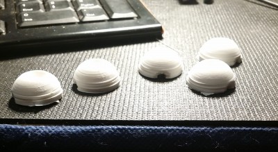

Re: Ridges in print.
OK, I gave that a shot. In twisting each of the cheapskates I could feel that one of them could torque a little. So I turned the casters to add a little tension and remove a little slop in it. I then loosened up all of the cheapskates (the screws between the belt clamps) so they could move a little ...
Here is a photo of the aforementioned test prints.
Hello, So I have been working on trying to get the ridges out of my print with little success. I have found some issues that needed to e fixed along the way, but nothing that gets rid of the error. The first problem I found was that the bed was super loose. Two of the blind nuts had stripped and ...
