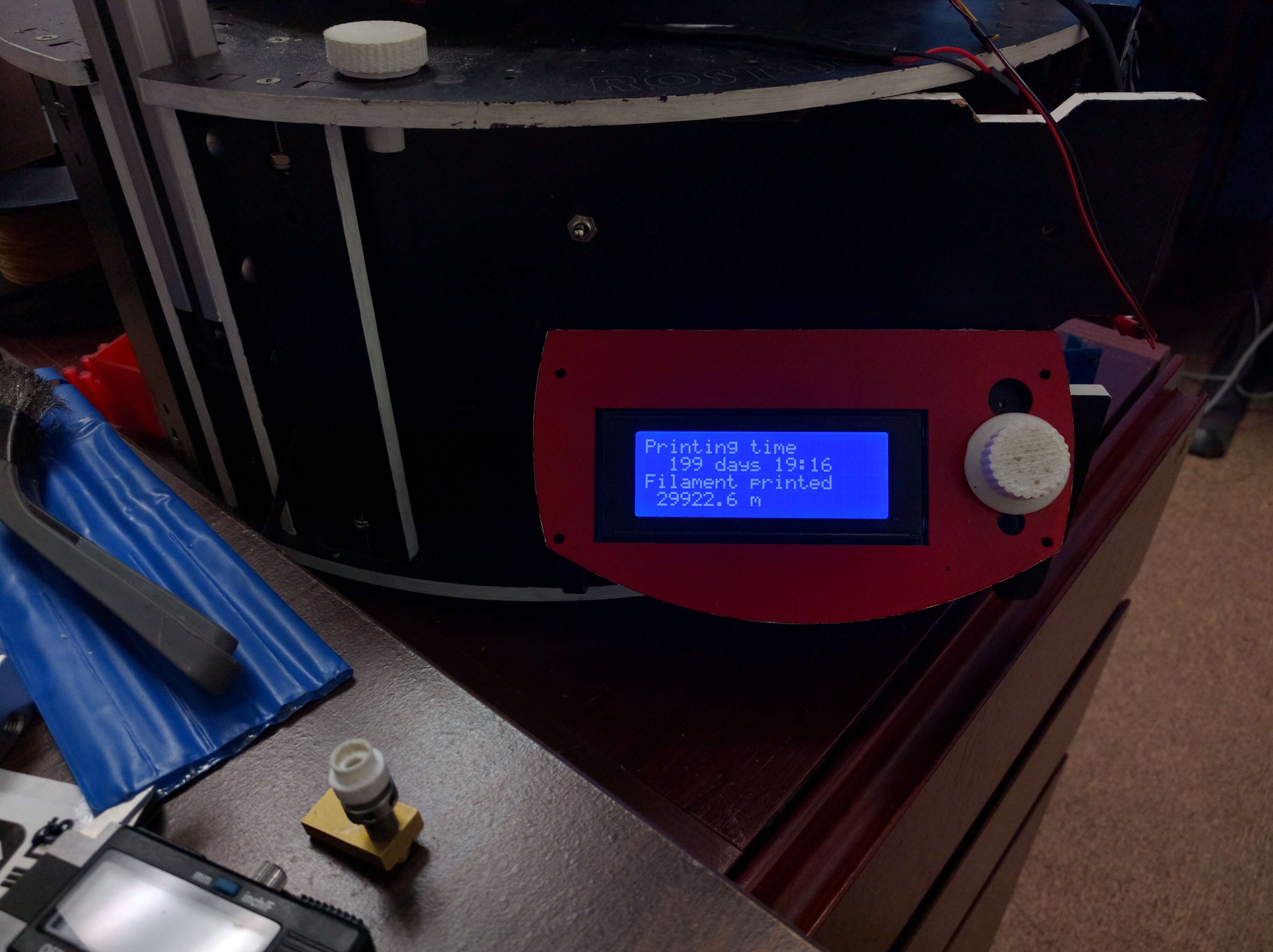

Nearing 200 days...
It's actually a bit more because I was running a smoothie board for a couple months, but my trusty v1 is still chugging along...
