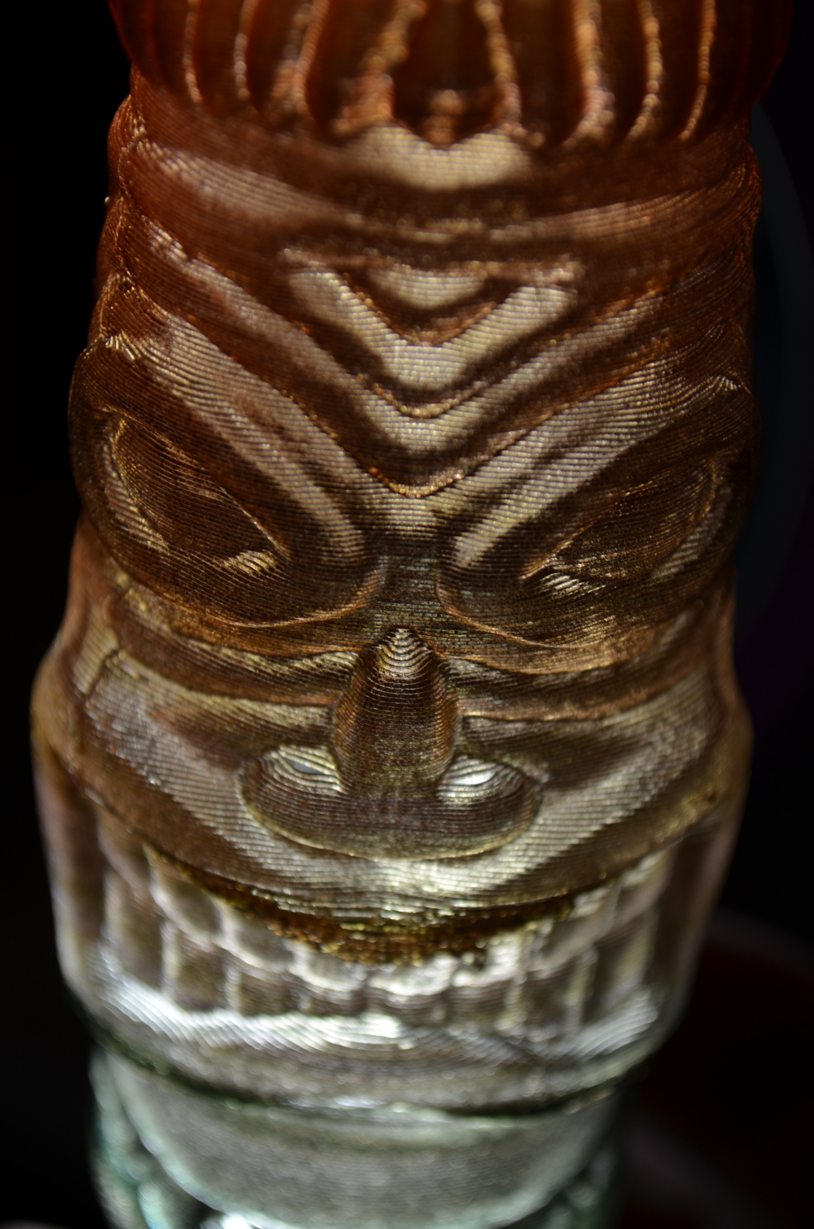

Re: T-Glass Vase
sharpie-on-pla-DSC_2932.jpg OK... I just couldn't splain how good this colored t-glass looks :) This is how I sharpie-colored the Tiki man t-glass. In the photo I used PLA for its contrast. You can see it is a small thin stripe. That lil thin red stripe made the gold color on the tiki man. Now the ...

Re: T-Glass Vase
Backlit with a white LED and tilted a bit.

Re: T-Glass Vase
gold tikiman-DSC_2904.jpg Ummm... I use a Sharpie :) If you mark only 1 side of the filament it gives a really good optical effect as you tilt it up/down. Diff effects depending on what side you mark. Colors may change when you print, red sharpie makes a good Gold :) You can see the color through ...

Re: T-Glass Vase
t-glase-vase-No-1-2-3-DSC_2892.jpg The larger one ... I bumped up the speed to (30mm/s) x 120% and bumped the temp up to 220. The first 3 layers don't like the speed. Had to do them at 30mm/s and slicer slows it down to 30% of that so 10mm/s on them. Looking at them real close I can't see any diff ...

Re: T-Glass Vase
t-glass-vase-done-002DSC_2867.jpg t-glass-vase-done-DSC_2868.jpg 30 mm/s, 215 hot end, 60 on the bed till the bottom 3 layers were down then dropped to 40 for the rest of the print. 0.3mm layer, vase setting in Slic3r. It has a hologram effect to it, changes as you tilt/turn it. I am very happy ...

T-Glass Vase
just can't get the photo to show how awesome this looks.
