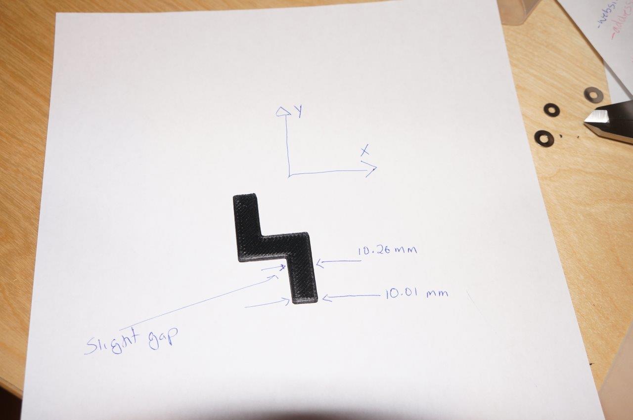

I have a slight gap on my test. See attached picture. (sorry for quality black is hard to photo). Anyhow my issue with the gap seems to be with the outside loop being too far away. It measures 10.26mm wide at the place of the gap and 10.01mm wide where there is no gap.
I've sanded and lubed all my arms but I still have a bit of stiffness in them. I bought extra arms when I bought the kit. I sanded one arm too much as the top and bottom inside were not even touching the u-joint and it was still stiff. I think this is because of the hole the the nipple on the u-joint pops in being a little small. I figured this will loosen up with time.
Re: Don't get those Delta Arm Blues!
That is glass filled nylon and really is not going to wear in easily. Best to chamfer and fit these before installing.
