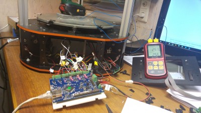

I was able to get a Duet 0.6 for a reasonable price and have been "dry testing" it, without any printer actually connected.
It looks to work okay so far and the web interface is up. I updated it to DC's 1.16 (the latest stable) firmware.
- Since the update (needed a press on the Erase and the Reset buttons, after that I used Bossac. The Board works, the web interface works. But it strikes me that the Duet now manifestates as "Serial USB Device" in Windows Device Management, instead of "Duet - something" like it was before. Also it seems to shift up a Serialport each time, is that necessary?
- I read that since the recent versions the firmware can be updated through the web interface. But I can't find any guides for that.
- I In the guide here: http://reprappro.com/documentation/comm ... e_Firmware it says that the SD card files must be update to the same version as the bin. I did find the WebControl zip, but cannot find anything else. Shouldn't I update the other (SYS?) dir also
I am waiting for some connectors to fly in, so I will have to rest my experimentation for now.

I am studying the pinlayout of the Duet 0.6. I thought there would be an abundance of data available on the web about this, but it seems the duet only got popular after the release of the 0.8.5 version.
I understand there is only one controlled fan output, labeled as FAN0. My guess is that this one is to be used for the layer fan(s), and the peek-fan should be connected directly to the 12V PSU rail (think I'll attach a connector to the 12V power in screw-terminal). Is that correct? Is there an easy way to make the peekfan thermo-controlled outside of the bed? I'd like to get it to go off after dropping below 50C like the rambo does.

Still no connectors for leads, so I cut off everything and started knitting it to screwterminals as they are. I was already able to do a 7-factor calibration, so motion is all okay. Still a few questions though. But first a picture of my Max on the IC of my office
Looking through the config.g i see values for the stepper current are expressed in milliamps. How does this relate to the values most of us are used to in the Rambo firmware. I am using the original Wantai motors the machine was send out with by SeeMeCNC. The older SeeMe firmware worked at a value of 165 (1-255). For the more recent firmwares I use a percentage value of 65. But what would be comparable values for the DC42 firmware? It is working at 1000mA righht now, seems to be good but I'd like more detail.
I have been trying an autotune on Heater1, but I get a respons like "Auto tune cancelled because starting temperature is not stable". I don't know if it is normal, but the temp value in the GUI is fluctioating about 1,5C. My thermocouple shows a pretty stable temp with no fluct at all. If I engage the heater it seems to heat up pretty normally, and I do get 12V-ish at the heater connection. Why is my thermister so jumpy, and could that be the cause of this error?
Few days ago we debated the use of dead-time control, now I learned that there is no such control in DC42's firmware. But the default bang-bang works great on my setup, with a temp fluctuation of not more than a degree C. So that is as neat as dead-time did on the rambo. Some however say it is better to switch to PID, even on a SSRed bed (that cannot give partial current). My PSU however has a fan that starts without temp controll. It just blows above a certain current (in practice, only when the bed heats). I think PID would wear out that fan quickly because of the quicker switching rate. Does that make sense or am I over concerned about that?
I can't seem to get any extrusion done. The extrude and retract buttons in the webGUI are Greyed Out. I suppose I need to heat first to above a certain temp?
Thanks again!
Thanks again!

I just tried a pid tune preheated to 30C using M303 H1 P0.5 S240. That is working. First I got an error about reaching the max temp. I lowered the P to 0.3 and with that it reaches a max of 202.1C. I copied the resulting M307 H1 A615.2 C174.3 D9.1 B0 to the config.g I guess the PID values are calculated from there? Now the hotend temp is pretty stable, and the thermistor reports within 0.6C correctly. I think I will leave it like this
Autotuning the bed is a nogo I think, Th 20V SSR setup only goes flat-out, so it will always hit the max I think. It looks pretty stable as it is though. I find that surprising because there is really no PWM commands in the config.g at all. Are there already some sensible defaults that work for onyxes? This autotuning is really working differently than for the Rambo...
Re: Duet 0.6 Setup questions
Auto tuning the bed should be possible. The firmware uses slow (10Hz) PWM for the bed and chamber heaters so as to be compatible with all types of SSR. However, you can estimate the bed heater model parameters manually if you prefer, see https://duet3d.com/wiki/Tuning_the_heat ... s_manually.DeltaCon wrote:I just tried a pid tune preheated to 30C using M303 H1 P0.5 S240. That is working. First I got an error about reaching the max temp. I lowered the P to 0.3 and with that it reaches a max of 202.1C. I copied the resulting M307 H1 A615.2 C174.3 D9.1 B0 to the config.g I guess the PID values are calculated from there? Now the hotend temp is pretty stable, and the thermistor reports within 0.6C correctly. I think I will leave it like this
PID parameters are calculated from the model parameters unless you override them with M301 commands. If you run M307 H1 then it will show the calculated PID parameters as well as the model parameters.

Thanks DC, but I am confused. While tuning the hotend, I learned that (other then with the Rambo) you reduce power to the heater until it cannot heat anymore. Calculated PID values are based on the power, and the time it needs to go to the max temp. Since the SSR always gives 100% power in an open state, even though PWM dictates e.g. 50%, My Onyx will always go beyond what is considered healthy for it, no matter how much power I base the tuning on. Tell me where my logic is flawed
- Posts: 1561
This is a issue of not applying pwm. If I apply full power for one second, then half power for 2 is equivalent. Pwm works on that, by switching fast enough you barely notice. I'm pretty sure that the MOSFETs on the duet are never run in the switching zone as it generates much more heat and would reduce the power the board could handle. All the peaks are the same height, it is the number of them or their width that matters for power deliveryDeltaCon wrote:Thanks DC, but I am confused. While tuning the hotend, I learned that (other then with the Rambo) you reduce power to the heater until it cannot heat anymore. Calculated PID values are based on the power, and the time it needs to go to the max temp. Since the SSR always gives 100% power in an open state, even though PWM dictates e.g. 50%, My Onyx will always go beyond what is considered healthy for it, no matter how much power I base the tuning on. Tell me where my logic is flawed
- DeltaCon
- Posts: 616
I understand what you are telling Xenocrates. In the PID tune for the hotend I had to set the P-parameter to 0.4 for the hotend not to exceed 240. In the case of the bed, due to the SSR, I cannot set the P parameter any why that it works, because the SSR is just closed or not. I understand that PWM can choose short power bursts instead of half power, but I do not think the autotune is going to work when the heater is setup this way, Do you have any idea how hot it will get at max without any power reduction? (20V / 29A). I don't think I want to find out...
Duet GUI tells me this:
It reaches 100C in just over 4 minutes during a tune. I would not want to to try what the max reachable temp is
EDIT:
To amuse myself I tried P0.3 in the above command. I thought that would not work, but it seems to alternate power on/power off like Xenocrates mentioned. So the PID tuning for the bed works differently than for the HE, because there it will just partial current to the heater. So I will let my bed cool down and give it another shot. Thanks!
PWM works by turning the heater fully on for part of the time, and fully off for the rest of the time. That's what the MOSFETs on Rambo and Duet do, for the hot end heaters and for the bed heater. It makes no difference whether you use a MOSFET or an SSR to do the switching, except that some types of SSR can't switch very fast. That's why we use a low PWM frequency for bed and chamber heaters.
