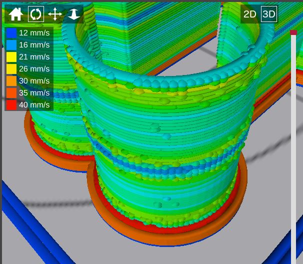

After spending many hours.  (MANY)
Tuning, fine tuning, tuning again.... I had gotten mattercontrol to work extremely well on my rostock max v2.
However, about a week or so ago I got a prompt from within the mattercontrol GUI that an update was available. So I blindly ran update.  This turned out to be a devastating mistake!!!  The update wiped out every one of the settings I had painstakingly developed.  It is now a week later and I do have printer somewhat back in shape the prints are still a mess.  retraction not working correctly, I have pitting throughout.  To say the least I am not a happy camper. I put in a service request to mattercontrol.  They have yet to respond.  This is adding insult to injury.
1. Has this happened to others recently?
2. Is there a suitable replacement to mattercontrol that is comparable in functionality?
Thanks all/any for your input

I am also having problems with MatterControl since the update.  I have a Rostock Max V2 with the upgraded HE280 hotend.  I had to remove it and go back to 1.5.  Unfortunately, for some reason I thought a bugfix had come out so I reinstalled today after a weekend of really good prints only to find everything going horribly wrong after the upgrade back to 1.6.
One of the problems I have seen is that MatterControl turns off the heater in the hotend, as well as the bed, which makes for terrible problems and failed prints.
I also had an issue where my prints came out really "spongy" as if the perimeter of the object did not print (only the infill). I hope they can get this resolved.

I agree, something is quite off after the update.  I think it is in the slicer (Matterslice) not MaterControl as I can change to a different slicer engine and it doesn't give me these results.  This is a part which is 0.4mm thick thus should print with one perimeter all the way around yet since the update it is printing all these bumps all over the place causing a ton of moves which just make the part look horrible.
