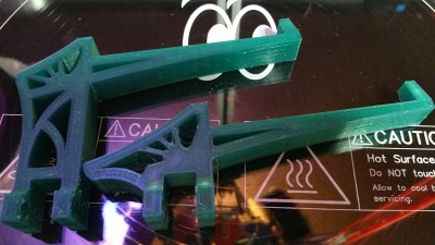

I'm not convinced that the segmentless calculation actually does anything you can measure in a side-by-side comparison, and I say this because that's exactly what I did. These two pieces were printed on a Duet 0.8 (segmentless) and a Smoothieboard (200 segs/sec). Can you tell which was printed on which? At some point, the resolution limit on the stepper motors will eat any gains you might get from segmentless calculation. The printer these were made on has 0.9-degree steppers.
I would consider upgrading to 0.9-degree motors with AstroSyn dampers first, before changing out the controller, if you want to reduce the waviness. I DON'T have any side-by-side photos of parts printed with 1.8 and 0.9 degree steppers, so I can't prove it directly, but the logic is sound: if the steppers have twice the resolution, the controller will be able to draw smoother lines with them.
