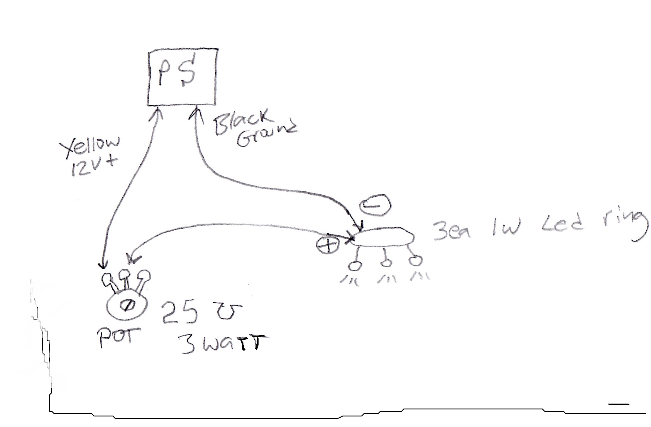

I bought a bag of 1 w led lights and a 25 ohm potentiometer. Can you guys verify my wire diagram for me?
I was going to use a yellow 12w and ground from the p/s...
Is the 25 ohm pot the right choice for these?
See attachemnt...

wiring looks right bill, but you may want to add another fixed 8 ohm resistor (minimum) before the pot, so you dont blow out the leds, when the pot it at its lowest setting.
also you may want to get a larger pot, so you have more range of brightness/dimness adjustment.
I have a 50ohm pot plus a 10ohm fixed, for a total of 60ohms, and its still pretty bright at 60 ohms.

yes that's fine, i got mine from mouser, let me find the part number. this is what i used but If I had to do it again, I would get something a little higher resistance so could dim the led more.

As you can tell, I'm not an electrician, if the 3 bulbs are 1 watt each, does that mean that the resistor and the pot can be no more than 3 watts?

means it shouldn't be any less than 3 watts in our situation because the resistors need to dissipate minimum of 3 watts. If you get a higher watt rating, it just helps in my opinion, it wont run as hot, and maybe prolong the life of the resistors.

as far as resistance, wattage is dissipated as heat in resistors, so if you have a 3 watt resistor your pretty much at the limits of that resistor.
the pot doesn't determine how many watts your led will receive. That's just want its rated for (ie it will dissipate up the rated amount). Just because the pot resistor is 5 watts doesn't mean that is what your leds will be receiving.
changing the resistance of the pot is what makes the led bright or dim,

So if I have 3 1 watt leds wired up in series I should not let more that 3 watt come into the leds? if so, then I should look for a resistor and pot to be rated at no more than 3 watt?

no your misunderstanding, the 3 watts is all that your circuit will use. you wont be adding more wattage unless you add more leds.
