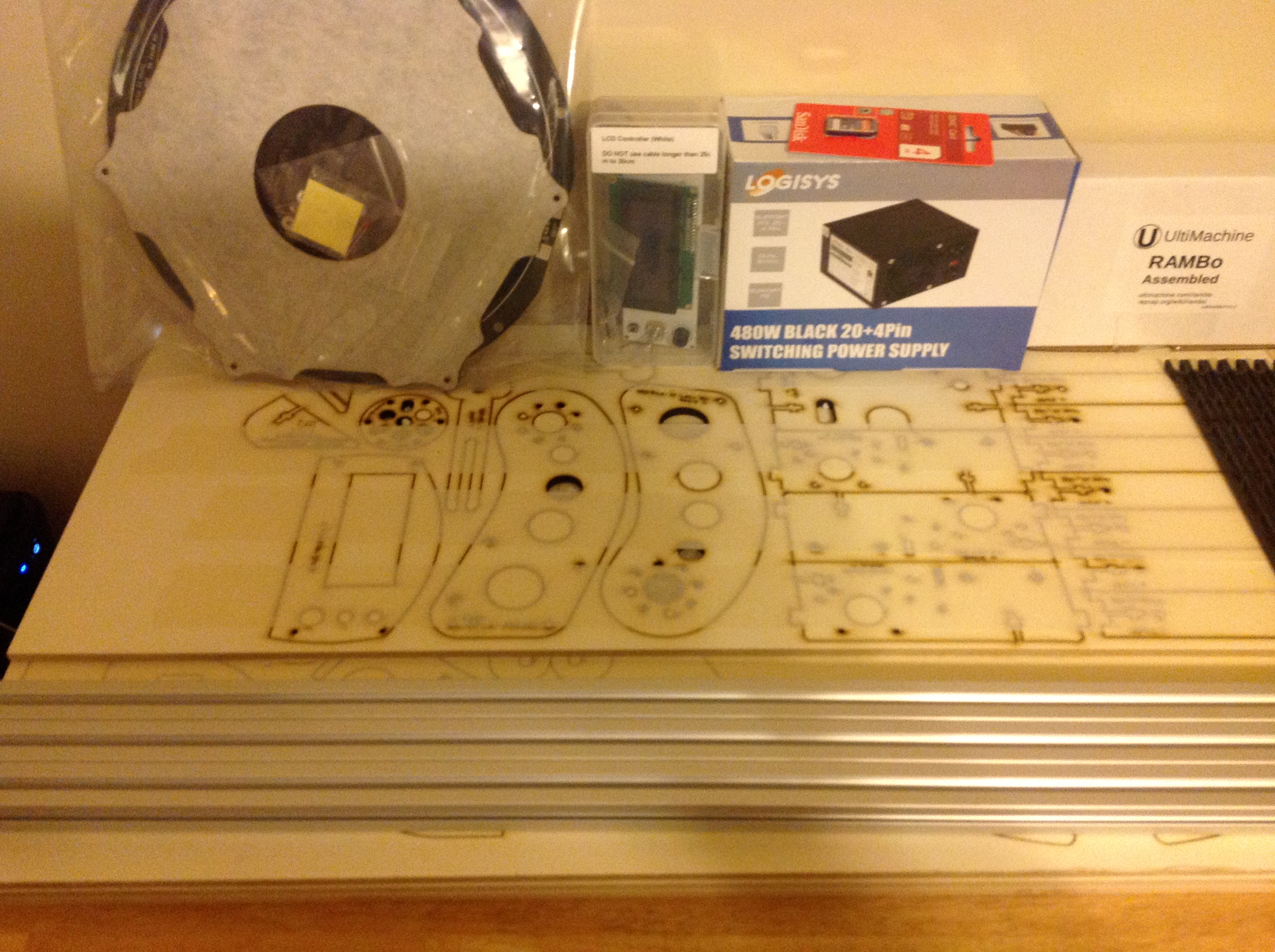

I started my build over the weekend. This is probably the most difficult thing I've ever tried to build - and I call it difficult due to my inexperience, not for any other reason.

Re: A n00b builds a Rostock Max
Thanks for the great pictures. I am confused, in your first pictures your top piece for the base says "Rostock Max"
printed on it then in your later pictures with the base built I no longer see the printing. What's up with that?
If you click for the full image you can see it along what is the left edge. Thanks for making me panic and worry that I'd somehow put it on upside down or something!Eaglezsoar wrote:Thanks for the great pictures. I am confused, in your first pictures your top piece for the base says "Rostock Max"
Yea, it's the picture that shows the doors open where I don't see it. Glad to see it's okay, just trying to be sure there was
no problems before you got too far along. Sorry for the panic attack but you need your heart too pump fast now and then.
Looking forward to the rest of your build.

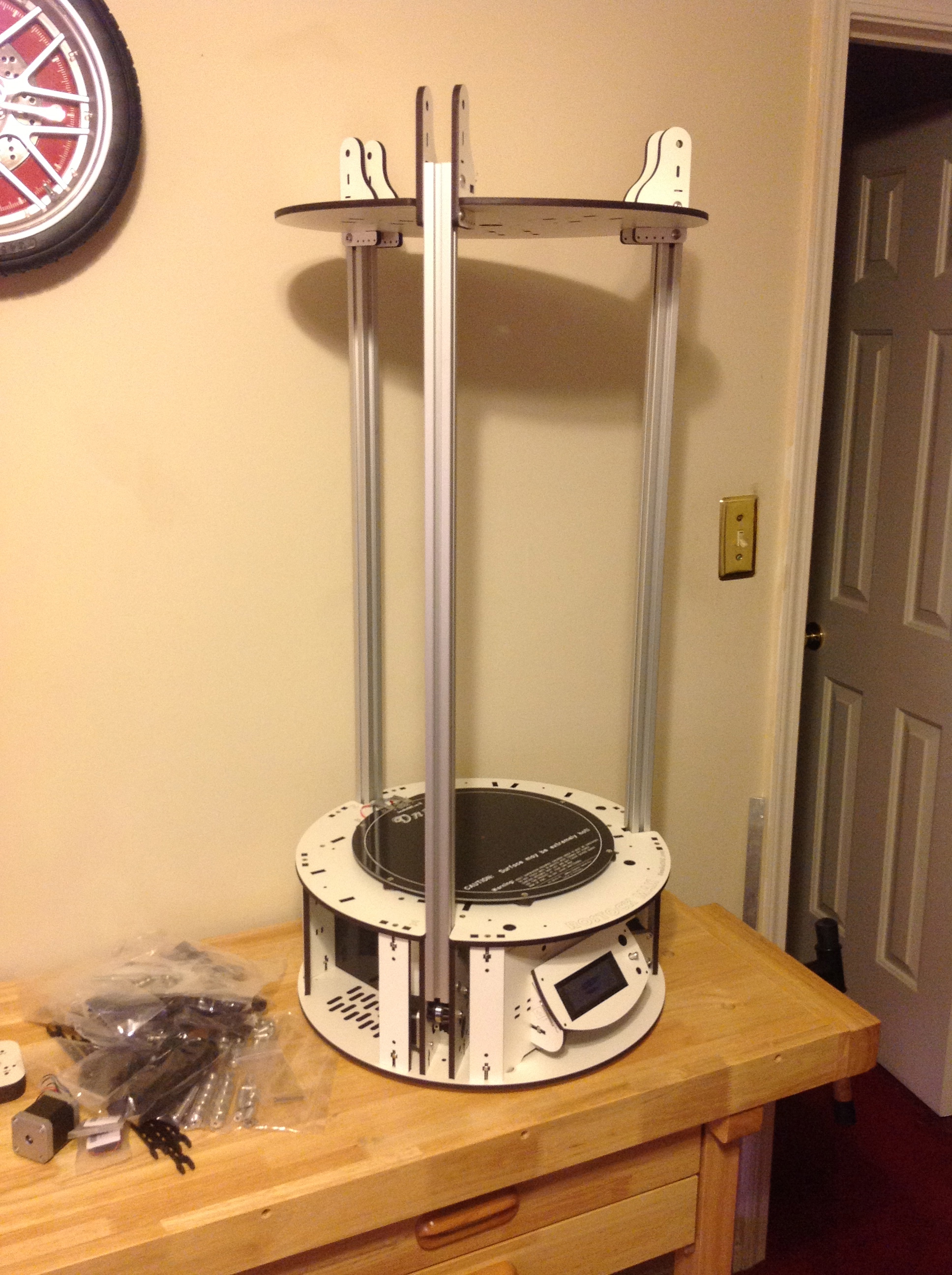

Continuing..
Got the extruder put together, the arms and carriage done, and the cheapskates. Now I'm fishing wire down the rails for the limit switches.

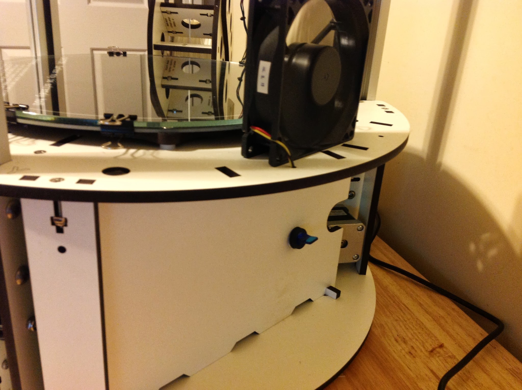

While waiting for my new hotend to arrive (and printing some parts with my semi-functional stock hotend) I decided to make a couple of small modifications to my Max.
First I added a fan to the electronics bay. I couldn't figure out a way to mount it anywhere other than where I did without needing to doing some additional cutting and drilling which I was trying to avoid. So I mounted it to the door and it pulls air through the opening under the LCD controller. Works really well actually. The fan is wired straight to the PSU so when the unit is turned on the fan comes on. When I mounted the RAMBO I had added some heatsinks on the back of the board where the stepper motor connections are and added some standoffs so I get good airflow all around the board.
Second I added a switch to my parts fan so I can turn it on and off as necessary when printing PLA. Initially I had it wired to run continuously and manually rotated it so it wouldn't blow on the bed when I didn't want it to. I mounted the switch on the second bay door.
Next up is to add the belt tensioners that I've been (slowly) printing - I hope to get all that done before my E3D head arrives in a couple of weeks. I also plan to add an LED illumination ring to the carriage.

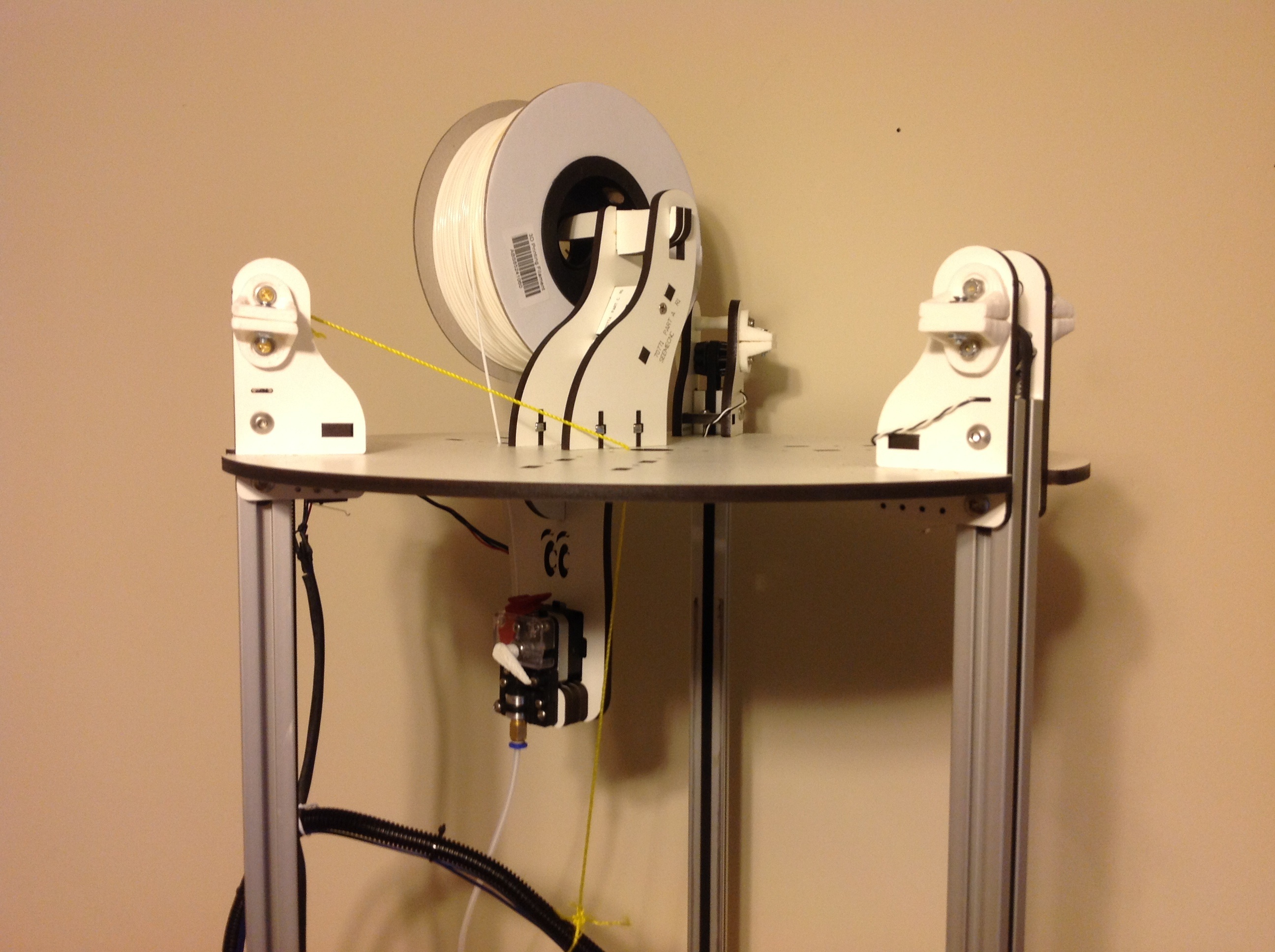

I added the EZ-Struder and the top mount. I really need to find a better way to route these wires.
Man, those leds would blind you if you stared into them.
Great job in getting this far and thanks for the pictures, this
is the first time that I've seen the Seemecnc top mounted spool holder.
I wonder why they didn't put the spool between the uprights instead of
hanging it off the side. Hey, it works and looks good who am I too judge.
Thanks for all the pictures, I have been following along and enjoy reading
your posts. Neat use of the mason's line to hold the wires.
Thanks guys.
Yes, those LEDs are really bright!
I'm sure it's around somewhere but I couldn't find an assembly guide for the top mount anywhere so all I had to go by was the photo on the page where you order the mount. For all I know I put it together wrong, lol. But it works just fine. I'm still considering shortening the bowden tube a bit. I really want to run all the wires from the hoted up through the center hole on the top plate and then down over the side - but I'd need to extend all the wires and I really don't like the thought of doing that at this point.
I also realized that I can have two extruders now if I wanted to, I still have the original Steve's extruder and the side mount of course and soon I'll have an extra hotend..hmm.
