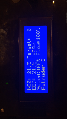

I recently just upgraded to a dual E3D system (Chimera) on my Rostock MAx V2. Both hotends work, in addition to the fans. I can also move the EZStruder with the stock stepper motor. When I upgraded, I bought an EZRStruder and a cheap stepper motor from Amazon, which is plugged into E1 on the Rambo. However, when I attempt to select it with T1, the printer freezes up. The display shows "Extruder 2" on the bottom. I cannot send G-Code or use the rotary encoder. After one second (the watchdog), the fan turns off on the hotend, but it does not reset. I have to manually power cycle it. I am not sure of the ideal current for the motor, but the first review is of someone using it on the same printer without modification. Right now, I am using 130 as my MOTOR_CURRENT value, so about 0.65A @ 12V. Here is my configuration.h (removed other printers for space):

An update on this: I tried some changes in the firmware. Whenever the second extruder is selected, whether on the screen or in software, it seems fine for a few moments. Then, it crashes. RAM is not the problem. I think that I have narrowed it down to one thing: the watchdog. It seems as if the temperature loop does not execute after selecting the second extruder. I will have to try and fix it.
lights0123
Noob
Posts: 4
Joined: Sun Dec 04, 2016 8:39 pm
Re: Printer freezing when selecting second extruder
Post by lights0123 »
More updates: when I select Extruder 1 (reselecting 0 does not break anything) on the printer, it does not freeze, but it cuts out serial communication. When I send T1 (again, not T0), it will sometimes freeze, but it also cuts out serial. Also, when sending T1, the screen will display random characters in some locations, then become normal again. A firmware mod that I made caused this, although I am not sure why. I am using the firmware at https://github.com/seemecnc/Firmware, with a date of 20161123.
lights0123
Noob
Posts: 4
Interesting... I just updated the the latest version, and it fixed it. I probably screwed up a configuration somewhere, and when I updated it, I didn't make the same mistake.
