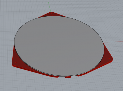

Nice products Rocket! I'll keep my eye on your shop, probably something I'll want some time.
I've actually designed a much better mount system for the MetalMAX and V3 printers for FSRs. Brian at TrickLaser cut them for me in melamine. I have a couple of tweaks I want to do but I think there might be interest in them.

Thanks!Nice products Rocket! I'll keep my eye on your shop, probably something I'll want some time.
That mount looks nice, but I still can't decide between something like dc42s IR sensor or the FSRs. Leaning towards the FSRs because they seem to offer the most future-proof solution in terms of compatibility with different beds and hot ends.
