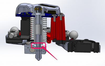

Extrusion problems with your HE280 equipped printer? READ ME!
I've been told by SeeMeCNC that they're seeing a 100% success rate with this solution.
https://seemecnc.zendesk.com/hc/en-us/a ... lament-JAM

Using this method, I have hopefully solved the seating issue with my bowden tube. Is there a way to tell that the problem is solved without taking it back off?
That is, what are the symptoms that point at an improperly seated bowden tube?
Thanks.
Thanks.
Re: Extrusion problems with your HE280 equipped printer? READ ME!
You'll see poor flow rates or the EZR will start skipping or chewing on filament.
In case anyone has tried the solution at the top of the thread several times without success, I got the advice below from the awesome support desk, and it worked:
"I do feel that this reduced extrusion rate is being caused by the PTFE tube not being seated in the hot end all the way. It may feel like it is getting seated, but what I believe is happening is that there is filament melted and creating a blockage at the location indicated in the image below:
So, the key is going to be to get that filament out. One option is a cold pull:
Heat the hot end to 215. Take a piece of scrap filament and manually push it through the bowden tube / hot end. You should be able to get the filament to pass through and extrude out the nozzle some. If not, there is an obstruction in your hot end. Leave the filament in the hot end, turn the heat off and let the hot end cool. When the temperature reaches 100C pull the PTFE out of the hot end, but leave the filament in the hot end. When the temperature reaches 88C pull the filament straight out of the hot end. This will hopefully pull any blockage out of the hot end.
You may need to repeat this process.
When the blockage is removed, you will need to re-seat the PTFE again in the hot end using the method described in the manual."
