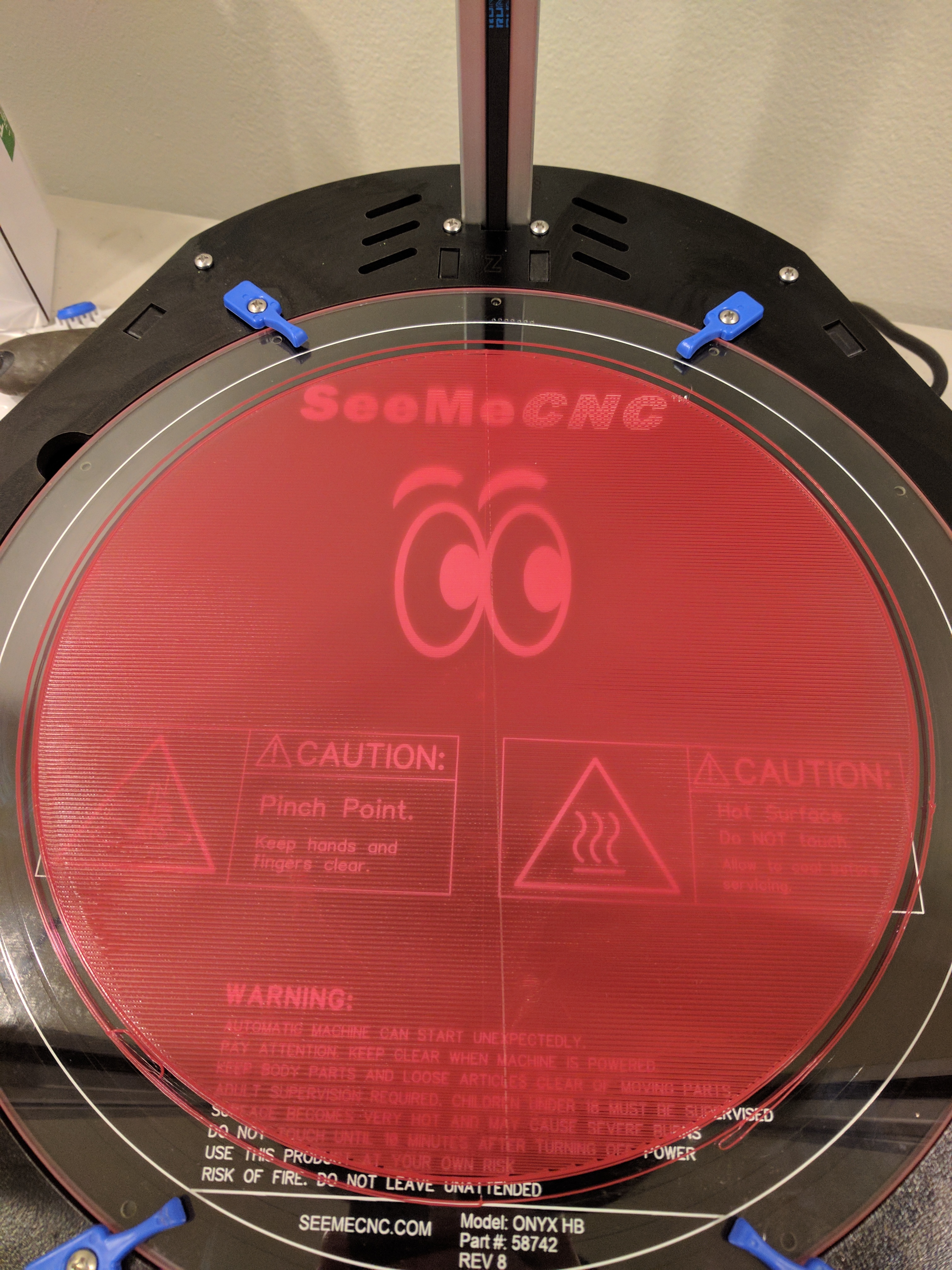

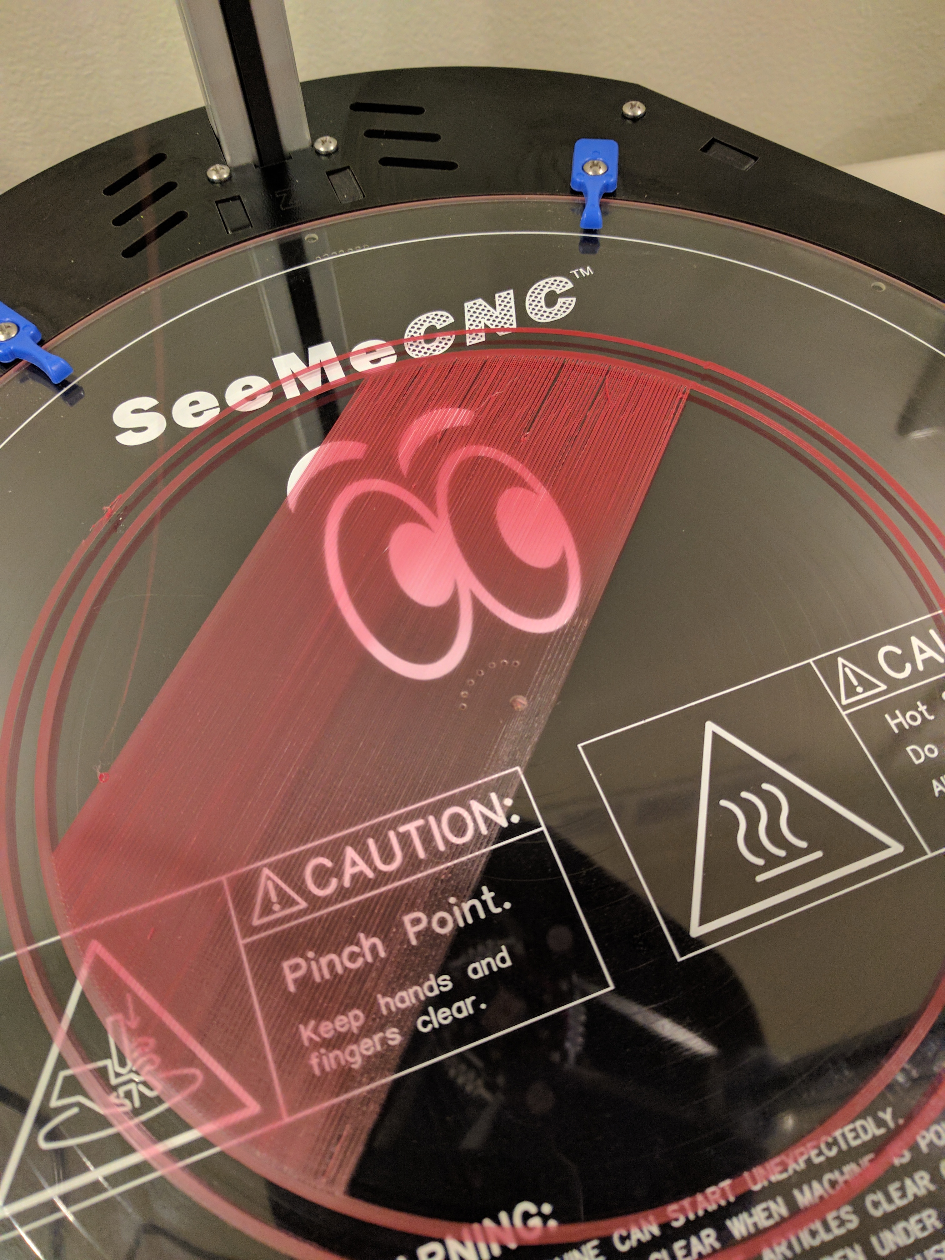

TL;DR Clicking extruder and I think I am missing something here on calibrating the z-height all around the bed, not just the center.
Current Setup:
Rostock Max v3
.5mm Stainless Nozzle
Firmware 20170201 (Edit: I totally dislexed the firmware version)
Cura 2.31 with varying initial heights of .08, .1, .15, .2, .25.
Varying Print Speeds from 40mm/s up to 100mm/s
Varying hot end temps, 170, 175, 180, 190, 200, 205, 210, 220, 230
With multiple PLA brands: Hatchbox, Monoprice, MG Chemicals.
Up until now, I have just been printing small things. My first attempt at something over a few inches wide was a disaster and continues to be. I have been tweaking and printing the last few days with minimal change in my results. The middle seems to be just right (maybe even a little thin), and the further out from center I get, the higher the nozzle is. I also get clicking from the extruder during the first few layers to the point where I had to take it apart and clean it out from all the chewed up filament. Which I figured was either a temperature issue, the ptfe issue noted below, or a z height issue. (Not that I can find.)
http://forum.seemecnc.com/viewtopic.php?f=36&t=7361
I have read through that post multiple times trying to figure out what I am missing.
And I also have followed the recommendation here: https://seemecnc.zendesk.com/hc/en-us/a ... lament-JAM
I have ran the advanced calibration a few times and am within .05
I have manually adjusted my z height to around .08 as the auto calibration always sets it way to low. (Used a piece of paper that measured .08 on my caliper until it just barely dragged.)
I have attempted printing this disc so many times I have lost count, the results are always similar to the picture below. The center still appears to be thin, but if I raise the z-height anymore it doesn't lay properly at all. And the further outside of center the higher the z height appears to become.
Here's what the 2mm tall disc print from the strategy thread looks like.

Have you tried adjusting your probe offset? Also try updating your firmware to the dev branch.

Looks like your horizontal radius is wrong.  That controls the amount the edge height differs than the center height.  Then it also looks like there is a slight tilt.  But get that horizontal radius fixed first.

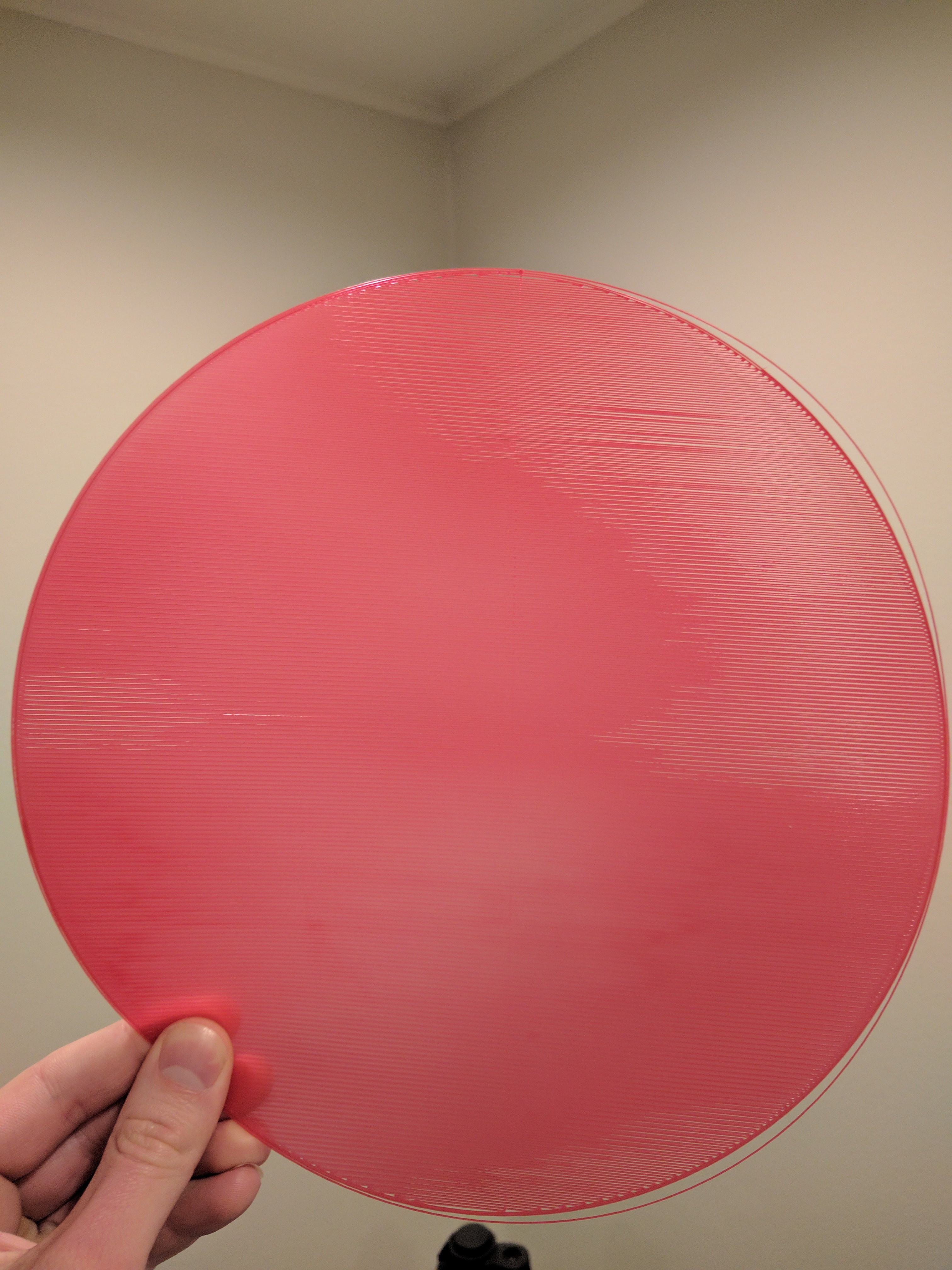

I went out and bought a feeler gauge.
I performed the procedure in the V2 manual Appendix B. I got it perfect. Just barely dragging at all 4 points. I tweaked the horizontal rod radius to be as perfect as possible.
The auto calibrate in all respects was close, but not close enough for a good first layer. Not even with the refinement page I linked a few posts back.
I don't have much of any clicking anymore and the first layer is going down fairly even, but there are some rows that aren't adhering to each other. Mainly in the upper right. What else should I be looking at to try and resolve this?

Looking at the photos I have to ask if the print is perfectly round? It seems off centre on the bed? Or is it oval in shape? The picture maybe skewing it a bit?
						Re: Rostock Max V3 Really having a hard time getting my first layer down
Yes, it is perfectly round. Yes, it is fairly centered on the bed (maybe up a mm or two). Lots of lens perspective/distortion going on with the camera (fun article on the subject http://gizmodo.com/5857279/this-is-how- ... retty-face). It's impossible to get dimension accurate macro shots without a nice camera/lense.
I am so close to figuring it out. Turns out the "Auto Calibrate" doesn't do the full job. No matter how many times I did it coupled with the delta guide, I never got a good first layer.
THIS was the magic: http://forum.seemecnc.com/viewtopic.php?f=77&t=5906
Use with a 20mm feeler gauge. After three goes, it was perfect.
I also had to play with my PLA temp to stop the clicking. Turns out the PLA I have HAS to extrude at 225C to extrude cleanly.
