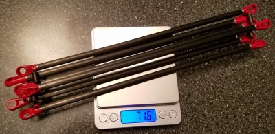

Custom Ball-cup rod ends now available for order,
Retro-fit kit to convert your existing Trick Laser CF arms to ball-cup ends
http://www.tricklaser.com/Ball-Cup-Rod- ... -RETRO.htm
Complete 300mm carbon fiber tube arm sets with the new ball-cup rod ends.
http://www.tricklaser.com/Carbon-Fiber- ... -BC300.htm
These Ball-cup rod ends are designed by us, specifically for delta printers. We have the ends precision injection molded exclusively for us. They are made from super strong and stiff glass fiber reinforced PBT plastic.
Also aluminum platforms for ball joints
http://www.tricklaser.com/Aluminum-plat ... ALU-BJ.htm
And soon to be released Trick Truck X Mini Carriages for ball joints.
http://www.tricklaser.com/Trick-Truck-X ... -XMINI.htm

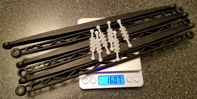

Super stiff and lighter than stock plastic arms !

Just got Retro-fit kit, and found out that I'm unable to unscrew anything from CF arms, hand slips and nothing moves. Tried to gently twist back and forth to loosen, no luck :( Any advices?

Renha wrote:hmmm, other CF arms I have (shorter ones, about 271mm) has been unscrewed succesfully... but I need another ones to be upgraded (~326mm)
The aluminum insert in Cf tube has a 8-32 threaded set screw in it, the set screw has thread lock compound on them so they may turn hard, but should be possible to unscrew them. The threads are standard right hand, so turn counter clockwise to remove.
The Traxxas rod ends sometimes unscrew from set screw first, in that case you need to grab onto setscrew with locking pliers to remove.
i do not advise using pliers on CF tube, it crushes very easily.
