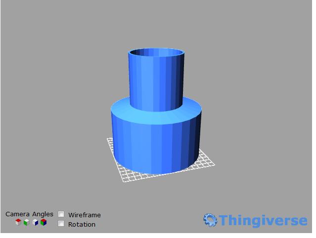

i'm 4hrs into a 16hr print, looks good so far.
can anyone guess what this might be? I'll send you a free led heatsink mount for the winner.. links here http://forum.seemecnc.com/viewtopic.php ... &start=270 or here http://forum.seemecnc.com/viewtopic.php ... =260#p9718

alright, it is a 4 to 2.5 inch dust collector adapter, but unfortunately i had to stop the print so it didn't get finished,
this is what it was supposed to look like. it failed to make descent enough bridges to create the transition to the smaller diameter hose. im gonna have to change some settings and try again later.

If you're not restricted for some reason, instead of a flat transition do it at 45 deg angle so you don't need any support material. Or am i missing something?

yeah i'll try that, it only had about a 5 degree angle to it. sucks though, it was looking good..lol
10hours of print wasted..=/
