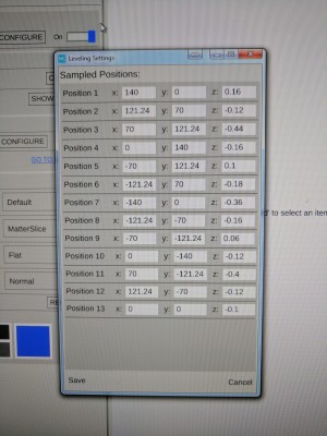

ohh still have bed tilt (deltacallibration plugin for octoprint) :( can prints small parts but failure on large part:( how i can solve this problem?
in MC after 13points software callibration i can print perfect 280mm callibration ring but not with Deltacallibration plugin :(
here my results after software 13point calibration 0.1 paper
anyone can help me ?

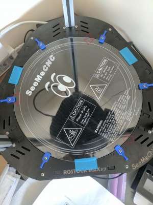

Post by martins »
yes sure please i can do everything to get it sorted i use PETG 233 extruder and 65 bed temp
now moved a bed clockwise 1 point and make again deltacalibration manualy
and got
Success! Calibrated 7 factors using 10 points, deviation before 0.06 after 0.02
but still ring callibration fail :(
photo show where is 3 points thats filament not stick to bed (All screws tightened)
again manual callibration

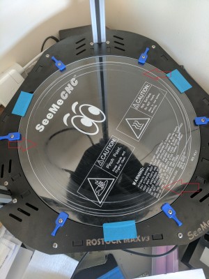

same points as on the pics up no stick , im going crazy
printed from SD same resoults
now conected back to octoprint and run deltacalibration plugin on
Calibration Result: Calibrated 6 factors using 10 points, deviation before 0.07 after, 0.03
octoprint same results always this 3 points not stick to
bed where deltacalibration is not sensing thish points

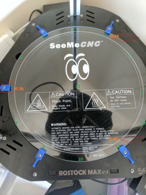

is no matter what slicer i use first photos is mattercontrol 1.6 second and 3 is Simplify3d
now where is this 3 red arrow i put under the bed (this mounting points ) 2 layest off blue tape
run octoprint delta plugin and got
Calibration Result: Calibrated 6 factors using 10 points, deviation before 0.06 after, 0.02
printing now
still same the arrow points not stick to bed

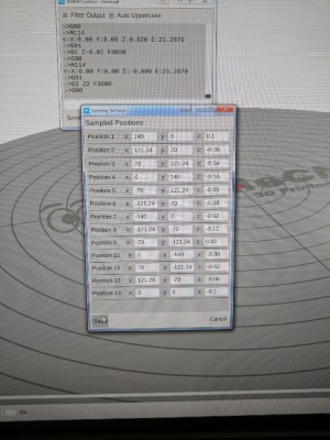

can someone explain me why i got something like this
doing deltacallibration i get
Calibration Result: Calibrated 6 factors using 10 points, deviation before 0.04 after, 0.01
where should be perfectly but is not
on points 3 ,7 ,11 filament don't stick to bed (on this points delta don't run sense)
after manual callibration MC 13 points., points 3 ,7, 11 looks like they are far lower than other points
here a MC 13 point callibration
WHERE look to find this hardware issue

When I was using Octoprint, I only did G29 and Delta Cal Wizard, but still used Octoprint web interface. Also try using just three alternating bed clamps to avoid inducing more warping in between axis. Those pics seem like it was too close rather than up in the air.

have tryed 3 clamps only and 3 oposite no change
delta calibrating to 2 4 6 8 12 then 4 in the midle 8 in the midle and 12 in the midle and center 13
around this points is nice surface but on points 3,7,11 i have hole in bed:)
