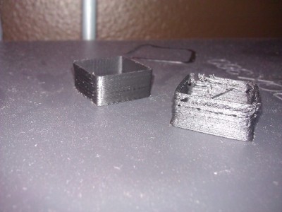

So, I've been having a hell of a time calibrating my Rostock MAX. Everything is a learning process. Part of my trouble is that I don't know what to look for. Help me help the community. With this thread let's list all the symptoms of common problems.

My 4-walled square pieces are thinner in the middle, wider at the top and bottom. I have no idea what that means.
I just printed out these pieces, I have no idea what I'm looking at.

I believe the hotends ship with a standard .5 nozzle. This is the number you want you to put into whichever flavor of slicer you are using. Not sure what happens if you have something in there that is incorrect, although I can imagine everything from overpressure nozzle destruction to really crappy filament lacking prints.
ABS runs well from 220-240 degrees or so. You should check your hot end temp with a known good temp sensor to verify that you are in that range. To cold and you'll strip your filament in the extruder, to hot and you could melt the PEEK insulator in your hotend.
If you are running ABS without ABS juice 60 degrees is to cold IMHO. The goal of heating the bed, among other things, is to help the first layer stick to the bed. If your not having problems with that, I would leave it alone for the time being.
The "rotted" cube looks starved for filament. Polygonhell has an excellent extruder calibration post stickied around here somewhere. Find that and follow his instructions. Without knowing exactly what you are extruding and being confident that every rotation of the extruder equals a certain amount of plastic being deposited you'll beat yourself silly chasing down issues.
Usually, my order of calibration for a new printer is, extruder, mechs, then tweaking the motion. I calibrate the extruder/nozzle/temps, sort out any mechanical issues effecting print quality, and then worry about the subtle issues that can screw a print (sticky motion, backlash, uneven temps, fans).

Actually, from what understand, your extrusion widths and nozzle size should be 10% larger than the actual physical size - so you should enter 0.55 for the nozzle size. Incorrect settings will change your single wall thickness - if you set your nozzle too large (or let Slic3r guess automatically) - you'll get really thick walls (I measured almost 0.94mm on my first single wall print test!)
You really need to test your hotend temperature with an external thermocoupler to determine how far off the real temperature is from the temperature reported by the thermistor, and adjust accordingly. I have found that when your temperature is too low, your single-wall prints will 'crack' as the plastic cools (sometimes hours after the print is completed I'll hear a loud CRACK). Increasing temperature by 5C when you see cracking helps. If you have the temperature too high, especially with PLA, you'll have issues with the PLA jamming up and not extruding.
60 is way too low for ABS printing. I suggest you check your wiring, or add an extra set of wires to the power input for the hotbed, or between the Rambo and the bed (more wires means more juice can flow to the bed) - the onyx is a huge bed, by comparison, my work's Makerbot Replicator bed is only 9x6"! I suggest throwing a towel over your onyx and pre-heat manually to 80c before starting a print (i pre-heat to 80, hit print, and quickly remove towel, works great). 60C is what I use for printing PLA
Your single walls are thinner in the middle because not enough plastic is flowing - you probably have the wrong extrusion width settings, OR your steps per mm on the extruder is incorrect (depending on what board version you've got).
I personally went out and bought a 1" micrometer purely for the purpose of accurately measuring my single wall thicknesses to calibrate my prints (since I have 3 3D printers, i figured it was time to finally get one).
I've personally found it's extremely important to eliminate as many hardware related bugs as possible first before even attempting to calibrate, because trust me, configuring the slicing software is an artform itself. Even a few small changes to the slicer profile can have a major impact in print quality.

The holes on the walls are indicative of inconsistent filament feed, most likely the filament is slipping in the extruder, possibly after a retract, hard to tell without watching the print.
If you haven't already you should turn off retract/resume and get everything else dialed in first, then you can play with it and know what it's responsible for.
The other thing to do is start slow and increase the speed when you get decent prints again to be able to trace issue to a cause.
The general approach is start as simple as possible, resolve the invariable mechanical/settings issues then change one thing at a time.

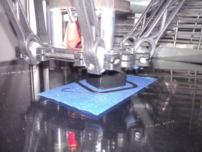

What causes edges to curl and be misformed like this...
Re: SYMPTOMS
To hot, too fast, not enough cooling.untitled86 wrote:What causes edges to curl and be misformed like this...
The single walled test print take very little time per layer, it can easily be less than the time for the layer to cool below the plastic transition temperature.
If your worried about it try printing 4 at the same time, or run a bigger fan on the part.

No, I meant add an extra pair of wires to the Onyx hotbed. Your hotend should be sufficient with only 1 pair of wires. The onyx takes a LOT of juice to heat up to 80C - adding an extra set of wires to it will allow it to heat up faster (note, you may need to add another yellow and black pair of wires from the power supply to the hotbed power input)So, add another set of wires to the Hot End 2 plug? Do I simply mate up the positive and negative wires?
I know you're trying to create a single thread for all problems and how to fix them - but trust me, there's just too many to fit into 1 thread. The same problem can be caused by 10 or 20 factors. It's tough to say here's the problem, and here's the fix.
Getting the plastic to 'stick' to the bed is only one part of the equation (I'm a big fan of Blue tape as well). In order to keep it 'stuck' to the build surface throughout the temp, you need to make sure you have a hot enough bed. For PLA, I have the bed around 50 or 60c, for ABS, I start with 75C for the first layer, and set it to 80C for all other layers (faster heatup times for my setup).
FYI - the point of the fan is to blow air onto the middle of the hotend (cooling the middle just enough so heat doesn't creep up and melt the filament before it enters the nozzle). This is important for printing with PLA.
