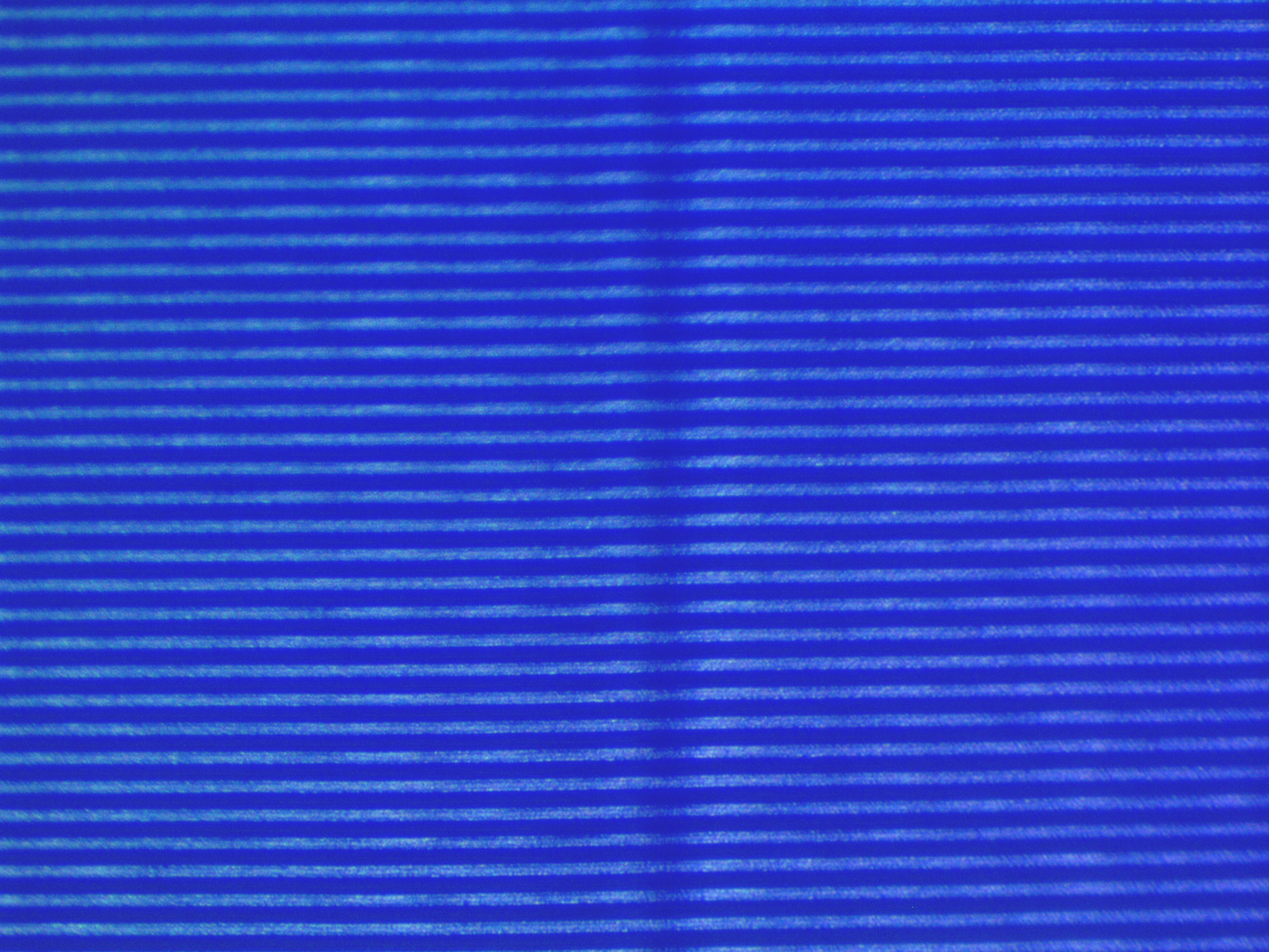

I'll play. I've always had a light amount vertical banding on my Rostock Max and it has always irritated me (one of the top 5 reasons I'm designing a new printer right now). If changing something simple would improve this I would be ecstatic in the mean time.
As for my machine, I'm running a Rostock Max V1 on the original 1.8-deg steppers, extruder, Rambo 1.1b and Repetier 0.91 firmware (16x microstepping). Modifications include carbon arms w/ traxxas rod ends, E3D hotend with 0.4mm nozzle, and trick laser "trick trucks" carriages.
I printed the part out of ABS so I changed the gcode to 90C bed and 245C nozzle temps. I also added a G28 to the beginning of the code and changed the first move to "G1 X0 Y0 Z5 F10000". Otherwise the gcode is the same as in your other thread.
[img]https://c1.staticflickr.com/3/2947/3302 ... 9ed5_h.jpg[/img]
[img]https://c2.staticflickr.com/4/3837/3386 ... a52a_h.jpg[/img]

Re: Effects of microstepping and segmentation on print qualty
I've been doing a LOT of experimentation on this issue.
I'm convinced that the vertical lines you see here are not segments, but rather, stepping artefacts from the A4988 driver.
0110-m-p, can you try slicing the attached file in spiral vase mode, no need for top or bottom shells, with a layer height of 0.1618, and see if you still get banding? I'm assuming that your current steps/mm value is 80. Here is the result of some experiments I've been doing on this, the only change between these cubes is the layer height. I think these ridges are to do with decay mode in the drivers. Setting the layer height to a multiple of the golden ratio (once you figure out how much distance a full step takes) spreads the peaks out enough that they stop being visible. Segments are very hard to observe, however I believe that these vertical lines are due to segments. Note that the segments don't always line up as you travel up the face of the cube.

I used to set my steps/mm according to what the caliper told me, but recently when looking at this issue I've discovered that you can get moire effects. Mine was set to 161 steps/mm, when the calculations say 160.0110-m-p wrote:Interesting. My steps per mm is actually set at 80.7. I calibrated that with a dial indicator (modified it until a Z axis move command equaled the change in reading on the dial).
How did you come up with the 0.1618 layer height?
The 0.1618 layer height is calculated as follows:
80 usteps/mm = 5 steps/mm (at 1/16 microstepping)
= 1 step / 0.2mm
Golden ratio * step size = 1.618 * 0.2mm
= 0.3236
Halve this to get a reasonable layer height:
= 0.1618 layer height.
The magic is in the golden ratio, it spreads out the single step peaks so that they don't line up with subsequent layers.
As you have 80.7 usteps/mm, the layer height you should use is:
0.1604 mm.
It's worth a try at least.

The pictures showing segments were taken on a RAMPS board running Repetier, with 400 step motors, using TMC2100 drivers in 1/16 interpolated to 256 uSteps. This was the only time that I was able to see segments. Using a 32 bit board made the segments disappear.
Here's the effect that changing the decay mode can have. Both prints were done on the 32 bit Re-Arm, with 400 step motors. The X and Y axis used SD6128 drivers set in fast decay at 640 steps/mm. The Z axis used an A4988 driver at 160 steps/mm. The only difference between these two prints was that the one at the top left has had the ROSC pin on that single A4988 driver shorted to ground. All other settings were the same.

Well it looks like my printer doesn't respond to layer thickness like yours does. Here is a print that is comprised of 3 different layer thicknesses. 0-18mm has 0.1604mm thick layers, 18-34mm has 0.1618mm thick layers, and 34-50mm has 0.15mm thick layers. The striping looks the same for all 3 layer settings.
Again this was ABS (hence the warping on such a big single wall part), speed was 40mm/s with 0.44mm extrusion width. Only big difference is this was a layer-by-layer print not spiral vase. Simplify3D can't do different printer settings per z-range in spiral vase mode.
[img]https://c1.staticflickr.com/3/2838/3305 ... b5af_h.jpg[/img]
