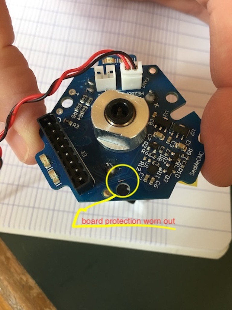

2- The second defect is located on the HE280 electronic board.
There again, vibrations have induced a board surface wear nearby one of the fixing screws causing the PS-ON circuit to short with the screw itself (Blue wiring, Item 8, Fig.2)
Fig. 2
Fig. 2
. In this case, the remedy was to apply the Kapton tape to isolate the damaged circuit board line from the screw (Fig.3 & 4)

Francesco
