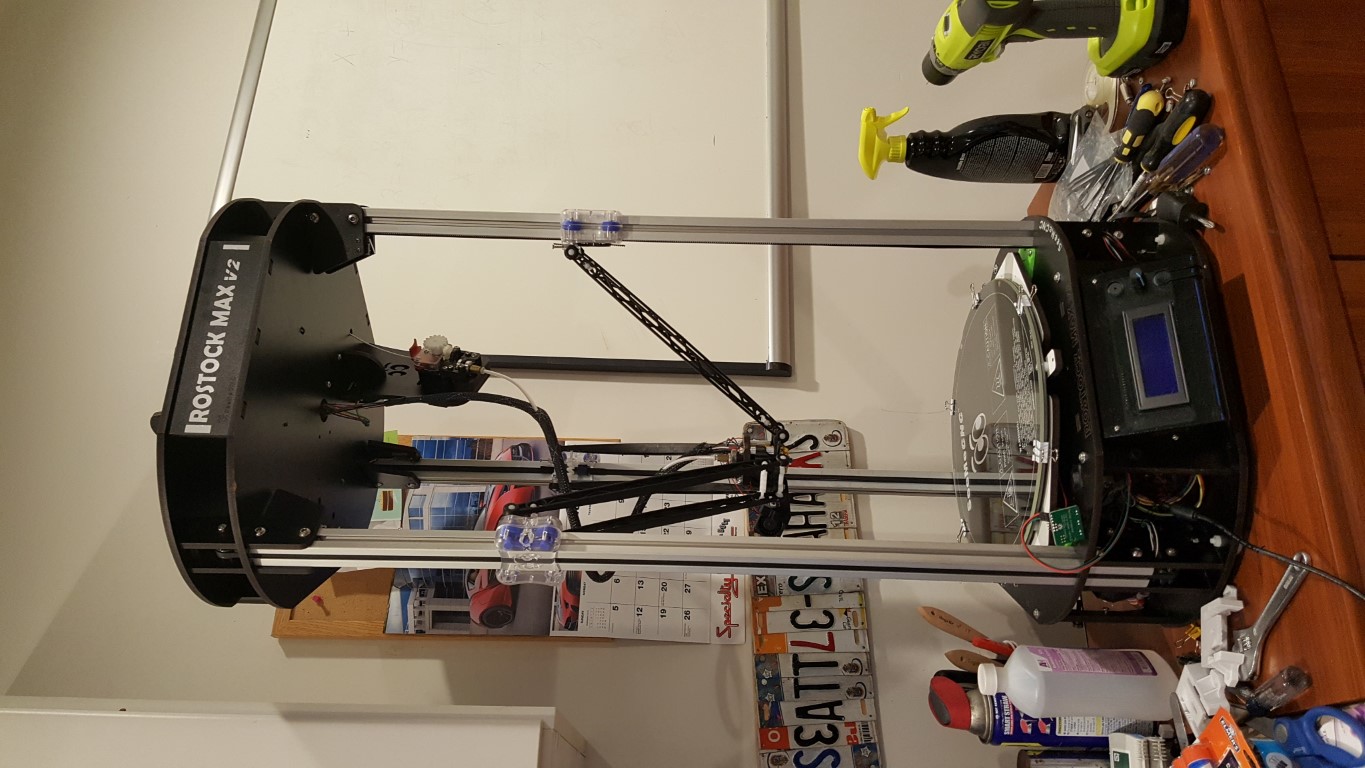

I have searched far and wide for a good write-up on getting the FSR setup to work. Unfortunately, there isn't one guide to follow, just pieces garnered from different posts. I get the basic idea of the FSR, and it seems like it would be simple to use. But at this point, I either don't have the correct rep firmware (I have tried building one through the online configurator with no luck, always loads, never works correctly), or the correct settings to enable the FSR's to work. I can calibrate and print manually just fine, so the machine is set up properly before I start on this new journey. Also, FSR is wired up correctly and LEDs on FSR board work properly. If anyone has a similar setup to me that could help out, it would be greatly appreciated.
if additional information on my setup is needed, please let me know.
Rostock Max v2
Rambo & atx
cheapskate + ball joint arm upgrade
Ultibot FSR kit with TrickLaser FSR board (wired into z-min endstop)
Mattercontrol or S3D (can use whatever)

I have been upgrading to FSR while still using Rambo myself. Although it worked (the probing itself) I found that it does not help a lot since Rambo does not do any calibration. In the meantime someone thought-up a plugin for Octoprint, but instead of going that route I bought an older Duet 0.6 board that still supports the current DC42 firmware completely. Now the FSR really come to value.
As far as I remember I based my setup fully on the mentioned thread. Also I upgraded tot a new(er) repetier firmware, but I believe SeeMe has a newer version now in their own branche. But Since I have a Duet I have not kept a lot of knowledge about the Rambo on my biological harddrive
I do remember however that I too had difficulty auto-setting Z Height. I ended up probing, calculate Z height and changing Z-max in the firmware by hand. So that was no real improvement over the paper-drag method. It did pay off though while calibrating endstops with a clever script. All in all the experience was frustrating enough for me to abandon Rambo and go for Duet. That is when the real improvent of FSR kicks in!

On RAMBo the issue IS NOT support for FSRs. With the JohnSL board, FSRs look exactly like a simple endstop switch probe. Exactly. So follow Repetier's guidelines for setting up an endstop probe.
The issue is the firmware support to actually use the probing data to calculate delta calibration parameters - aka autocalibration - exactly as DeltaCon describes. The SeeMeCNC Repetier branch only supports the accelerometer probe and is not nearly as sophisticated as the RepRapFirmware on Duet. The Octoprint plug in that uses the web interface version of the same delta autocalibration code as RepRapFirware also only supports the accelerometer probe as far as I know, I haven't actually checked it out but knowing how these things work it is a reasonable guess. Probing in Repetier has NOT improved significantly in 2 years. The 8 bit arduino controllers out there do not have the processing power or memory to do it right. Duet does. I also no longer recommend smoothie. It's support for autocalibration can not be enabled at the same time as networking (the web interface) or the LCD panel display so you constantly have to switch firmware to use one feature or the other due to memory limitations. This also has not changed in 2 years and an updated smoothie v2 is still out many many months. The other option will be the Ultimachine Archim - their 32 bit replacement for RAMBo. It has the same form factor and will run RepRapFirmware too so delta autocalibration will be excellent. I have an Archim to test. I don't know what the production schedule is but I assume later this year.

Yes, but I guess the question really is: can Rambo / repetier actually automatically set a correct Z-height (Z=0 with the nozzle touching the bed) with the help of FSR's (or any other Z-probe like you mentioned). I never succeeded in that, but must admit I was glad I didn't. It gave me reason for buying a Duetmhackney wrote:The issue is the firmware support to actually use the probing data to calculate delta calibration parameters - aka autocalibration
Re: FSR setup guide
It should be able to touch off Z=0. But, if that's all you want to do, why bother?

Thank you for the clarifications, it helps me not be too frustrated now. I was under the assumption that calibration has gotten better since that thread, hence the reason I was looking for newer information.
So at this point, I have a newer rep firmware configured, and it seems to be working finally (92.9 I think, not home right now to check). I found some values that were not configured properly, and fixing those has made the current firmware work like the old one. I am able to do the calibration commands like g29 g30 g31 etc...G30 works great and allows me to adjust the distance in firmware between the nozzle and bed much more accurately. Although when I use G29, it always returns error messages when it gets to the end. I seem to recall its something about a boundary issue. So my real question is, without a board upgrade, is there anything the FSRs are worth using for right now. If I decide to do a board upgrade, is the duet the best option at the moment.
