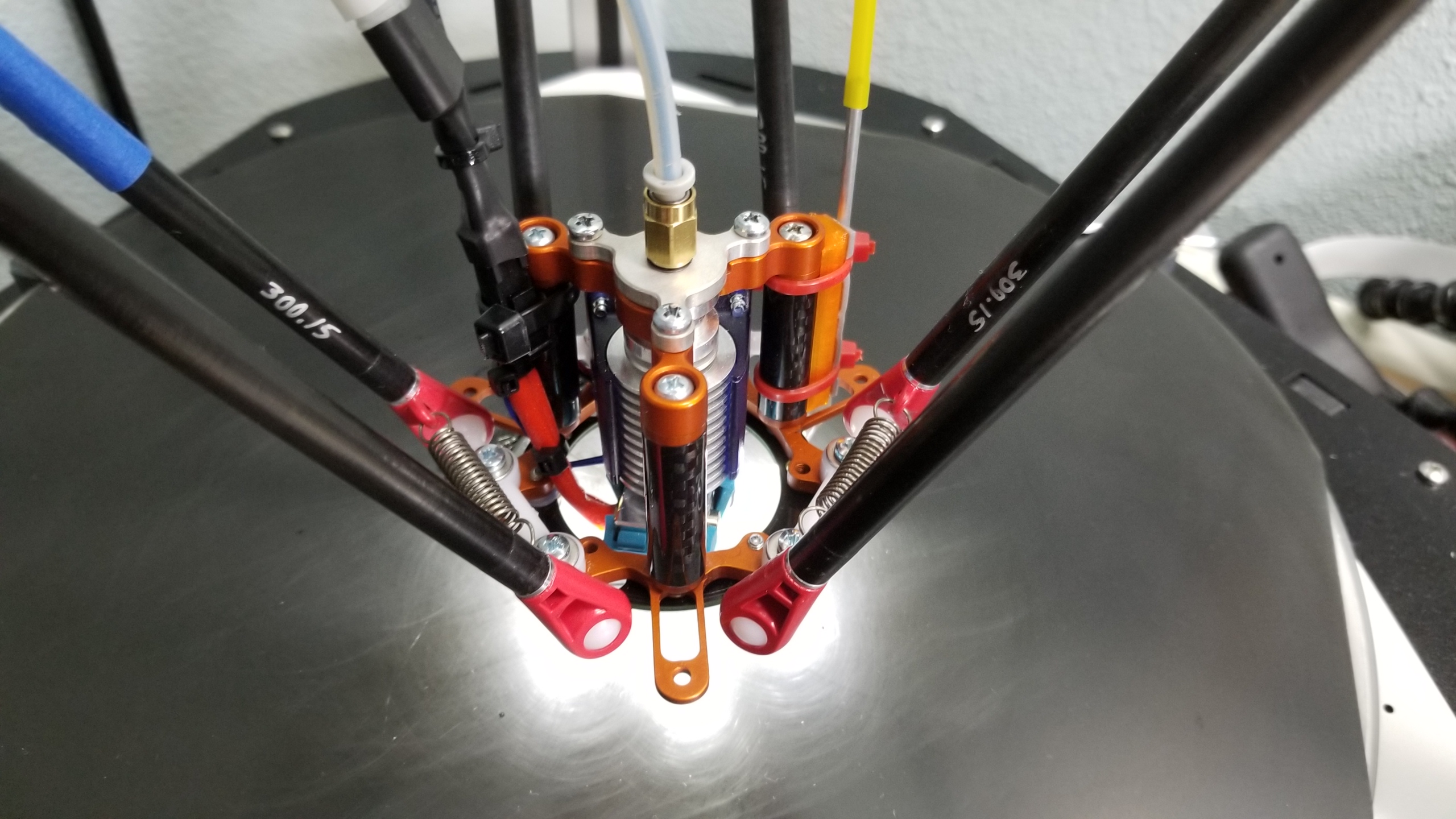

The maker of the Berd Air, Glenn said his motor ran at 120F once it warmed up. Well, it turned out the reason I was reaching 150F was, as is too often the case with me, user error. I wasn't thinking clearly about it when I wired the motor circuit up and used the wire I had on hand, which was 22awg. Glenn pointed out this was a bit light and so I rewired the motor with 18awg. This change, alone, is responsible for bringing the motor temp down by 30 degrees.
I've got to say I absolutely love the Berd Air. It cools the just-laid layer perfectly and I love how it helps to clean up the effector assembly.
Between switching to FSR and so being able to lose the accelerator PCB above and losing the three stock layer fans below, my effector assembly is beautifully uncluttered now. I am using the 713Maker mount for the E3D v6 hotend along with the bowden adapter lock ring so I could extend the otherwise recessed PCT connector. Its light and open for easier viewing of the print.
To be clear, while I do like the aesthetics of an uncluttered effector assembly, I was driven more by the practical desire to make it easier to disassemble the hotend in case of a jam.
