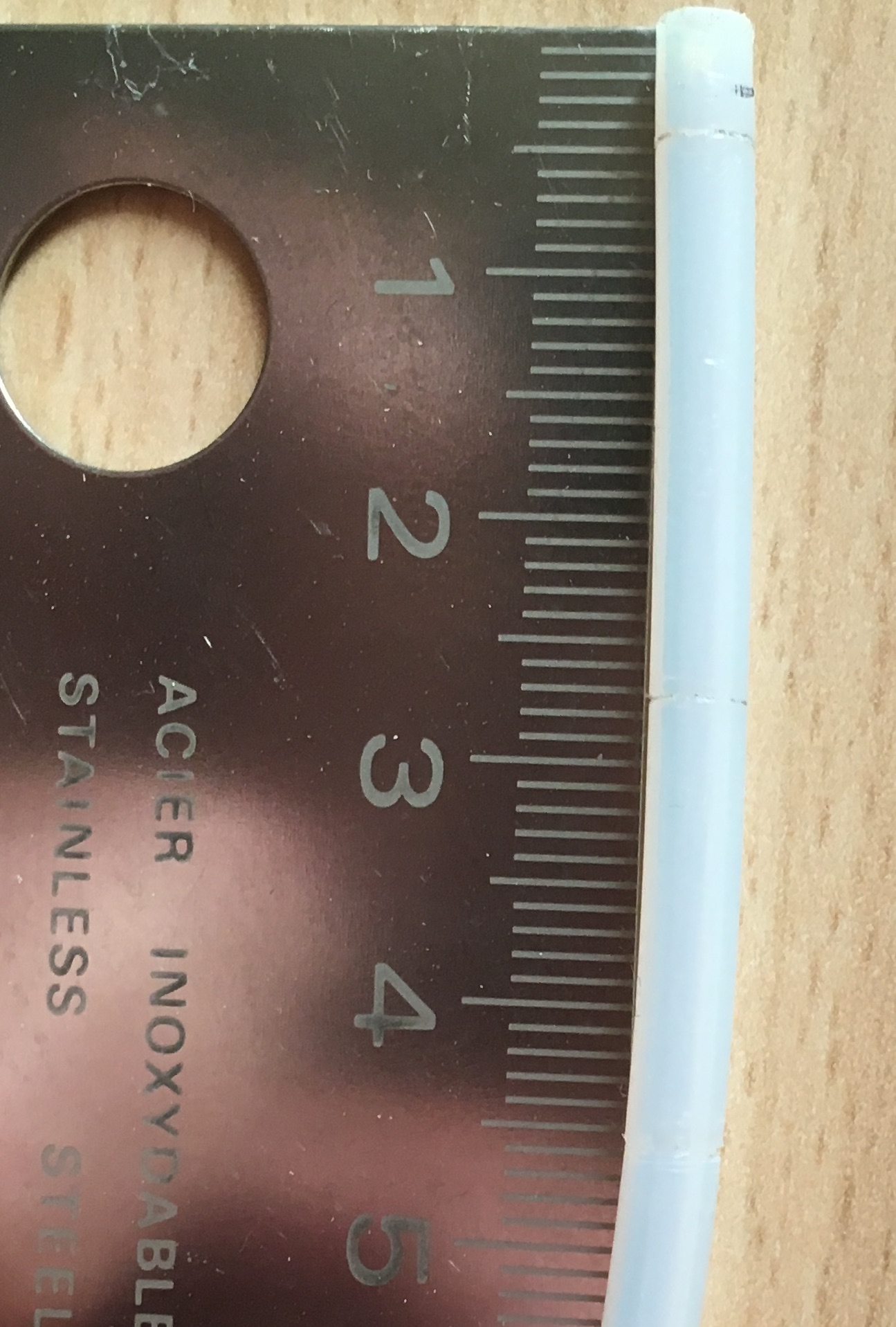

Result of Cold Pull (Strongly suspect that the wider diameter shift may be the actual cause of the "clog"):
[img]http://i.imgur.com/eFUsyvo.jpg[/img]

Things I suspect:
-My PTC retainer may be damaged. It seems to hold the bowden tube in place pretty snugly, and the mark on the tube doesnt seem to move too much when printing.
-I have yet to retrofit to the EZR Extruder, but since a different HE280 worked, I dont think this is the problem.
-I strongly suspect that the barrel fan may be bad. This would be supported by the accumulation of thicker filament above the heater block, and would also explain why the thermal fuse blew despite only being told to heat the printer to 240C. Upon removal and testing, it seems to be vibrating badly.
Thoughts? Any insight anyone can provide would be much appreciated!
