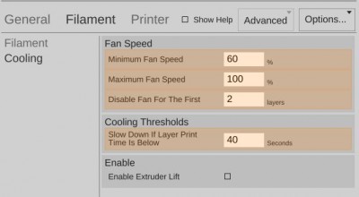

Hi folks,
When I adjust the print head fan speed using the console it works fine. But when I start printing something, the fans turn off.
I've attached the gcode. It has a line "M106 S255". When I use the mattercontrol terminal this command starts the fans, but it doesn't seem to when I print.
Any ideas? Does cura not play nice with rostock V3?
RV_Clearance_calibration_2.gcode
(6.97 MiB) Downloaded 229 times
Re: Print head fan won't turn on during print (gcode issue?)
The layer fans will only run when layer cooling is active. The layer cooling is controlled by the slicer configuration.
