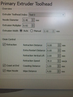

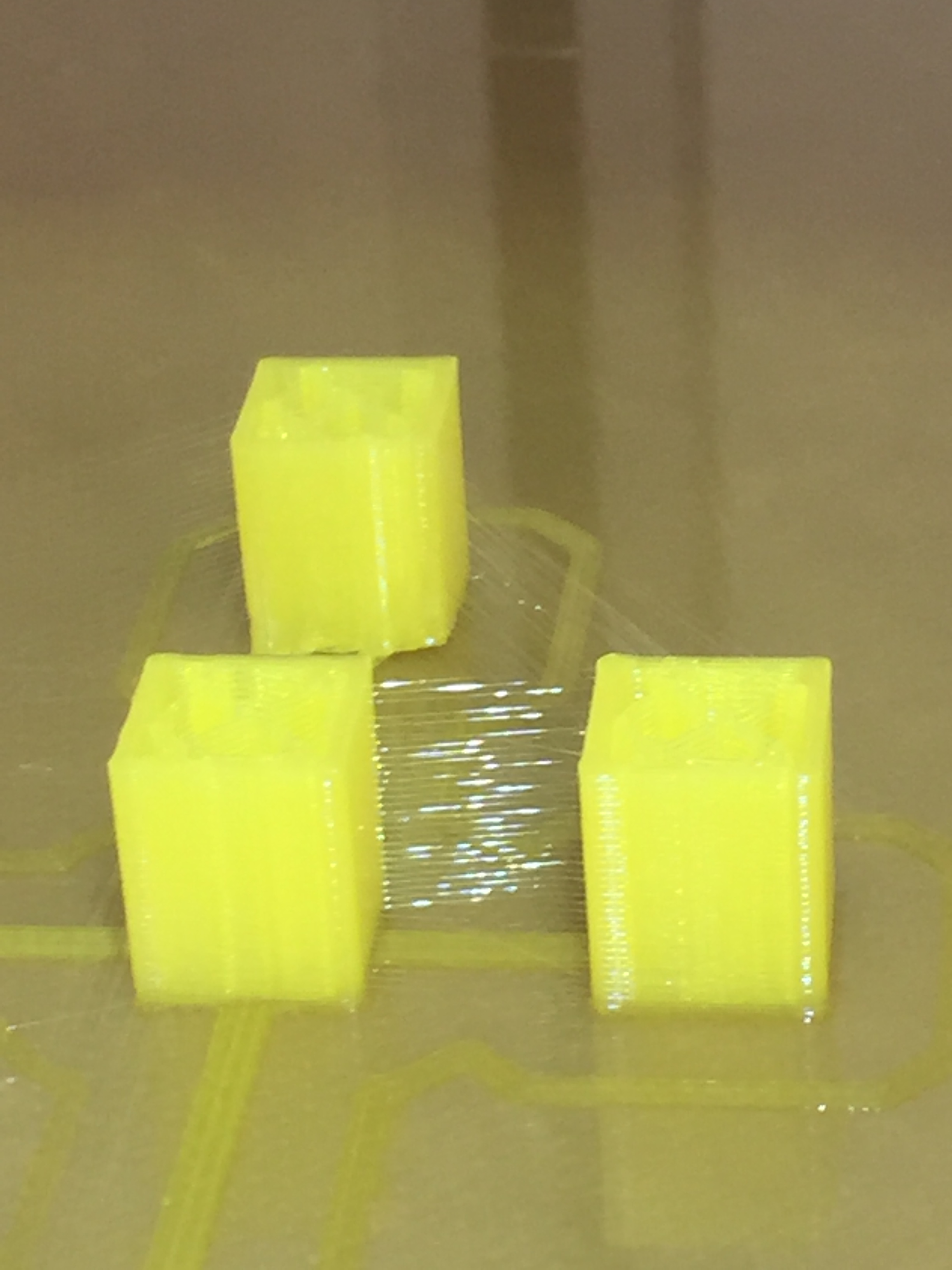

I will just add my situation to this thread, since it is relevant.
I finally got my V2 to V3 conversion printing decent walls and now it is on to retraction tuning.
References for this test are :
https://www.matterhackers.com/articles/ ... -to-oozing
https://www.simplify3d.com/support/prin ... eshooting/
http://www.sublimelayers.com/2016/10/so ... racts.html
And numerous posts on the subject
My current setting are:
Standard yellow PLA
190C hot end temp
300mm/s non-printing movement speed
and:
These are my results:
Where do I go from here?
Juicy
Posts: 8
Joined: Sat Dec 31, 2016 3:00 am
Re: How to fix, is this Stringing?
Post by Juicy »
From what I have read on this subject, and am going through as well; a lot of stringing is a result of a jam in the hotend. Are you sure your bowden tube is seated all the way? Heat the hotend up to 100C then pull the tube out and if you have a "hockey puck" of filament directly under the tube, you have found your problem. I believe that you should have no more than 2mm length on move for your retraction setting. Is your EZRstruder grinding filament?
knabo
Posts: 42
Joined: Wed Apr 06, 2016 12:08 pm
Post by knabo »
The Bowden tube is seated and the tube locks are installed. I am using a bondtech extruder, it is not clicking or grinding.
My prints are pretty uniform, nothing that would indicate there is a jamming problem.
Posts: 5358
Stringing isn't a symptom of a jammed hot end. ;)
Stringing can happen when your printing temp is a bit high for the speed you're printing at. When I first work with a material in S3D, I set up similar basics to what you've got, but also add in a 4mm Z lift on retract. I then print a pair of 20mm cylinders to tune the temp to get it to stop stringing.
