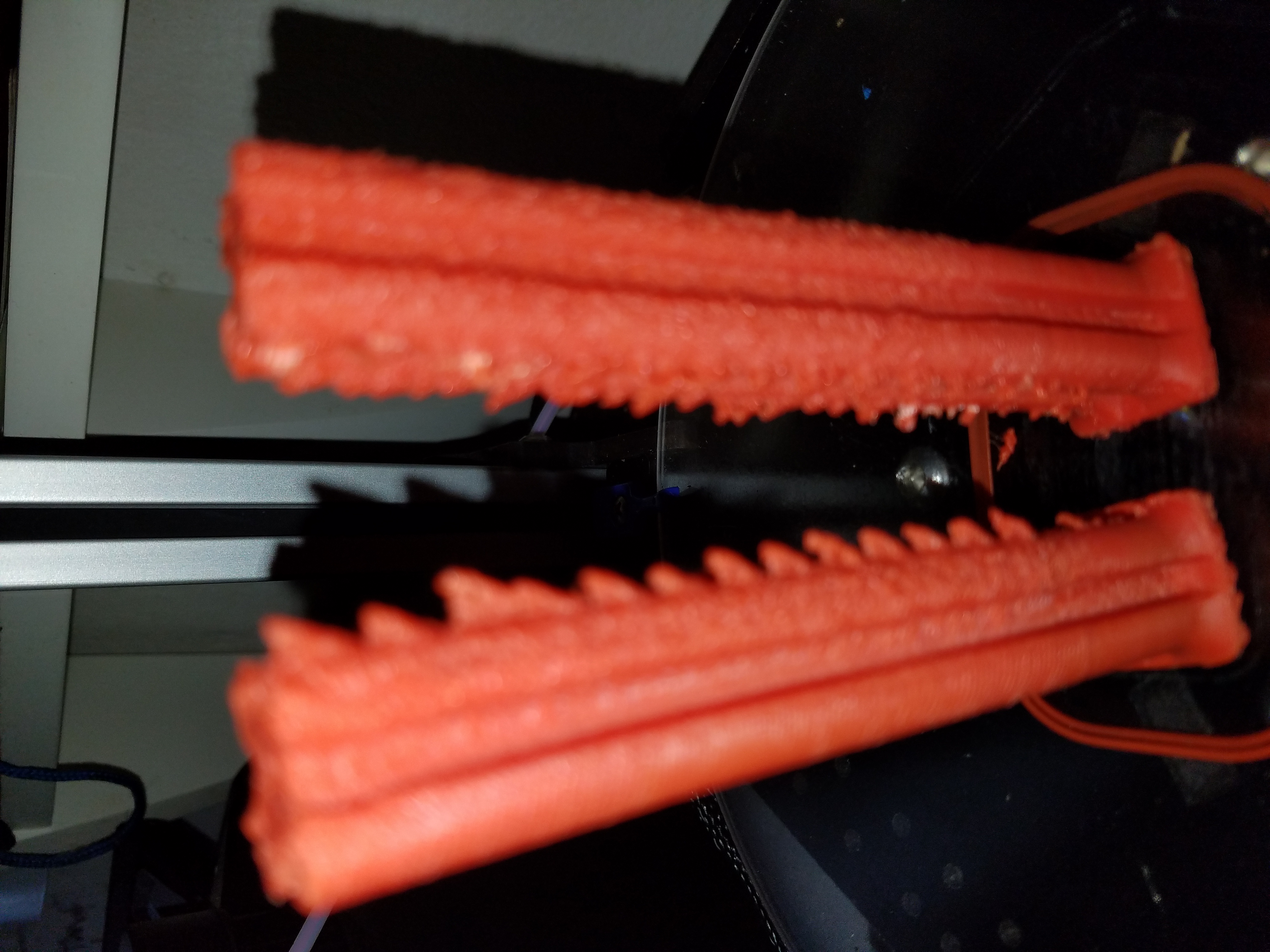

hi, im printing some posts, when i go into mattercontrol and 'edit / duplicate' i can print 2 of the posts, and save some time /effort.. however whren i print the 2 (or more) i get alot of 'fringe plastic' forming on the side facing the other post(s).
its pla, 210c, std layer height, and ive set the non-printing speed to 15 (very slow..)
here is a picture of what happening?
thanks for any advice and assistance.
as you can see in the 1 picture, theyre supposed to be smooth, all 4 sides of the post.

I think that's the worst case of "stringing" I've ever seen. I would suggest you dial back the hot end temperature to 190 and try it again.
Better yet, make a couple of 25x25x10mm cubes and tune your temps using those.

thanks. thats what causes that, i had the posts close together as well. when you say to tune using the squares, you make make a few calibration squares, change temp to 190 and try . and do the pid tuning command 2 times as well prior..?

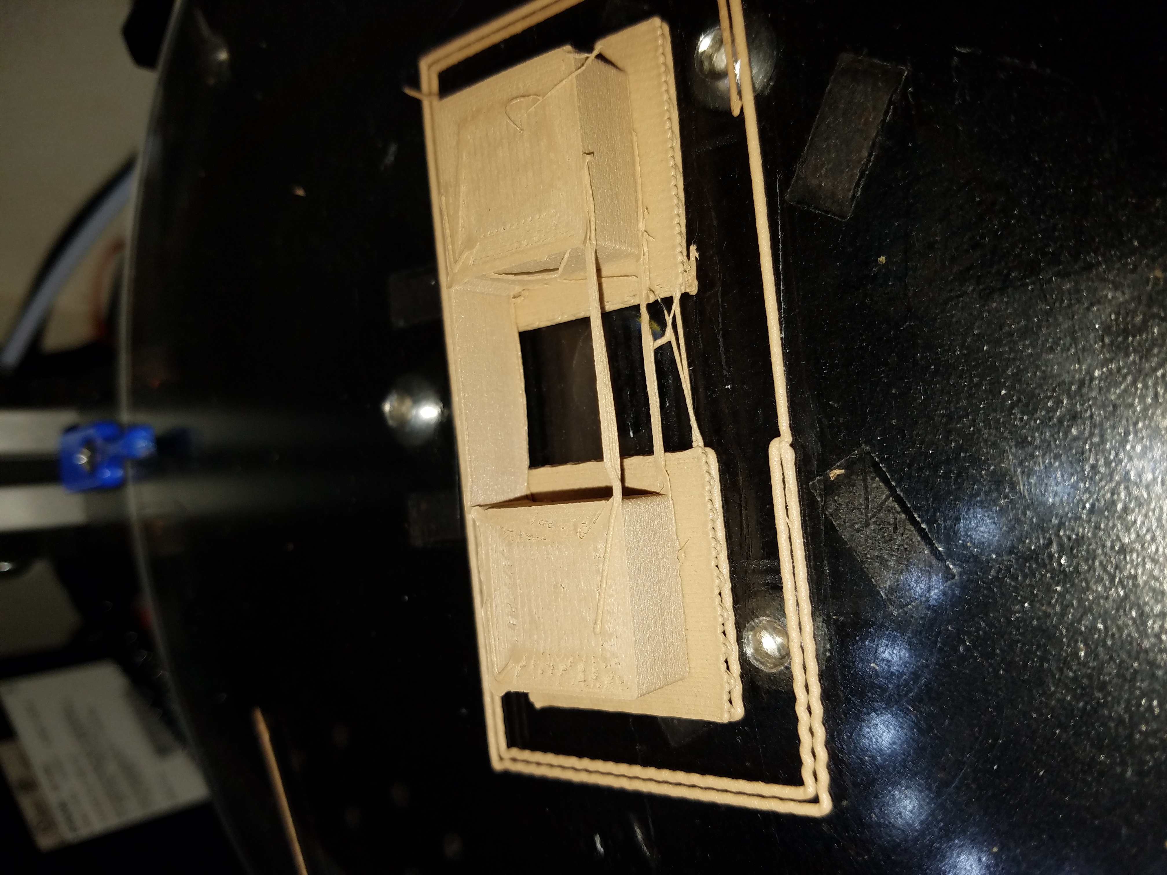

so this is at temp 190c, and it almost makes a 'thin back wall' between the two boxes.?
at fine layer setting.?

Can you say "retraction setting" and "over extrusion" ?

so for the retraction and extrusion settings, in mattercontrol, what should i adjust, more less, etc...?

Does the extruder even spin backward when a retraction occurs? Shoot a quick video of the extruder during retraction. I'd like to see it in action.

ill take a video now. heres a link to the google drive video. for the video im testing printing a single 'post' pla, 210c, 30%infill.
https://drive.google.com/file/d/0B1k73I ... sp=sharing
retraction config in mattercontrol

thanks for the help, i trial/error the settings, as well as cleaned my nozzle! and all looks alot nicer now!
