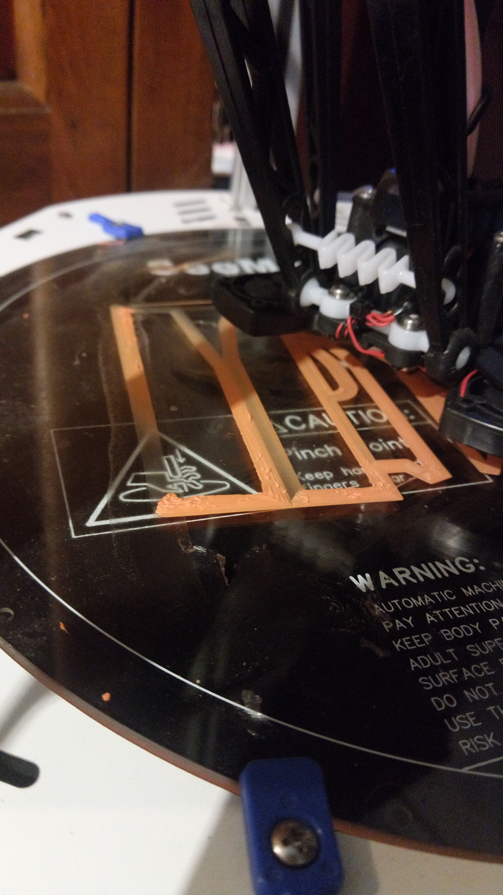

When I print my first layer, I'm having problems with nozzle height near the X and Z columns. I've seen other threads on this, but I haven't seen how to address it. I'm certain its not an uneven surface, because as soon as the nozzle moves in a different direction, the line thickness changes. All of my belts seem to be tight enough. I did buy a new hot end, when my original required overhauling. Is there some alignment test other than V3probing I should be doing?

Have you made certain that the hotend has no noticeable play in it? For example, while the hotend is cooled down, can you reach up and see if the hotend has any wobble when you jiggle it?

I will check for play after my print finishes.

The hot end is rigid. However, I turned the stop switch screw on the X post in by 1/4 turn, and the problem has gone away. Maybe the switch was between steps on the motor?
