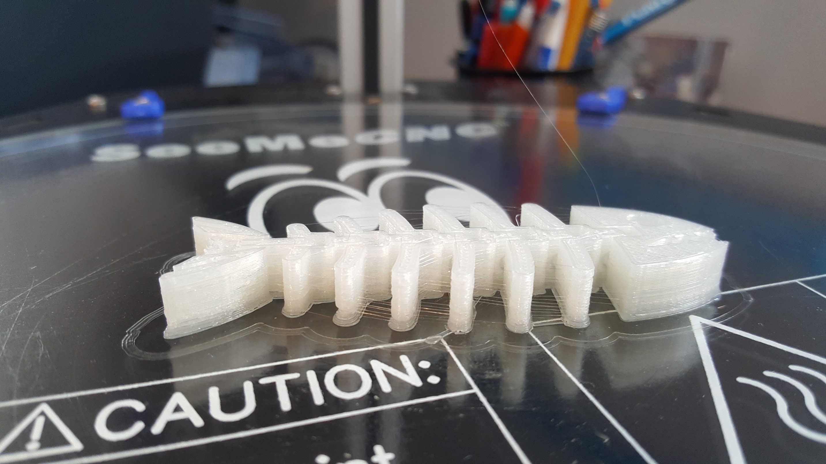

Hi All, been a long time fan of delta printers and after my hacky cheapo prusa i3 finally was finally laid to rest, I saved up and bought myself a Rostock Max v3 kit. So far I'm extremely happy with the sturdiness of the machine, the engineering that went into it, and the prints themselves are pretty solid.
But only as solid as an uncalibrated printer can be! Right now I'm facing two major problems. First off, the plate is inarguably getting pulled down on the sides so the first layer drifts from about the right high to ghostly clear:
[img]http://i.imgur.com/luOs3ZN.jpg[/img]
I saw the phrase "overconstrained" thrown around and I have some ideas where to start, as the seating never felt quite right on those. More on that later.
Second issue is a bit of pasta coming out of the nozzle:
[img]http://i.imgur.com/4IGN2E2.jpg[/img]
This is the problem I look to tackle first, as I can ignore a crappy first layer, but I definitely can't ignore my prints needing a sand down and the office needing a vacuum after each print. I thought I'd chronicle my calibration progress here as I'm using a stock rostock v3, so maybe these changes could be shared with whomever comes after me.

So for the strings, my first concern was temperature, but dropping it from 210 to 190 showed no appreciable difference.
I printed a benchy, and while I've cleaned most of the strings off, there are plenty of z axis jump loops, so I thought maybe the issue was overextrusion. I am using the stock configuration- no reason to expect it to work perfectly.

I finally had time to install the new nozzle. Pulling the ancient PLA I was using to test the rostock I found this:
[img]https://i.imgur.com/EyIgH88.jpg[/img]
Looks like I was at least half right when I questioned the seating and the nozzle. I cleaned out the heating area as much as I could, and replaced the nozzle and the filament with some new ABS I got from seemecnc straight. I didn't realize that you're not supposed to cool at all with ABS, as cooling mid-print will cause curling, so I ended up with quite a few "heater decoupled" errors that made me scratch my head.
Eventually I realized that the cooling was destroying the bed- it couldn't keep up with the fans and maintain 80 degrees. The bed temp kept dropping, 79, 78, 78.5, 77, and so on- eventually causing a DEC error. So, at first I started lowering the bed temperature manually during the print, and around 1/5 of the way through I realized there was a button on octoprint to just turn the damn fans off. The result? A pretty damn good benchy!
[img]https://i.imgur.com/kl2OhnZ.jpg[/img]
The minor stringing is still a concern, but still better than my previous prints by a mile. This has something ridiculous like 3mm of retraction as well, so maybe I can cool that down a bit? Word to the wise: if you have an 80 degree C bed, the rostock max v3's fans will obliterate its ability to hold temp and cause DEC errors. Don't forget to turn off cooling on ABS!

I've been having a ton of trouble with strings and PLA.. and the V3.  Sigh..
It might not look bad but it is literally every where it could be. I've tried a LOT of different settings and read 7 out of 10 pages of posts. What the heck is going on here... Have two cr-10's and two mono price printers (have a lab at work), none of the string like this one!!
Was trying to use the stock software that came with the v3, was pretty terrible, went cura, got better but still strings, bought simplify3d...very cool, nice and easy BUT STILL HAVE STRINGS.. have mess with retraction two different hot ends (one I assembled, one straight from seemecnc)
Any help is appreciated!! Really want to love this printer!!

Try faster retraction and/or lower extrusion temperature.
						Re: New Rostock Max V3! Let the Calibrations Begin
I was getting really bad stringing and oozing issues, but then I found this post:
https://www.matterhackers.com/articles/ ... -to-oozing
Usually I think "but this won't apply for my printer, but it turns out Matterhackers sell the Rostock Max, and if you look at the pictures of the test prints, the build plate is... round? You can almost make out the logo....
Well, point being I did this and my strings went way, way way down. I used their "this seems to work in our case" settings at the end of the guide and got a great improvement, but I also found the model they used on Thingiverse (their link is old and broken or something):

Any new filament I use I'm going to go through this process to dial in my slicer settings.
