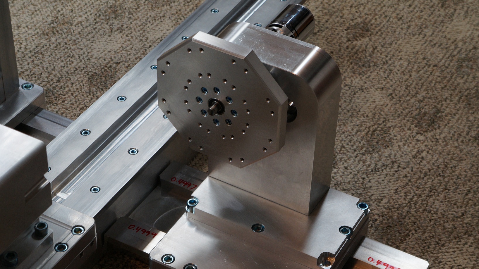

Not quite done yet, I still have to put threaded holes in the bottom and counterbored holes through the riser plate. But it's coming together, I should have the turned parts going next week.
And don't worry, your pricing guestimates wouldn't affect the retail price in any way. My main concern once I launch the Kickstarter will be to reach the funding goal, and to do that I can't be pricing this thing high.
The 300 dollars for the electronics would be doable for the full machine, but I realized that using the boards I already have makes more sense for the prototype. It's mostly about the mechanical stuff for now.
The turret block in the picture will fit big tapered roller bearings; the smaller pocket is for the geneva crank bearings. On the V1 prototype, I used an acetal plain bearing to hold the rotating shaft. It worked, but there was more friction than I wanted which limited the turret to no more than 1 tool position index per second. Also, the bolt circle around the large bore will fit a 3d printed cover to keep chips out of the geneva mechanism. There are tapped holes on the back for a live tool motor and cover.

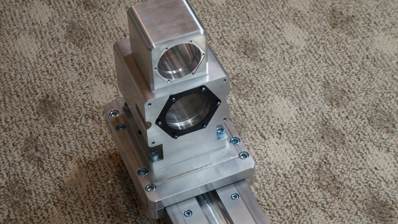

Didn't quite finish the turret shaft, but I'll get it done in the next few days. Both the B axis and turret axis rotate on tapered roller bearings, shafts are 65mm where the bearings fit. Actually I designed the machine so all of the large bearing pockets are the same 100mm bores with 65mm shafts; the main spindles use precision angular contacts while and the low speed axes use tapered rollers. Most industrial CNC lathes use these things called curvic couplings and a pop-lock mechanism during the index, but mine uses a rotary plane from 2 heavily preloaded bearings and a tapered cam to locate the angle. This is just a larger version of what I did on the version 1 machine, and it seems to work great. BTW the shaft in the picture below is 3 inches in diameter.

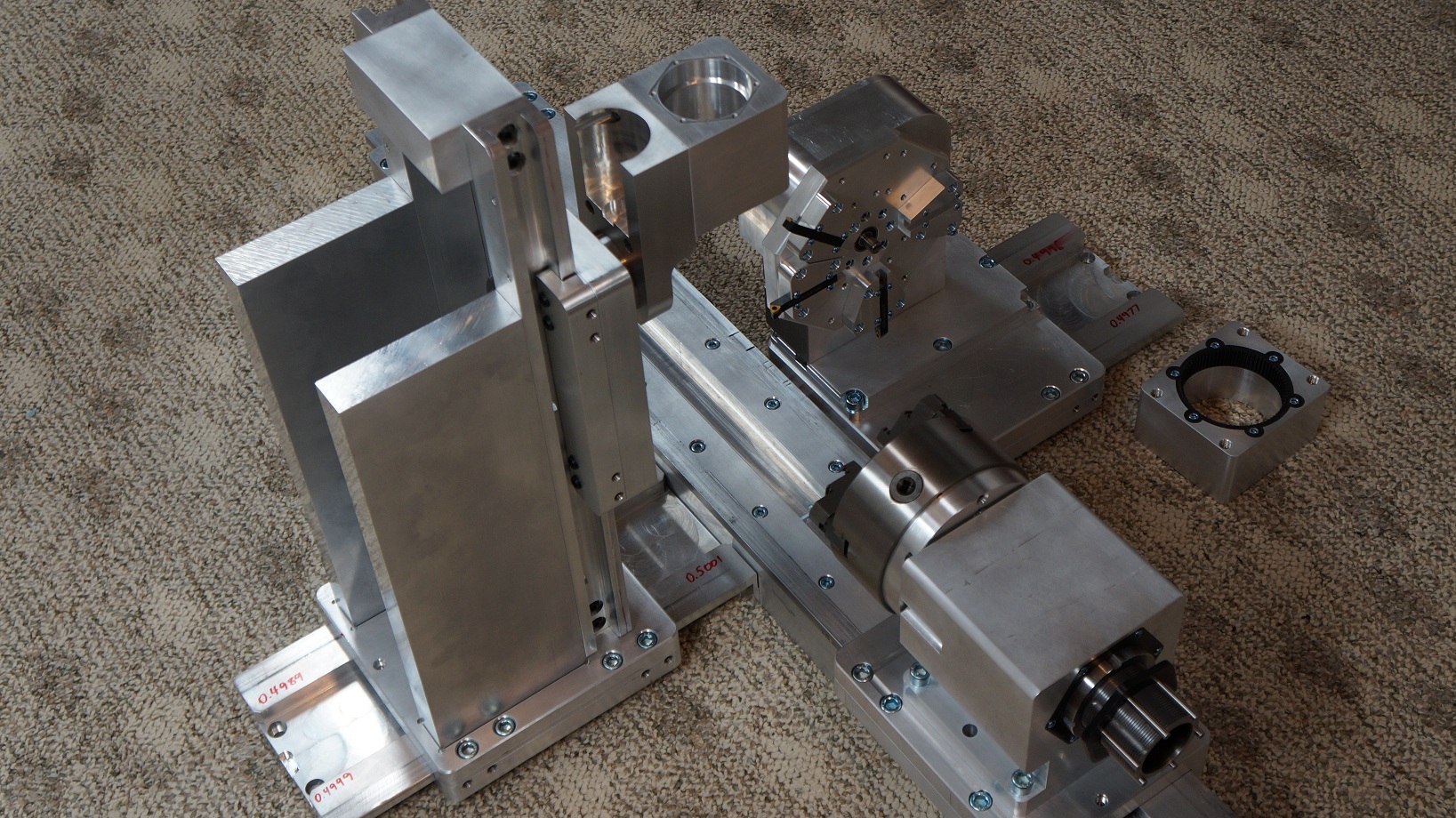

Here's the machine with 3 major axes on. More progress coming this week, I'm hoping to get the turret octagon done and the main spindle turned.

This is the harmonic gear mounting block, it's on the back side of the B axis. The flex-spline cup gets bolted to the bolt circle on the B axis shaft, while the rigid internal spline fits in the block. A motor aligned on the back will deform the flex-spline cup to rotate the B axis shaft. I printed out a test model over a year ago, and it seemed to work pretty well.
Also here's the milling head mostly finished on top of the main headstock for size reference.

A few more pictures to show how it's coming together. Still have quite a bit of work to do but most of it is done.
The turret tool blocks are for 3/8x3/8 stick tools for now, I'll get a few variants in the next few days.
