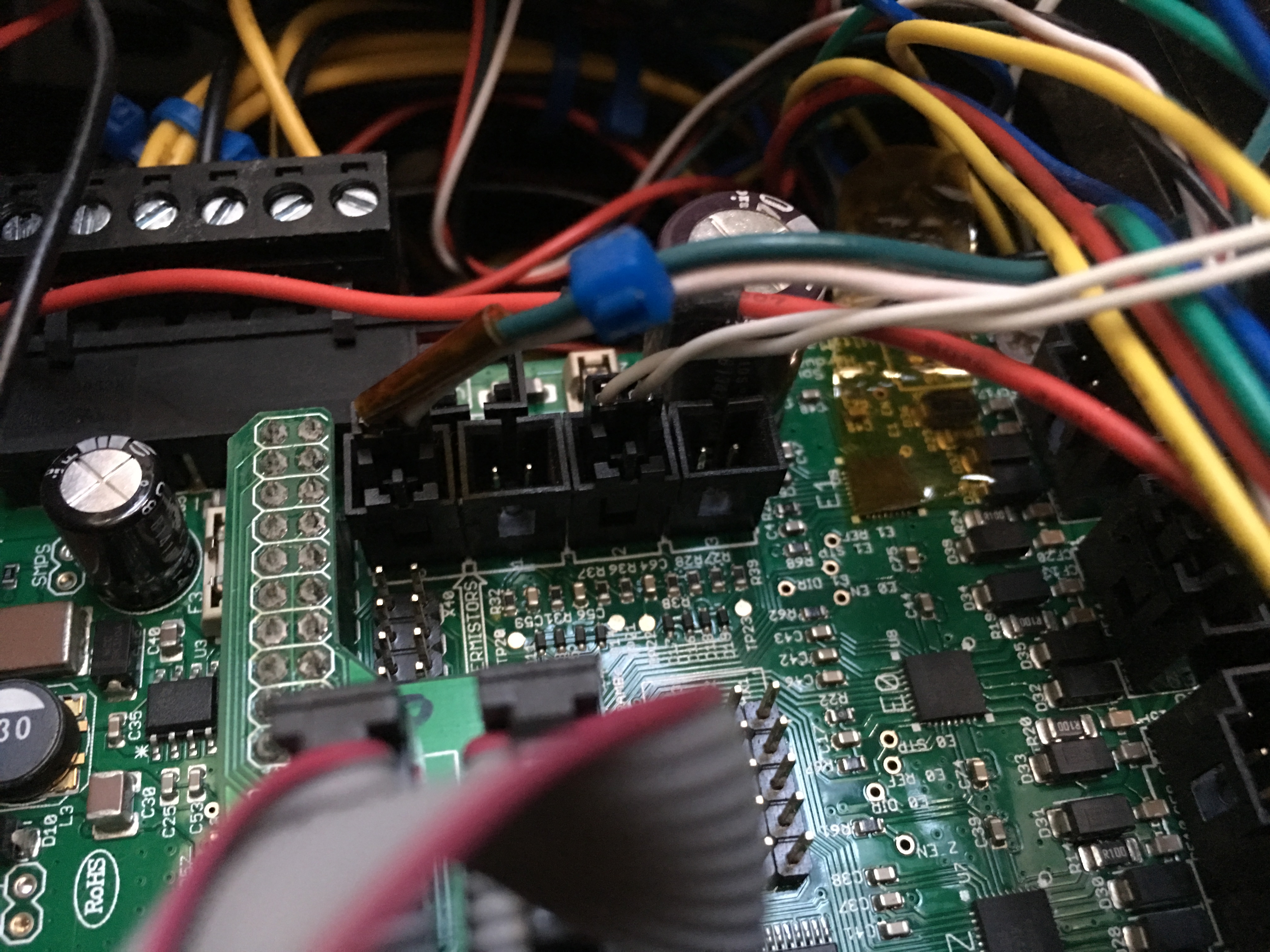

I've been in and out of hospital for a while now and was never able to fix and debug my rostock max v2. The last i checked I had a def error which from a previous posting and searching means i have a broken or shorted thermistor on the bed or hot end. i guess there was a spare thermistor hookup on the board but I'm stlil at a loss. One is re-programing the board to work.

There are arm kits, as well as assembled and kit hotends and wiring harnesses. Now, for troubleshooting, I'm nowhere near FL, but I would be willing to give you a hand with figuring out what you need. The first step would be unplugging the thermistors, and using a multimeter to check them for resistance. Around 100K would be the correct values. Either of them that doesn't measure sorta close to that is the defective one. If you have trouble getting good contact with the connector, see if you can buy a few .1 in pitch header strips to plug into them, or better but more expensive and sorta pointless, either an IC probe for the multimeter or the correct male pins to insert into the connector.
Honestly, debugging software side is a lost cause here. This is a hardware issue (Whether it's a short, an open, or just plugged into the wrong spot), and while the software could be made to work in some cases, it's better to get the hardware right. I would also say much the same thing about starting upgrades right now. We know very little about your issues other than that it's a thermistor issue, and that it's very possibly related to that V6ish hotend you tried to install. which does suggest the hotend, or it's wiring harness. But especially if you have budget issues, I'd rather not start by throwing parts at it.

Hi,
Just tested both. Seems the replaced hot end is 180ohm and what I think is the heated bed around 90 Ohm though hard to trace the wires i went from schematic etc.. I actually changed the hot end when I had the def error because i was having issues with the resistor connections etc..
Could be the hardware board.

Hi,
Again sorry for delay. Dog Surgery and my health i'm a bit bogged down but would still like to fix this sucker.. I'm including the picture I took of the board as well. @xenocrates I'm all ears for how to continue debugging and will try to be faster at replies.. Or if we can use slack etc and an available time.

Okay, so unplug those two and measure the resistance (if those measurements that you took earlier were correct, then both are bad).

The heated bed one may be vaguely correct, but the hotend one is definitely wrong. The RRC thermistor works, but I prefer PT100's personally, since I do some rather daft things (Hello, 450+ C printhead temperatures), and prefer the mechanical reliability. The RRC one is miles beyond an unpotted thermistor for strain relief though. I'm sorry to say I can't do much troubleshooting with you right now, as I'm doing final prep for a convention this weekend, but feel free to PM me a slack, skype, email, or other address you'd like me to try to use to help you.
