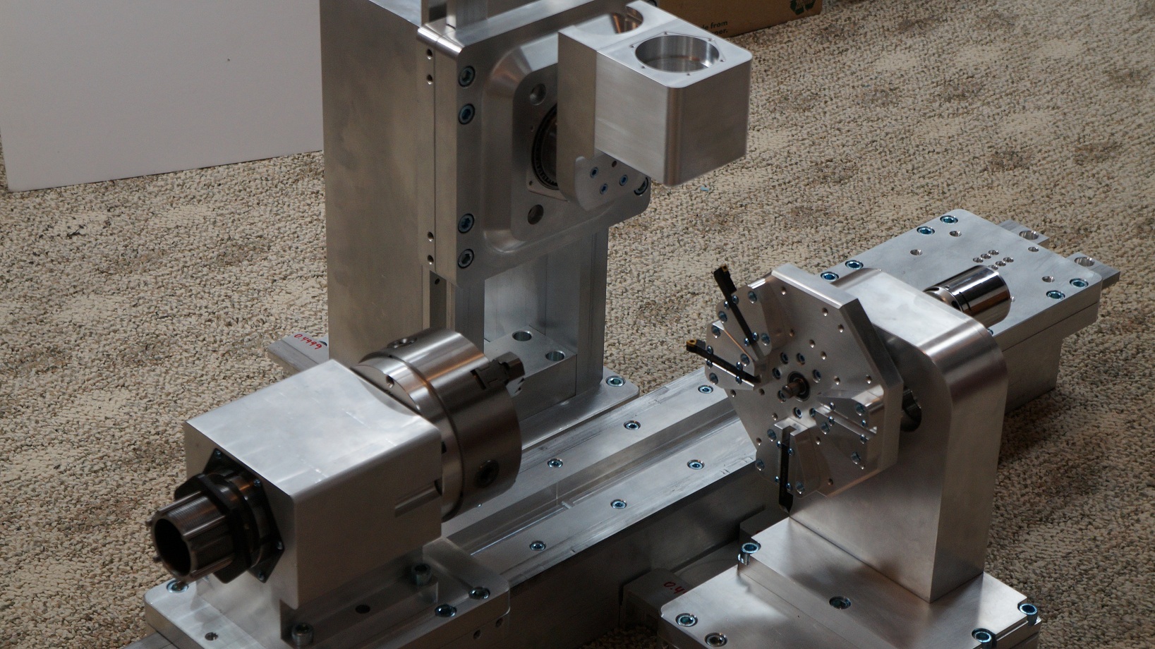

Didn't quite finish the turret shaft, but I'll get it done in the next few days. Both the B axis and turret axis rotate on tapered roller bearings, shafts are 65mm where the bearings fit. Actually I designed the machine so all of the large bearing pockets are the same 100mm bores with 65mm shafts; the main spindles use precision angular contacts while and the low speed axes use tapered rollers. Most industrial CNC lathes use these things called curvic couplings and a pop-lock mechanism during the index, but mine uses a rotary plane from 2 heavily preloaded bearings and a tapered cam to locate the angle. This is just a larger version of what I did on the version 1 machine, and it seems to work great. BTW the shaft in the picture below is 3 inches in diameter.
Xenocrates,
There are quite a few old machines from the 80's and 90's that have depreciated under 10,000 at this point. Anyone can buy one, but the cost of shipping and rigging and wiring for 3 phase don't decrease with time. My machine will plug into any household outlet, both the 120v and the 240 appliance outlets. Since it uses hot-swap server PSU's, there is no need for phase converters or anything. The server PSU's output 12v 60 amps each, so in series they can do 48v 60 amps, which is just under 3kw. Eventually (long term) I'd like to get to the point of a battery augmented power supply for the whole machine. That would allow it to surge hundreds of amps for heavy cuts. But for now, the server PSU's are good enough.
It looks like I'll be doing two control boards for this prototype, I don't want to drop 400 dollars for a duet at this point since I already have surplus boards laying around unused. But I definitely want an on-machine touchscreen for the production version. I've done GUI interfaces before from the ground up, so I don't think it would be that difficult to program for a mill-turn as long as the base firmware is already done by someone else.
I'm not planning on cutting corners in production, which is why I want to do it myself. I would be offering several variants at different price points. The least expensive would be the base + headstock + turret model. Since the boxways on this machine are identical, extra axes can be added on later; so you could purchase the machine with just the headstock and the turret, then purchase the 5 axis milling column later on, then a 2nd headstock (subspindle) later on ect. It will be modular.
There are quite a few CNC kickstarters from the last few years, even a few from the last month! Nearly all of them that have a working prototype and a decent video get funded. Most get several hundred thousand dollars, some get millions. Only a handful of them failed to get funded, probably because they didn't have prototypes or business plans whatsoever.
Here's the machine with 3 major axes on. More progress coming this week, I'm hoping to get the turret octagon done and the main spindle turned.

With the control and support you're talking about, I have no real pre-made options. The electronic hardware will have to be something like the smoothie or duet board, and I'll have to write a branch of firmware specifically for my machine. There are no hobby level firmwares for a machine of this complexity and arrangement. Even in real industrial controls, there are only really 4 options; fanuc, heidenhain, mitsubishi, and siemens. They offer control electronics for mill-turn centers and swiss type lathes with many axes, but all of their controls are well over 10,000 dollars.
On to some little details of this build. I decided to use these little collet holders as standard tooling for the lathe tool turret. They're ER16 collet sockets intended to be put on motor shafts for hobbyist engraver machines. They're cheap, tiny, and compatible with with all sizes of er16 collets up to 10mm. They make these in ER20 as well, which can do up to 13mm (1/2").
These will go in tool blocks that bolt to the face of the turret. By having oversized bolt holes, the blocks can slide and rotate a little before being locked in position. This will make tool setting a lot easier, since you can clamp the drill/tap/reamer or whatever in the main spindle to align the zero position. It's a lot easier than having to indicate each tool in like on a full sized CNC lathe, and just as rigid.
Next is the power transmission. On the first V1 prototype machine, I tried to use rigid couplers with set screws to transmit torque for both the axis steppers and the spindle motors. It kinda-sorta worked, but it was unreliable over time and had problems with torque overload. On this new machine, I'm using these spider couplings for every axis and every spindle. They can take a lot more misalignment than rigid couplers, and they can clamp onto smooth round surfaces with much better holding torque.
Last thing for now are the encoders; these things are the least expensive, easiest to mount, and highest resolution of anything I could find. They offer several variants for both absolute and incremental positioning up to 4096 positions per revolution. The plan is to put one of these with absolute capability on both the main spindle and the milling spindle. If I end up using the O-drive controller with RC motors, these encoders fit on the shaft easily. I probably won't bother putting them on stepper shafts even though the steppers have back-side shafts. Those will be for handwheels. I may end up mounting linear encoders on each linear axis since there are many DRO kits on ebay and amazon that are essentially just the working mechanism of digital calipers with 0.0005" resolution.

I'd like to post some stuff about the milling spindle for your evaluation....
Below is the side view of the milling head and B axis, it's the part that slides up and down on the Y axis column. You can see the harmonic gear that will drive the B axis in the back (left). Two big tapered roller bearings in the middle, then the shaft that holds the milling head sticks out on the right side. In the milling head is the spindle. The spindle is driven by a pulley system at the top, with 6 round keys at the torque interface. The light blue shaft down the middle of the spindle is the drawbar.
To keep the milling head ultra-compact, I decided to go with a novel approach for the drawbar system. It's just an M12 socket head cap screw. At the top of the milling head, there is an enclosure box (not shown). In the enclosure box, there will be a solenoid that pushes a hex-key into the socket head cap screw hex socket, which effectively prevents the screw (drawbar) from rotating relative to the entire milling head. However, the pulleys can still rotate the milling spindle tube. By engaging the solenoid while rotating the spindle, the drawbar rotates relative to the spindle. This means that the top side of a toolholder can have the drawbar screwing into it to tighten/loosen the thread fit.
Also not shown is the spring inside the milling spindle cavity and the captive nut on the drawbar. The spring presses down on the nut, which keeps the drawbar at it's down position in the spindle. The drawbar can be pushed up in the spindle about half an inch before the captive nut hits the top of the spindle cavity.
This whole system allows toolholders to be changed on the fly using only a solenoid and the milling spindle motor. No compressed air needed, no pneumatic torque wrench, no wrench-from-the-back. I'll be building it over the next couple weeks, once the physical model is made I'll demo it to explain better.
Now onto the actual tool holders. On the version 1 prototype from last year, I made an ER25 spindle. This one will have an ER32 spindle. But there's a catch...
The spindle nose for the ER32 is almost the exact same size as a BT30 spindle. ER32 has a 32mm taper entrance with a 16 degree slope (8 degrees per side). The BT30 has a 31.75mm taper entrance with a 16.26 degree slope.
That 0.26 degree difference means that ER32 collets and BT30 tool holders look identical, but don't fit quite right.
I want the best of both worlds for my prototype; the ability to use ER32 collets directly in the milling spindle but also the ability to have preset tool holders that I can swap out quickly with an ATC.
So the tool holder below is what I came up with. It's the same size as an ER32 collet/BT30 holder, but the taper is 16 degrees for the collet system. This means I can fit both in the spindle. I would have gone with a BT30 taper, but the tool holders cost in the range of 100 dollars each, and I need a bunch of them. So for the prototype I'm making my own holders out of soft steel. If they don't work as expected, I can still use ER32s as a back up.
I'll make my tool holders with ER20 noses for tools up to 13mm. Hope this post wasn't too confusing. Let me know if I need to clear anything up, I'd like input on this subject because I'm pretty much making a new standard right here that may be important if/when this goes to production.

A few more pictures to show how it's coming together. Still have quite a bit of work to do but most of it is done.
The turret tool blocks are for 3/8x3/8 stick tools for now, I'll get a few variants in the next few days.

Here's what the tool holders look like. Two of these are aluminum, just wanted to test my program before running the steel one out of hex bar. ER20 nose on these, so it can't hold tools with a shank larger than 1/2". I'll run a bunch more later on, I still have to make the milling spindle so I can test the taper to taper fit of these.
I'll definitely go with a standard BT30 compatible spindle in production but for now I need to have ER32 as a backup in case these tool holders suck.
