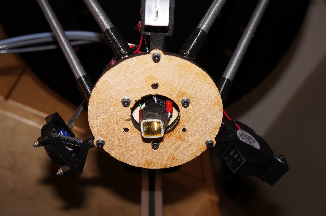

- You need to #define END_EFFECTOR_HORIZONTAL_OFFSET 36.5 in configuration.h for the new effector. (if you don't do this you prints will be too large)
- The stock seemecnc hot end will work in this but don't use the standoffs. You want to keep the hotend away from the printed effector.
- I used 1/4" light ply to laser cut the all the dxfs EXCEPT for the J-Head groove mount which is thinner material.

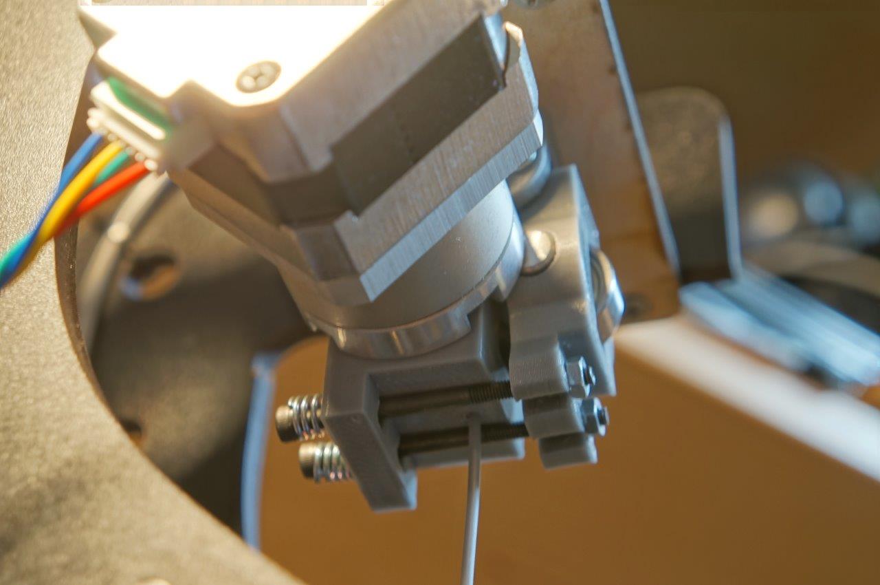

BOWDEN Extruder:
- This bowden extruder derived from tscdan's excellent design.
- Files on my github
- Uses same ptfe pushfit that are on SeeMeCNC Rmax.
- Stepper Kysan 1040222 http://www.kysanelectronics.com/Product ... ordID=8318
- Gear on stepper from Stock Drive products. Part number: s10t05m022s0508 https://sdp-si.com/eStore/Catalog
- I am getting 60mm/s retracts with Rambo current set to 115. It is ultra quiet.

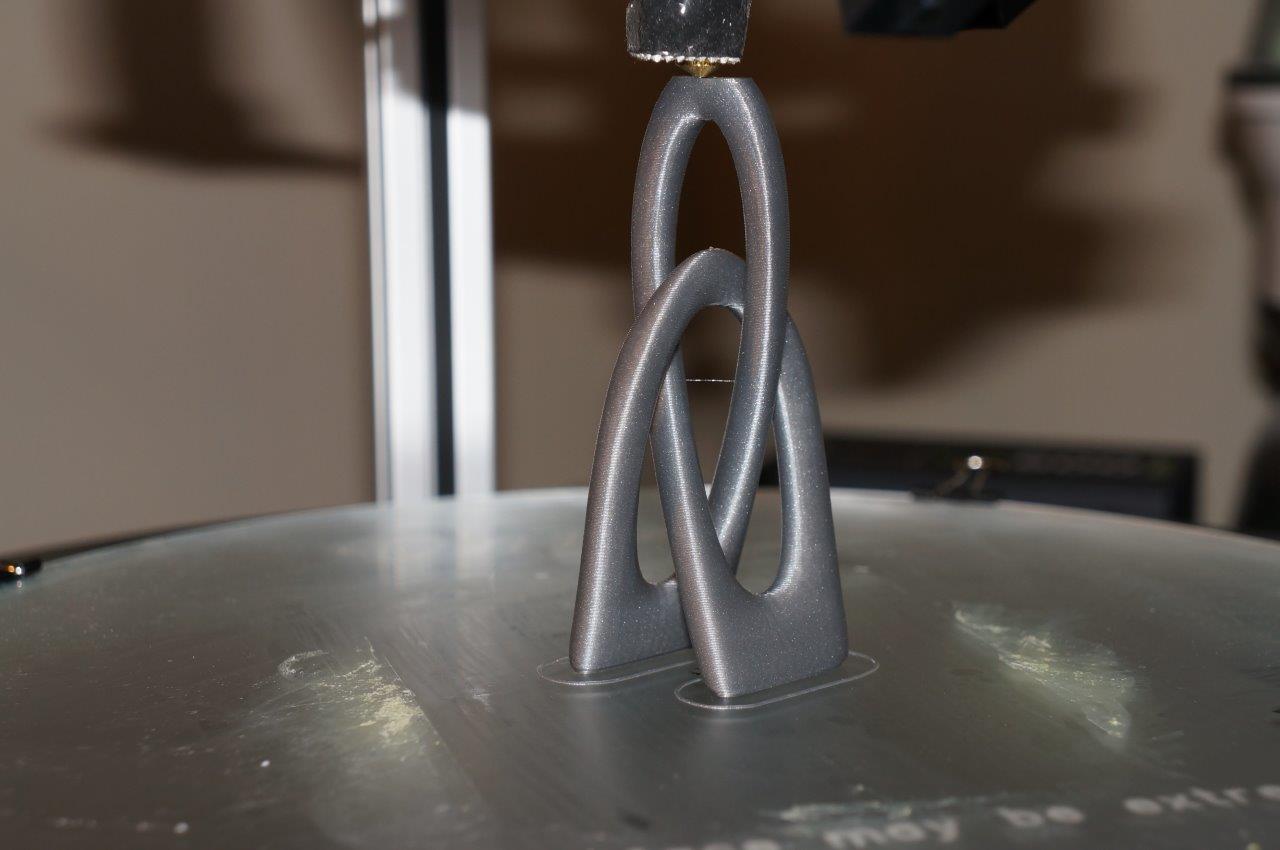

Here is the first try on the pyramid.
							The Xnaron Project http://xnaron.com  find me also on youtube http://youtube.com/xnaron

Some pics

Xnaron, so you had to drill new holes in the cheapskates to mount your printed pieces, right?

No I used 3mm screws in the existing holes. I used the outside holes rather then the inside ones.ApacheXMD wrote:Xnaron, so you had to drill new holes in the cheapskates to mount your printed pieces, right?

Yeah I think that is arguably the best print I have ever made on any of my printers.Flateric wrote:That last print sample is mouth watering its so nice.xnaron wrote:Some pics

Nice print! Looks like those joints are working out. I think your hot end also as a lot to do with the quality of the prints you are getting.
Can you post a link to that last file you printed? I would like to give that a shot soon. Also I am assuming you are using KISS?

Its the Vica Illusion Sculpture here http://www.thingiverse.com/thing:5700aerouta wrote:Nice print! Looks like those joints are working out. I think your hot end also as a lot to do with the quality of the prints you are getting.

OMG that's amazing the print results speak for itself I didn't even think that was possible to get such good quality
						Re: Printable magnetic u-joint option for Rostock Max
Thanks guys!  I am am extremely happy with this setup.  I've made a number of prints now and they all come out incredibly beautiful.
