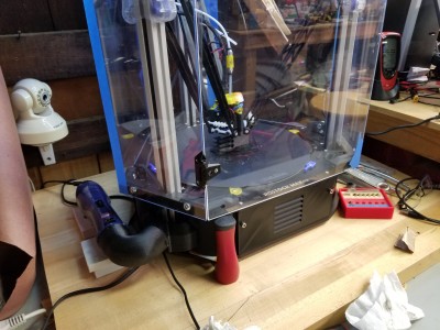

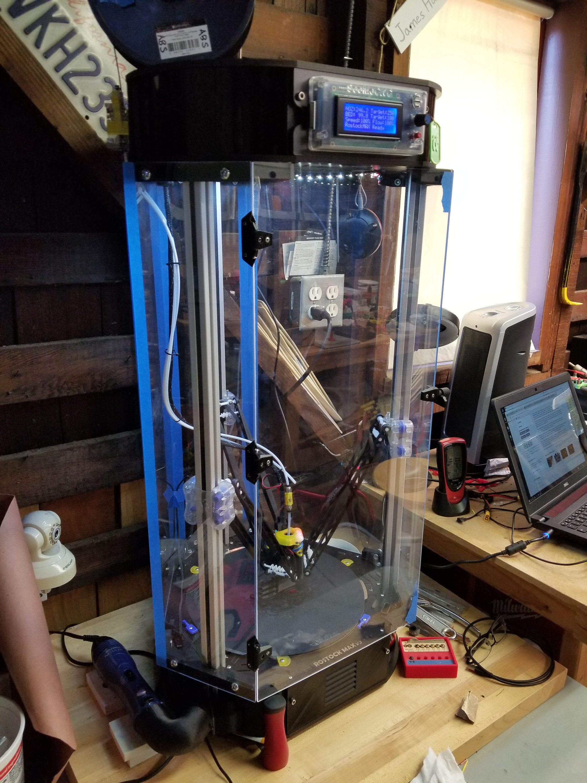

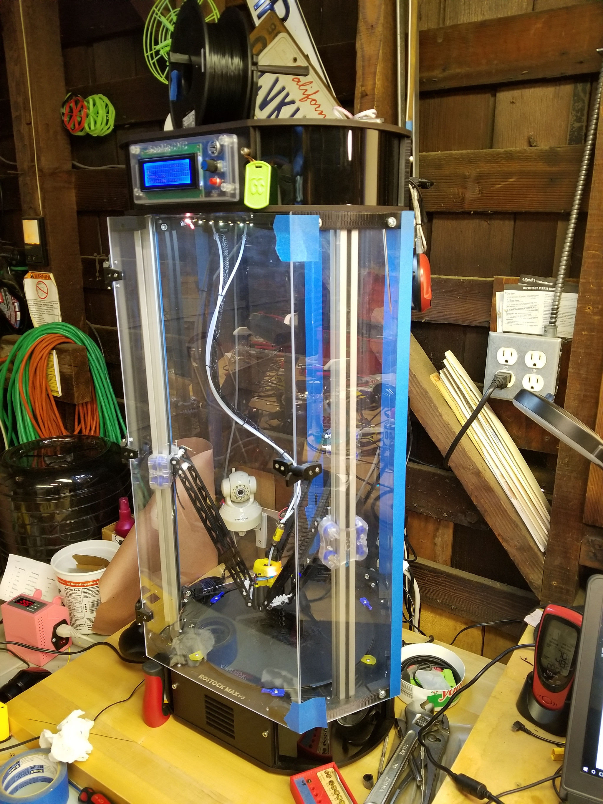

- Enclosure
-  Slim Enclosure (TAP Acrylic)
 https://www.thingiverse.com/thing:1796438
-  Slim Fan Shrouds (needed to fit enclosure)
 https://www.thingiverse.com/thing:2058092
 -  Insulate Bed
 Used foil backed insulation and foil tape to cover back of heated bed insulator.
-  Plug Vents
 All vents from the upper and lower electronics area were taped over to isolate the enclosed area from the electronics. Vents were then added to allow the power supply and RAMBO to cool with air from outside the enclosure.
 Included in https://www.thingiverse.com/thing:2802367
-  Front Vent Plate
 Replaced the front plate on the base with a vented plate to provide cool air to the power supply area.
-  Top End Access Door with Fan
 Replaced the cover above the RAMBO with a ventilated plate that could accept the RAMBO cooling fan which draws outside air down into the bay. Due to heat issues with the heated enclosure, I redesigned this for an 80mm fan and now my electronics and stepper are super cool.
 While insulating and isolating the enclosure helped significantly, it was still difficult to maintain room temperature (or hotter, for PETG/ABS) when the ambient garage temperature was only in the 40s.- Heating Manifold

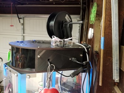

 - Installed RasperryPi Running OctoPrint
- Filament Runout Sensor Box
- Extended Spool Arms
 - USB Port Plate
