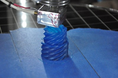

bbrvvvvv wrote:Guys you just have to check out this thing of beauty!
Happy printing!
Werner
Is that the hollow cube with zero infill?
Purple = sarcasm

Hi Buddy, Yes but it was sliced with Kisslicer using vase? Thats the trick!
Happy Printing!

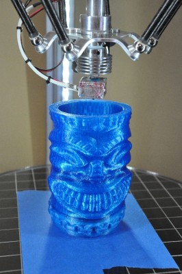

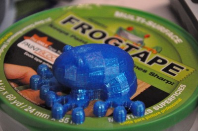

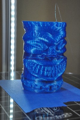

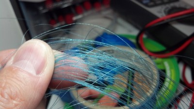

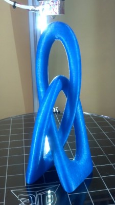

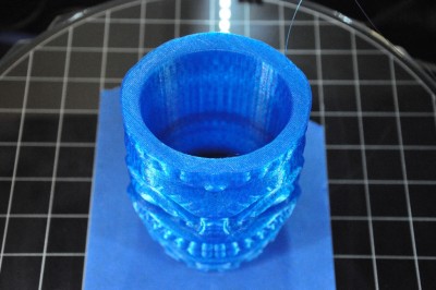

Hi Guys, I just started using PLA OOoooo man is this stuff awesome!! Amost no warping, so cool. The other day I went to bed having just started printing a Tiki Guy and in the morning I woke up to this! It finished at 5:54am. I discovered another cool benefit of using the mags. When I had started the Tiki Guy I acquired a small leak at my nozzle. It dropped a fairly big blob on the top surface. I just so happen to look over at it as the nozzle hit this hardened blob. I actually saw one of the magnetic ball joints pop out of the socket what looked like 1/8” and snap right back in place. It did not lose a step!! I paused the printer to tighten up the nozzle and resumed. One other thing I noticed about PLA a least the translucent blue that John sent me. It makes my printer look like an old steam engine. There must be a lot of moisture in the material because it extrudes with puffs of steam coming out of the nozzle and a million micro air bubbles in the model. I also got some PLA from MakerBot but it did not have any moisture at all from what I could see. Is this common with the translucent material?
Thanks for the help Guys!
Happy printing!
Werner

Hey Werner,
Glad to see you trying the pla. Moisture is bad. I am lucky I live in a dry climate and don't have to deal with that. If you live in a humid climate you should store you pla in a vacuum sealed bag with dessicant inside.

That translucent blue is one of my fav colors, especially in sunlight, it almost glows. But I live in the same climate which is very dry, but even so I get the odd pop now and then, has not affected my print quality however.

Thanks for the replies Guys!! I live in So Cal it’s pretty dry here as well? How do you Guys store your reels? I was thinking about getting a cooler to put all my plastic in. That way I could put a container of desiccant inside to help keep things dry. Flateric I agree the blue is very cool looking! One thing I noticed is that keep the PLA models cool is important. You can see in my Tiki Guy the few dark bands of plastic is where the layers got to hot and actually change the properties of the plastic in color. Brandin do you have the fans on your end effect on full when you are printing PLA? Poly, I hate to say it but my rolls of PLA where very dirty / dusty. They did come with come plastic rapped around the reel but in no way sealed up. It looked as though they had been sitting on a shelf for a while unwrapped in order to get so dusty? I have only had them a couple of weeks stored in a clean dry filing cabinet.
