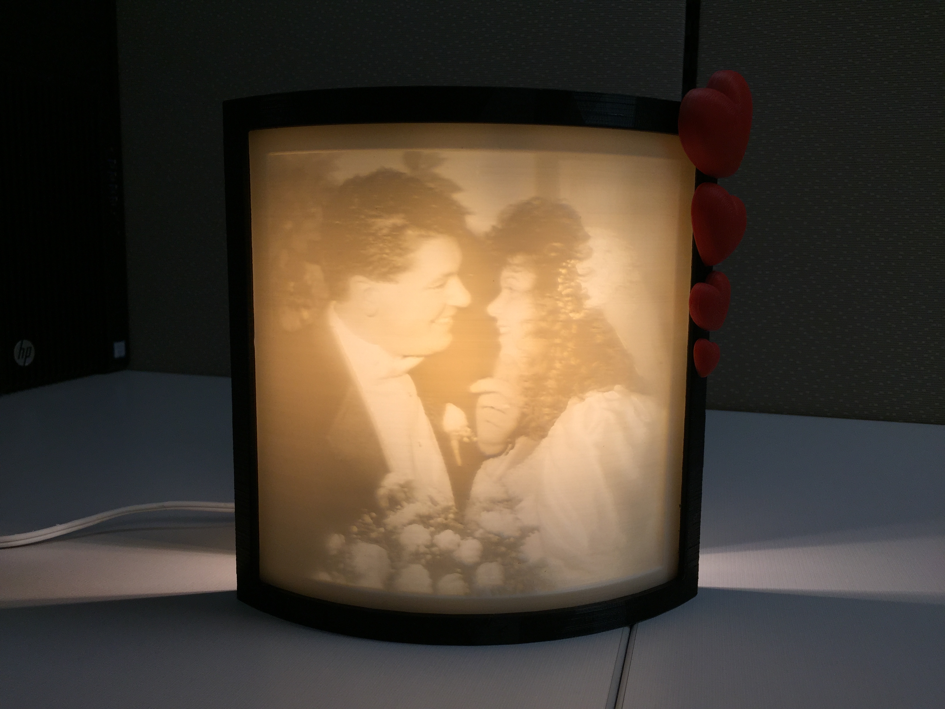

Here is a pic of a Lithophane lamp I printed out for my anniversary. Comments welcome.
Lithophane Lamp
Lithophane Lamp

As seeing is believing, would like to see a 360 degree for the Lithophane lamp.
What was it 3D Printed with how many color filament were used, what setting were used on the 3D slicer.
Cannot believe seeing more than 4 colors many shades of same in this simple Lithophane, including strands of hair on her head without light showing thru a photo on rear.
Black, Gray, flesh and white
Re: Anniversary lamp for my sweetie
There's only one color of plastic. What you're seeing is why lithophanes are cool. I've made them out of Corian on a cnc router.
The "color" is controlled by how thick the area is - thicker for darker, thinner for lighter.

Hi Roberts_Clif,
This was made out a few prints. 1 for the lithophane (MakerGeeks Raptor PLA White), 1 for the frame (2 parts MakerGeeks Raptor PLA Black) and the hearts were printed separately (HIPS Red that's been lying around forever) and glued on. I'm still dialing it in before I take on (if I do) a 2 color printer upgrade. I am also uploading the STL files I designed for the frame - feel free to use. The Heart is on Thinginverse: https://www.thingiverse.com/thing:2782886

In addition, I bulked up the supports too much, so use care removing them, but the wiring channel came out great.

I made the lithophane from my photo using http://3dp.rocks/lithophane/ and selected the Curved option and large border(arbitrary) and made it 8mm thick. Make note of the "Positive/Negative" switch on the image settings page, I had it wrong the first time and had to go back and export another .stl - the darker areas of the photo should be thicker on the lithophane! It made the .stl file for me - a pretty cool site for the service they provide (gonna throw them some $ via patreon). I brought that into Cura and scaled it up and designed the frame around that. The Lithophane to 2 days to print as well as the frame taking the same amount of print time.
I was going to go elaborate with LED strips, mini-switch, fuse etc., but Amazon logistics lost my package on the last leg of shipping, so back to 'KISS', buying a candle lamp from AC Moore, busting it apart with hand tools, and adding a 40w (equivalent) LED to make the effect bright enough. The good thing is that even though it throws a lot of light, it's still 5w, which is under the 7w max for the fixture. The spacing of the bulb in the frame from the lithophane kept it cool so I don't start a melting/fire incident.
