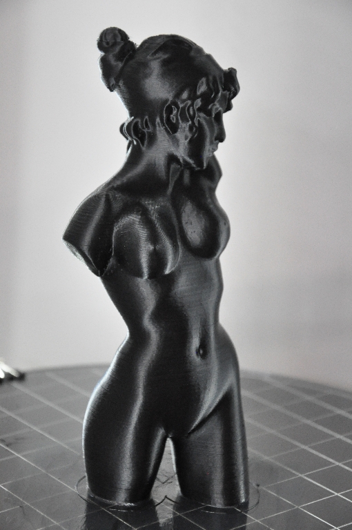

I am going to share my latest print with and one I am most proud of. Please don’t take offense it is for mature members only!! Must be 18 year or older….. I wish I could say it was my first try but it took 3. Fist two I tried to slice using vase (shell only) with no luck. All pics are untouched still on the printer just after completion
She is truly beautiful!
12hours print time
1.75 ABS
.35 tip
KISSlicer with 33% straight infill
.200 Layer height
At a speed of 30mm
I had no idea this printing stuff would turn me on the way it has…. Haha
Happy printing!

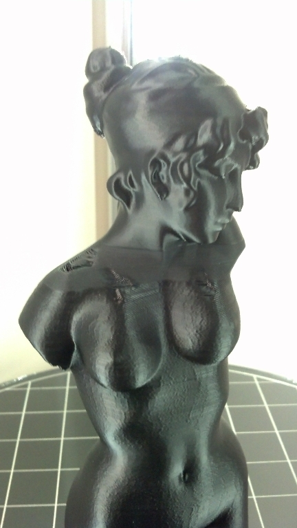

How/When did you put in the chin support?

Hi Buddy, The chin support was easy. KIISlider showed me at what layer/mm hight I would see the first island. I just slipped my fixture onto my column, mounted the putty knife and started watching my LCD DRO for height. I slid the fixture up to keep it flush with the print level. There were about 7 or so layers that were islanded before it connected back up with the model. I had gone out to dinner taking longer than I thought to get back only minutes before my printer was at the chin layer. I was so happy I caught it in time!! Also it was fun to watch the printing of the head with so many cantilevers I was in awe.

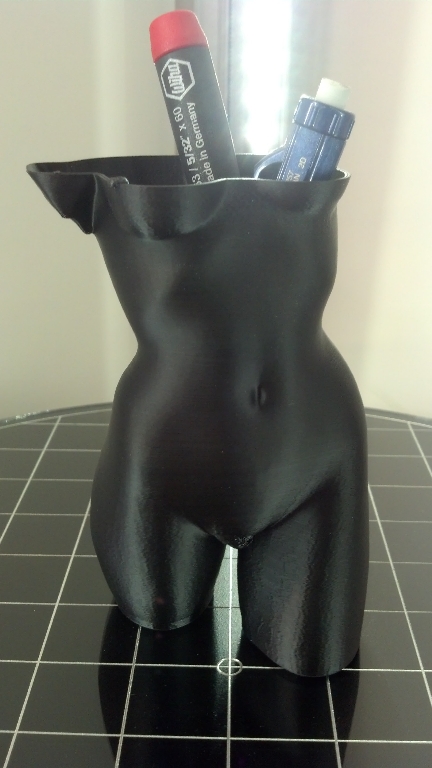

Thanks Flateric, Here are my failures, although I now have a very nice pencil holder. That fail was actually because for absolutely no reason my Microsoft Surface decided to turn off!! After 3-4 hours it just turned off. Keep in mind I did every to make sure it would never do that! The Surface has done that twice. Needless to say I cannot use it for printing anymore. The best Microsoft computer tech I know looked at it and said ----Huuuu---- I don't know why it did that. Anyway now I am using a small Gateway net-book and its working great. The other fail was when I just could not get any more horizontal out of the printer doing a shell. I even had 3 loops. I quickly realized I was asking too much! It did help me to notice how smooth I could get by playing with the feed speed!! Very cool.

A very nice pencil holder indeed! You could have claimed you stopped it there for just that reason! LOL
Yes, that's it, I meant to do that!

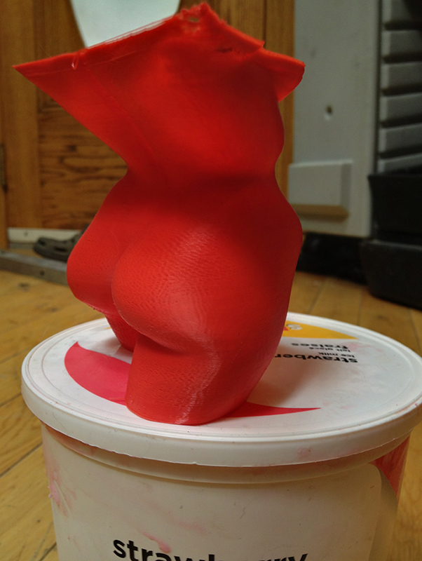

Ok here she is!
She actually quit on me at about the same point as yours so I also have a pencil holder.
Just yours is far far more attractive and doesn't need heavy lift equipment to get around.
The funny thing is, I have no clue how or why this turned out like it did and I doubt very much I could have managed to get this effect if I had tried.
Odd that the layer size and finish is so good on such a badly proportioned model. Layer size was .15 with a seeme stock hotend and a .35mm nozzle.
She even got cottage cheese thighs, LOL.
Wow prepare yourself!
But since I am such a nice guy Berry, I'll trade ya straight across your pencil holder girl for mine, what do you think!?
Limited time offer now, don't think too long.......(pssst, I can't keep her here any longer, she eats too much!)
Seriously why did this happen though? (and also why me? LOL)
