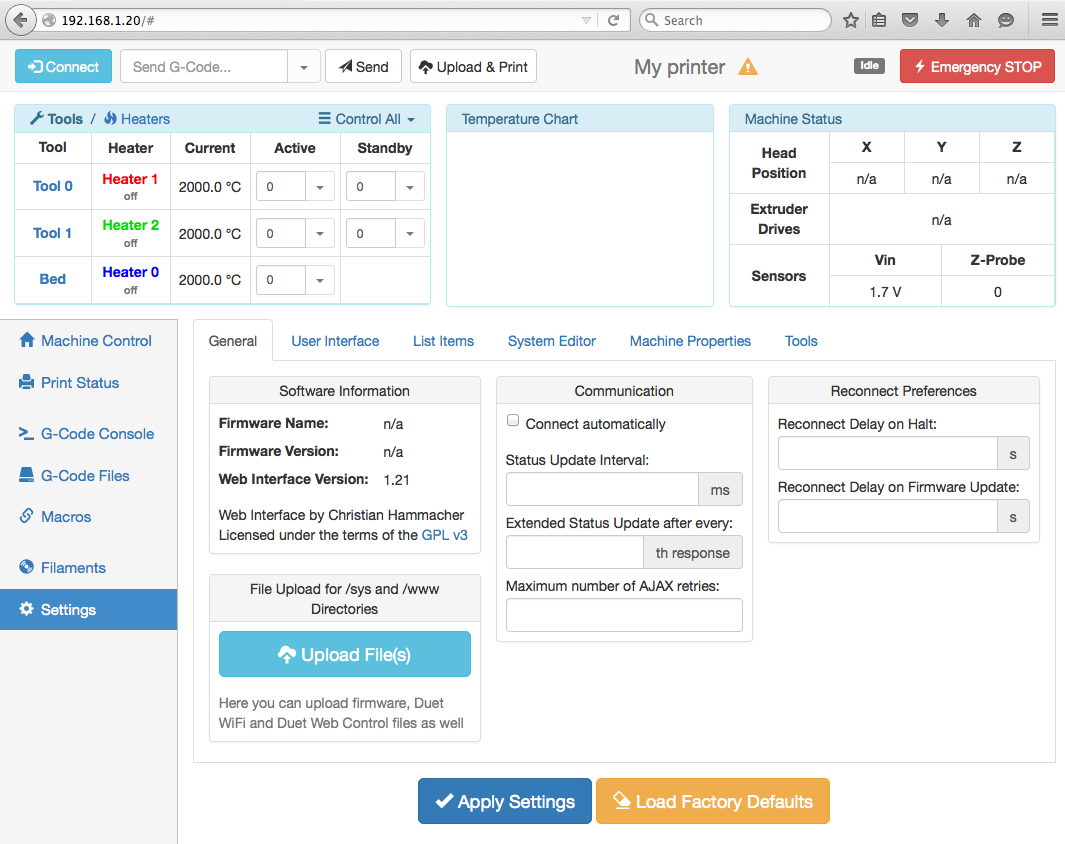

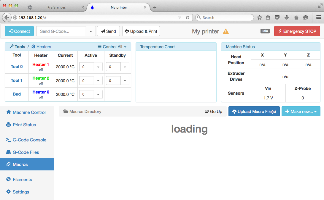

On one MacPro 3.1 I use Firefox 41, on the other one I use Firefox 57 - same result.
In Firefox's Prefs, I could Not find anything JavaScript.... So I installed "Java for OSX" - no difference.
In WebControl, in all tabs (Machine Control, Printer Status etc.: when I click on the "Connect" button, it just very briefly blinks the Orange field (about the size of the "Disconnect" button, for about 0.1 seconds, then shows the "Connect again.
Otherwise Nothing changes - EXCEJPT: in the "Settings" tab: it shows some more Info.
Please see Pic Settings 1 and 2.
Also - in ALL Tabs, next to "My Printer" name field, that yellow triangle: When I hover over it, a Message appears: "Some Axes are Not Homed"....
That is correct - because I have Not installed it into the Printer yet.
Could that be the Issue?

It's connecting properly from the looks of it (at least in the first screen shot). Since you have no hardware connected, such as thermistors, endstops, etc, and don't seem to have a password or custom name defined, it's not really doing anything, but it's connected.

RayGun wrote:On one MacPro 3.1 I use Firefox 41, on the other one I use Firefox 57 - same result.
You don't need Java. Javascript is built into all browsers, but some browsers provide an option to disable it, normally in the Security settings. However, without Javascript working, I doubt that you would get as far as you are getting.
RayGun wrote: In WebControl, in all tabs (Machine Control, Printer Status etc.: when I click on the "Connect" button, it just very briefly blinks the Orange field (about the size of the "Disconnect" button, for about 0.1 seconds, then shows the "Connect again.
Sounds like it is connecting and then immediately disconnecting. Please open the debugging console in your browser (it's typically control-shift-J to open it, but I don't know if that works for Safari) and see whether any errors are reported when you press Connect.
RayGun wrote: Also - in ALL Tabs, next to "My Printer" name field, that yellow triangle: When I hover over it, a Message appears: "Some Axes are Not Homed"....
No.

NOW IT WORKS!!!
Web Control NEEDS Cookies - "Accept from Visited" ("Always" is Not needed...)
For anyone reading this - and having issues to Connect via Ethernet:
Select "DHCP" You CAN set up "DHCP with Manual Address":
- The IP Address for your computer - the LAST Digit Group MUST differ from the IP you assigned to your Printer.
- The IP Address is - for Mac - the Only thing you need.
