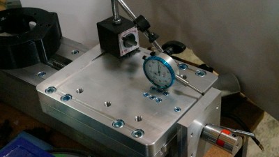

I'm nearly done with the machine, still a few things to go before it works though. Here's a video I just took of the boxway linear motion. One of the main arguments for using recirculating linear ball guides instead of sliding boxways is that boxways supposedly have stick-slip, where they cannot position smoothly at a microscopic level. Looks like my boxway design, for whatever reasons, does not suffer from this.
Each tick mark is 0.001 inch. It seems like the mechanical system here is nearly flawless. Backlash without the nut being preloaded is 0.0008", with preload it's less than 0.0002".

Very encouraging. Be interesting to see how it goes when loaded up and again after a few tens of hours' wear but then, of course, it's pretty easy to replace the plastic slide if it gets worn, yes?

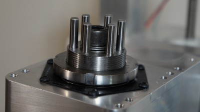

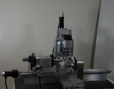

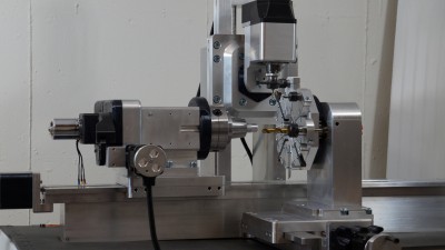

Long time since the last update!

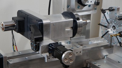

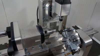

Unfortunately progress slowed down a lot since the last update, a bunch of annoying things happened. I had to go through 4 backup plans for the B axis (swivel head mechanism) because the first harmonic gear didn't work. So I made several hypocycloid gears to try as plan B, none of them worked well enough. Then I made a compact worm gear system, but there wasn't enough room in the mill column to get it working that well. Then I made a bigger worm gear version that stuck out the back of the column, but it wasn't rigid enough in transmission because of all the printed plastic parts stacking up rigidity loss.
Then I changed the original harmonic gear design and reprinted some stuff, it's much better now but not perfect. Mid December was the last time I had access to a machine shop, so no metal parts since then.
On top of all that, I had problems with the headstock belt drive. I had to print like 10 pulleys to get it working, because the belt tensioner was causing torsional friction in the system. Now there is no tensioner, the pulleys are at an exact distance and an exact diameter to tension it.
And the cheap Chinese ESC that controlled the motors on the V1 machine couldn't spin the low KV motor that the V2 uses for some reason, so I had to buy a VESC. Then the VESC blew my 24v power supply (I think) due to regenerative braking. Now I'm waiting on a new 48v 1500 watt PSU to show up.
So to summarize, the last month and a half has been annoying things not working due to budget constraints, time constraints, lack of machine access ect. I've gone through 8 kg spools of black PLA on my rostock max v1 to make parts that will be machined on the production version.
The machine does cut metal, both turning and milling are tested at this point. Really I'm just waiting for the big power supply to show up in a week, until then I can't do any really heavy cuts with my weak backup 24v psu that was re-purposed from the V1 prototype. Once it's here and plugged in I'll start filming the kickstarter video.
The wear pads are just sheet plastic cut into small rectangles and pressed against the boxways. They should cost a few cents each to make en masse on any laser cutter or waterjet. If I use Delrin AF (the PTFE stuff) they may cost a dollar or two each, but that's because the stuff is ridiculously overpriced at retail.Be interesting to see how it goes when loaded up and again after a few tens of hours' wear but then, of course, it's pretty easy to replace the plastic slide if it gets worn, yes?

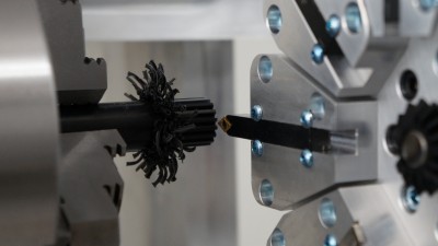

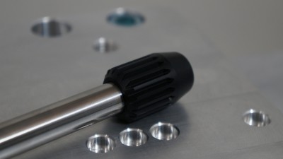

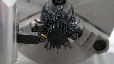

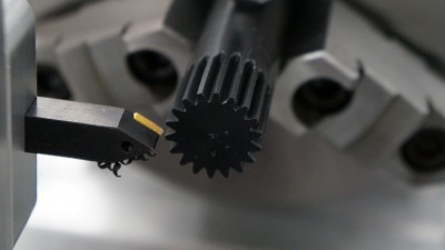

I should be done filming the kickstarter video by the end of this week. Here's a part I made a few hours ago;
Single point broaching is fun, and really easy to program by hand. This finished part took just over 8 minutes.
I wish my Rostock could print parts with the same mechanical accuracy and finish as what's coming off this machine. If you go back to the very first original post in this thread, this was one of my goals and reasons for making this machine.
Assuming the kickstarter doesn't fail miserably, there will be hundreds of these mill turn centers in the wild by mid year, and they will give 3d printers a run for their money.
