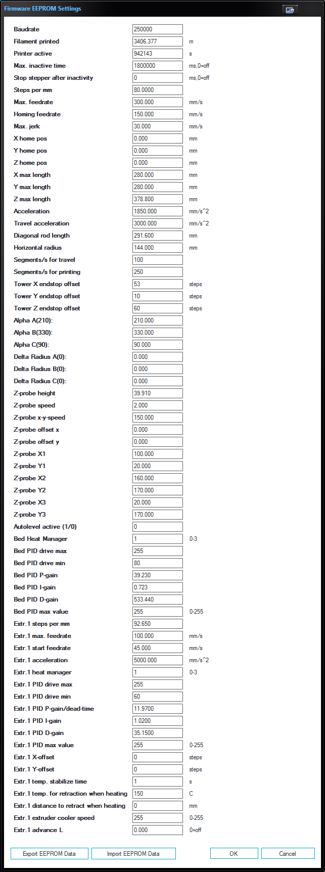

In that case, can you export your slicer settings, as well as dump your EEPROM for me? Both should be relatively simple, as the EEPROM dump can be done basically by opening the EEPROM settings in mattercontrol, and copying the log as it loads them from the printer, while most slicers have a settings export tool.  Pictures of the build up on the nozzle might help slightly, although if you're getting very little of the first layer to print, it's not too likely to help.  Perhaps a close shot of any loops around the print itself it completes, or of the nozzle as it's laying down a track (this does require careful positioning, as well as starting a print that's likely to fail, so I understand if you don't) would be helpful on the picture front.

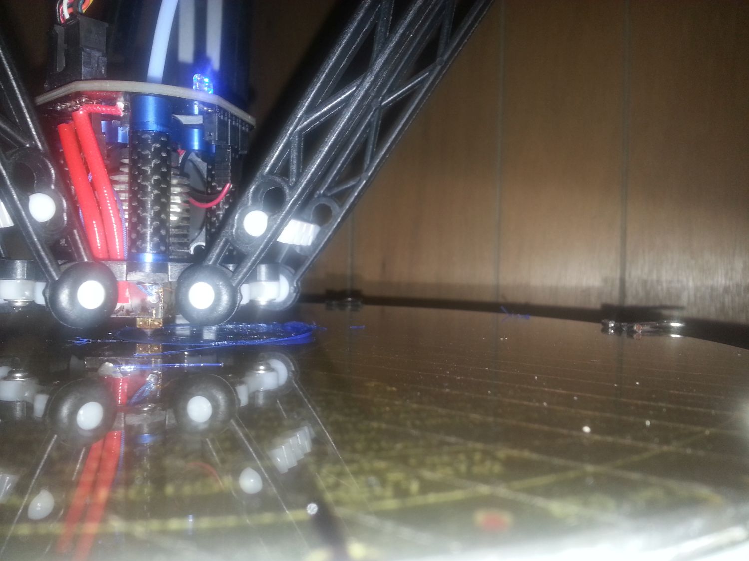

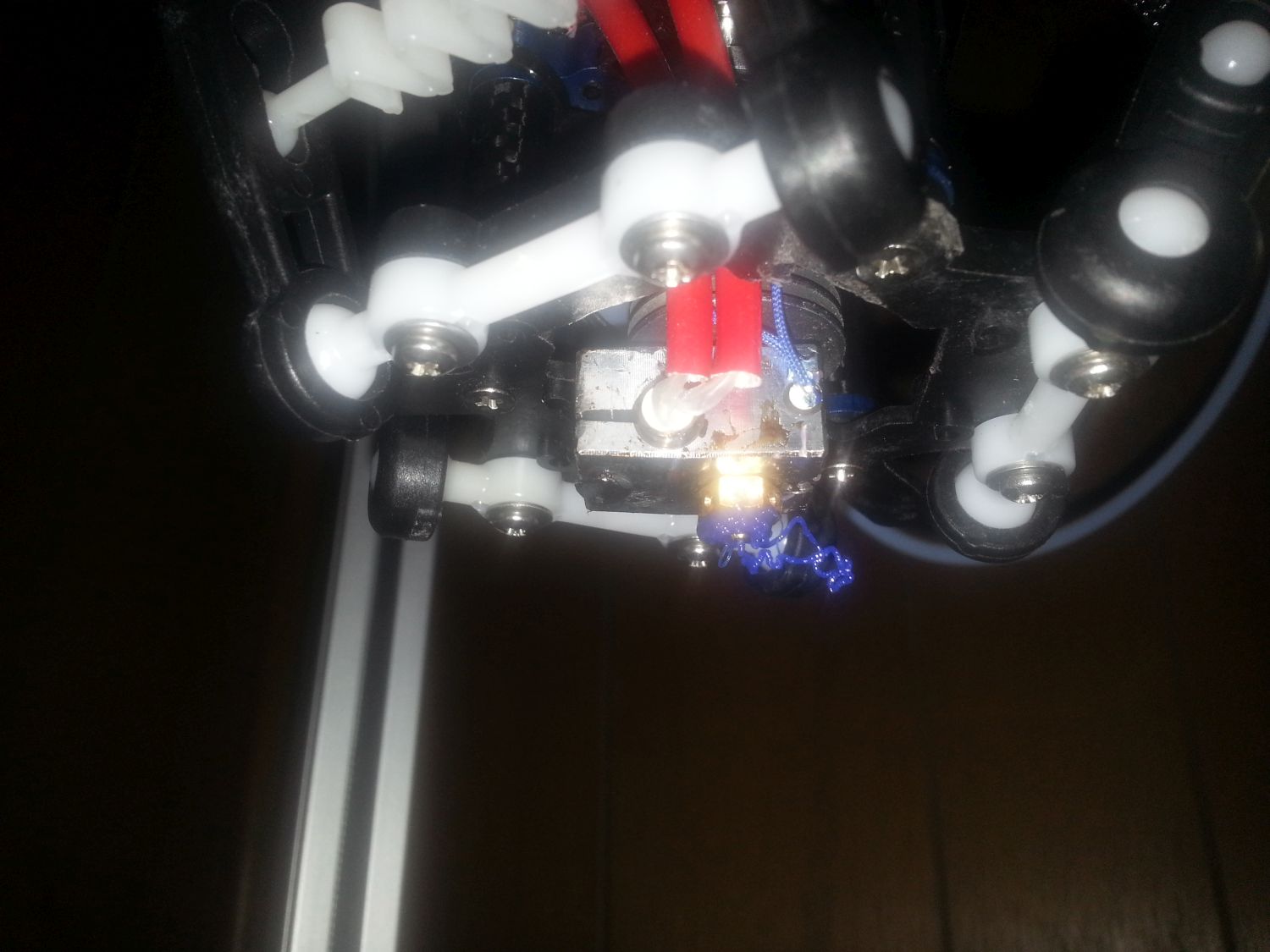

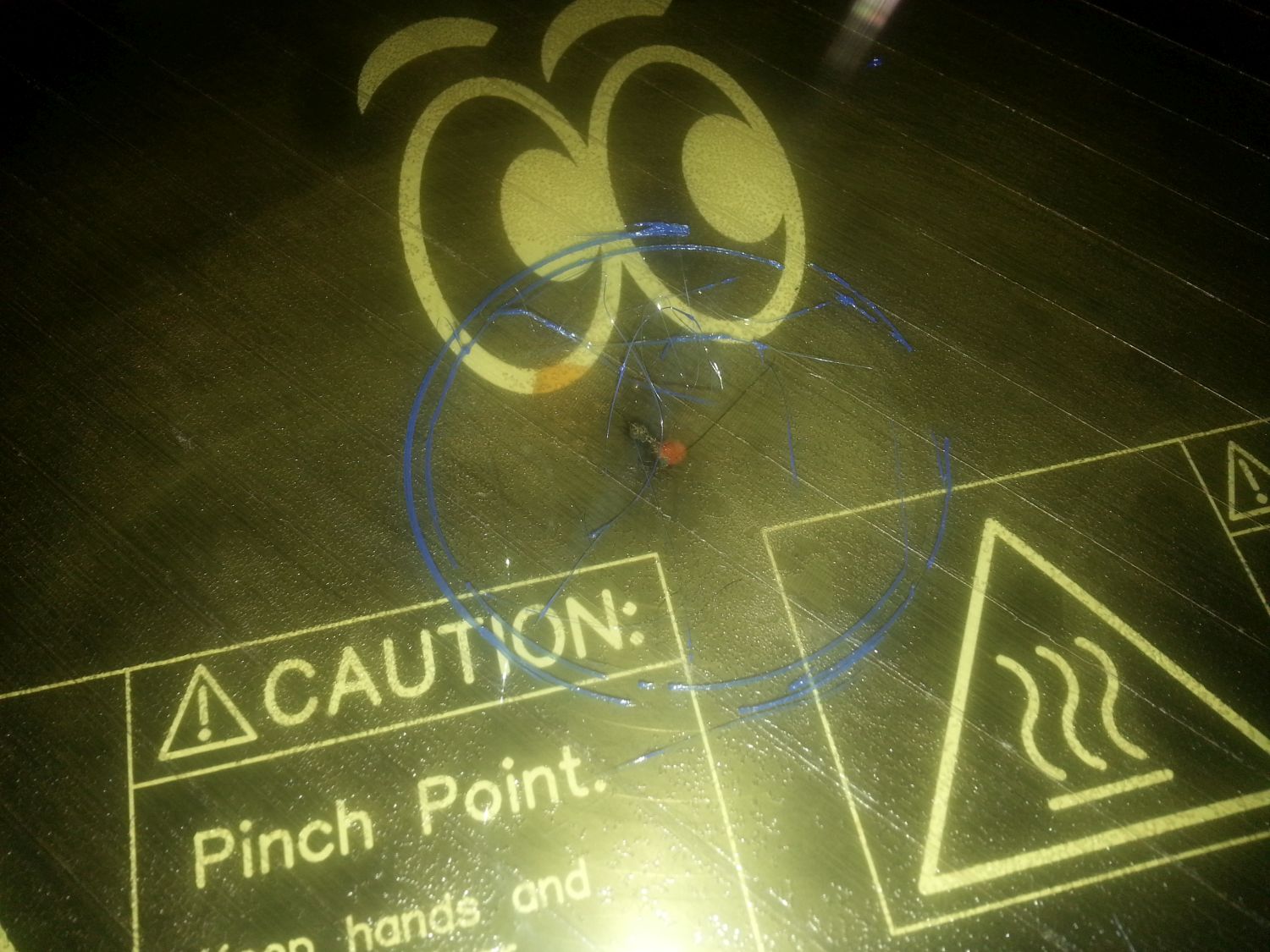

Re: Calibration Nightmare

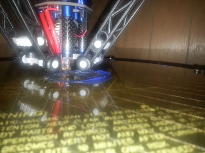

OK, so I had a long troubleshooting session last night and I think I'm getting somewhere.
This is what was happening every time. just a globby mess.

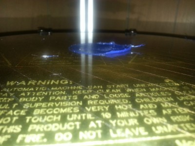

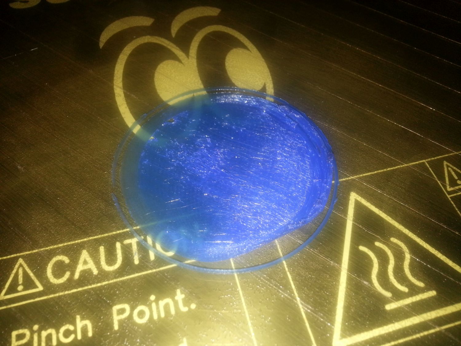

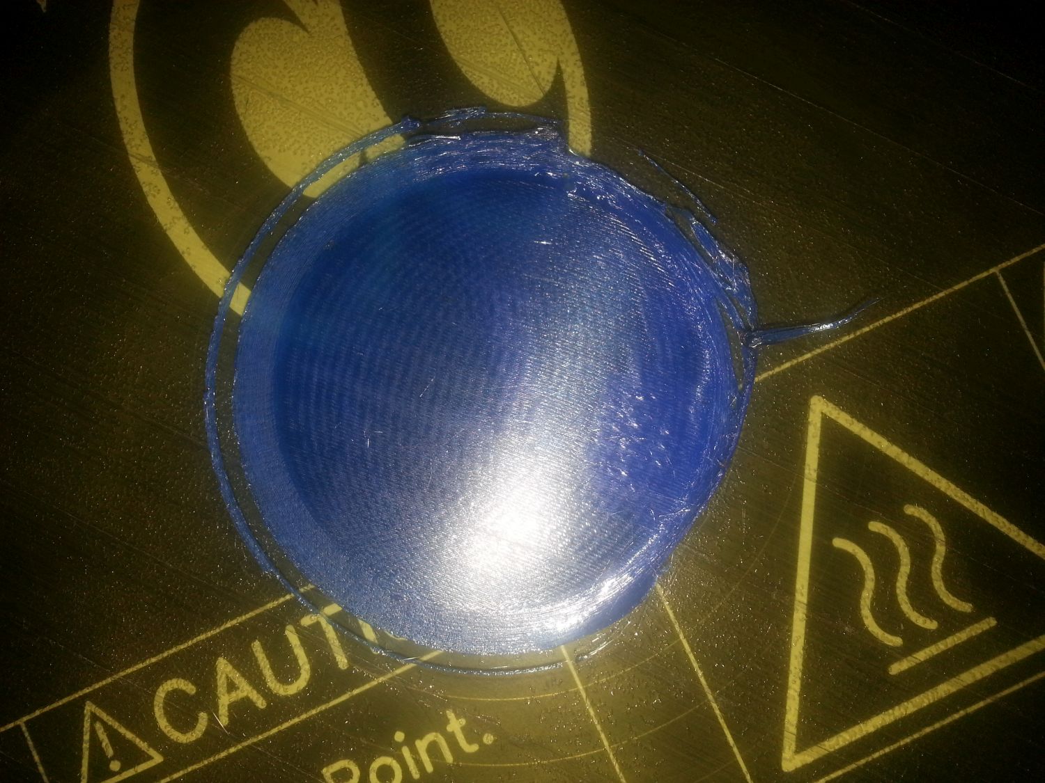

I re-leveled again, and started the print. It failed of course, so i added 50 microns to my z-max and tried again. I did this about a dozen times until something finally stuck. I'll list this attempt as the first attempt for simplicity. It was ugly and the skirt completely flopped, causing buildup and stringiness. I let it go anyway and it managed to finish the circle. The Y tower side was already detached by the end of the print so I just peeled it up from there.

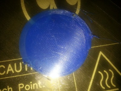

I could tell it was obviously out of level, but the result surprised me because the Y tower was the tightest against the feeler gauge so I expected it to be the thinnest side. Instead it was the thick messy side, with the opposite end around 0.07mm thick. I measured the flattest part of the messy side at 0.21mm. I figured first step was to fix the level issue so I reduced my X and Z offset by 5 steps and added 5 to my Y offset. this is the next print.

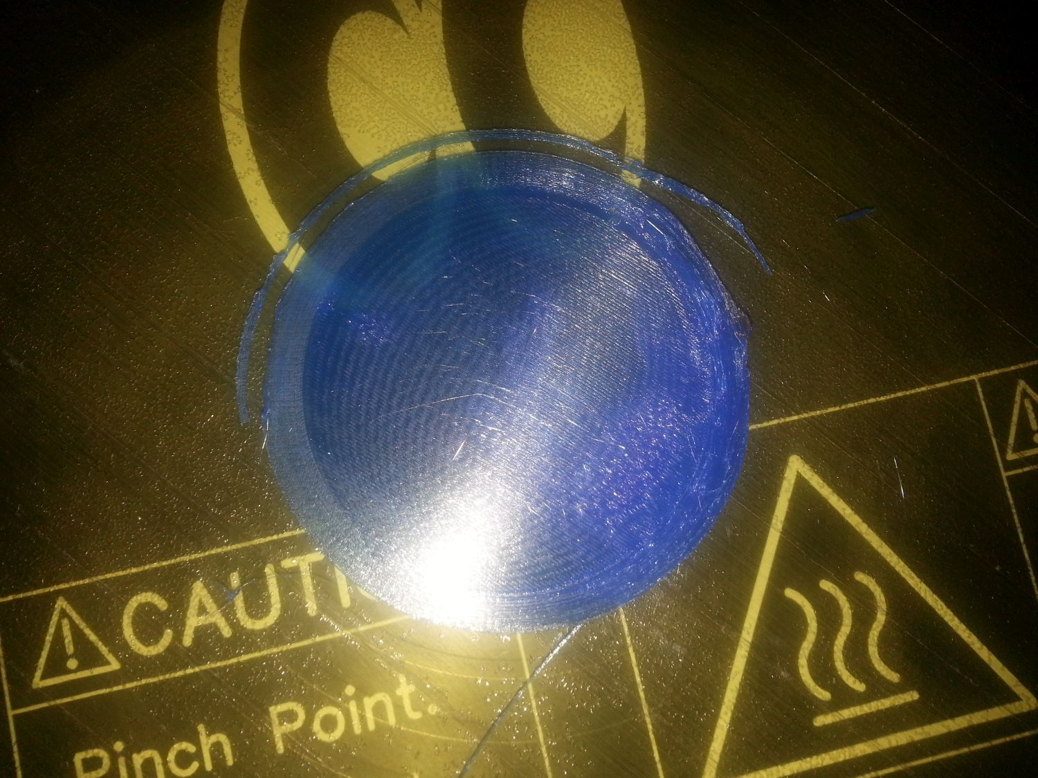

This one was fairly messy as well but it was closer. The thin spot was still opposite the Y tower at 0.13mm with the Y side at 0.20mm. I figured I was on the right track so I repeated the process.

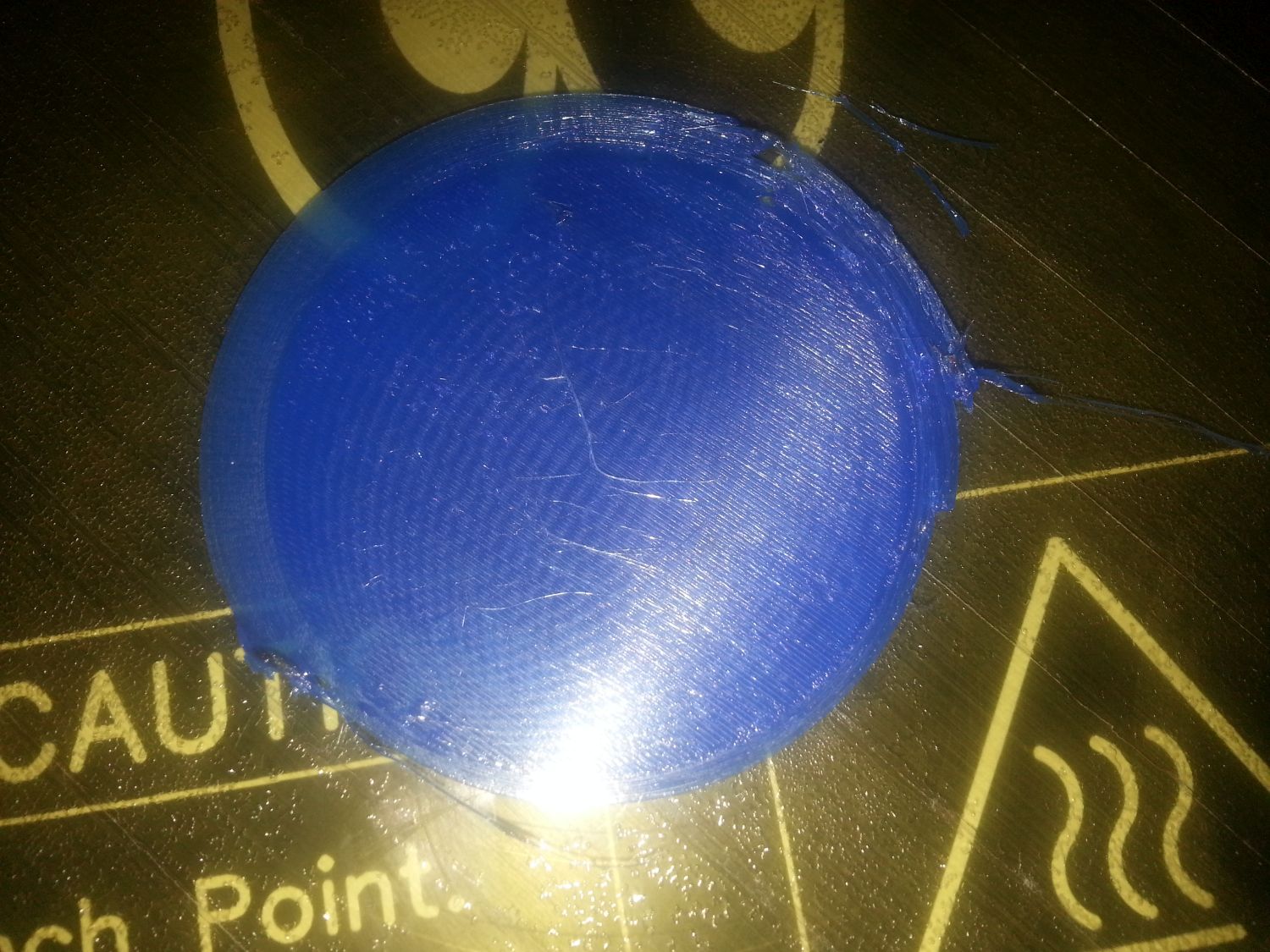

Even closer but still a mess on the Y side so I chose to only change the X and Z this time, as the thin side was now 0.18mm

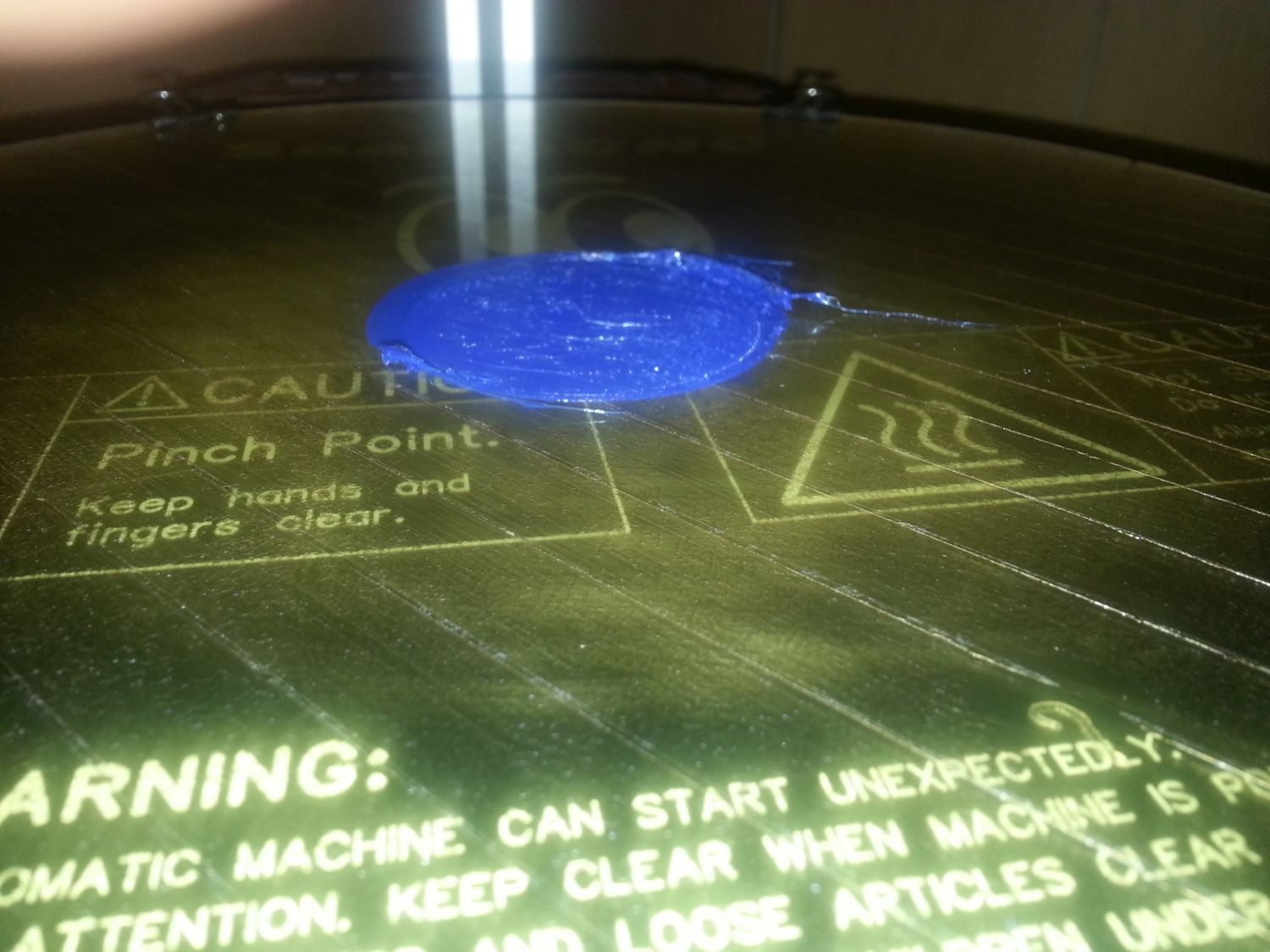

The print never got started so I aborted and went back to adding 50 micron advances. It took three attempts to get another successful adhesion
That's where I am at the moment. I'm at work right now so I haven't had a chance to export my settings. BTW, dumb question, but how do I export slic3r settings? I know the eeprom part. I should note that for all these prints I was printing at 250c as apposed to the 245c from the other day. I may try 255c the next time I try. I also need to change my skirt settings. It's clearly needed to get the nozzle primed but I have to sit there and grab it with tweezers bit by bit so it doesn't sabotage the rest of the print.
