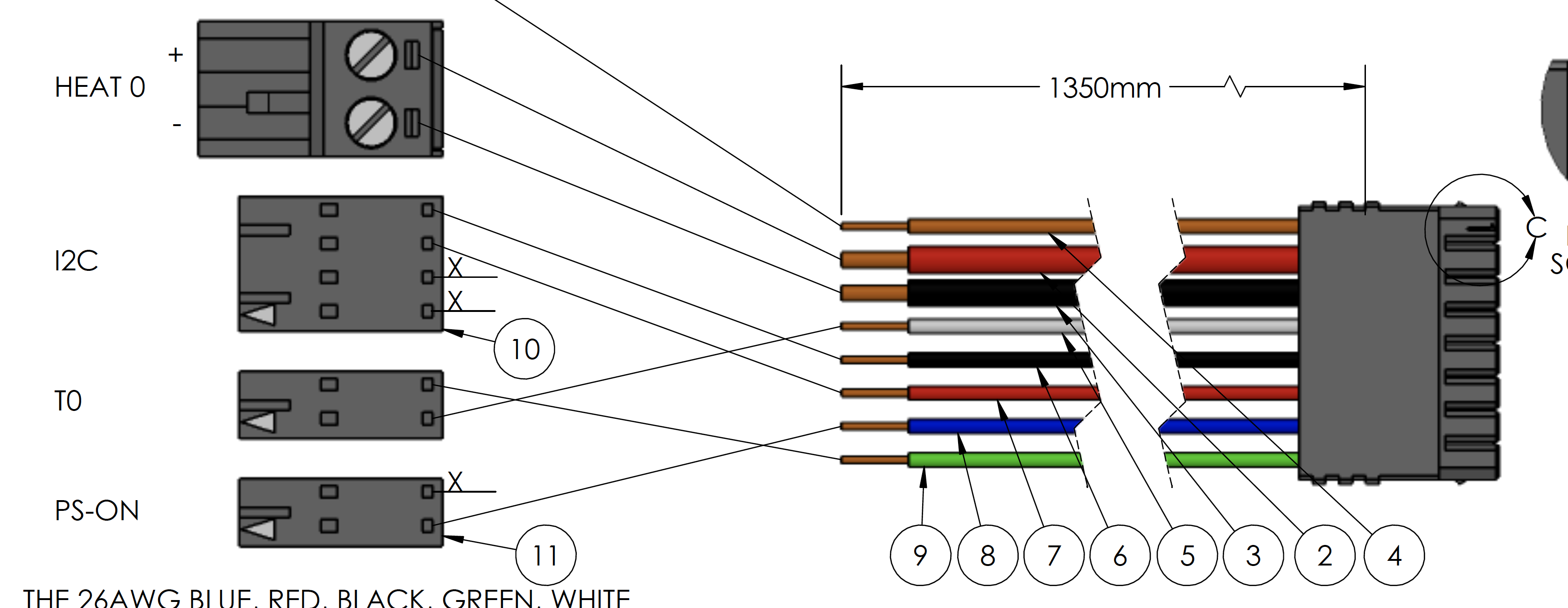

3. Physical wiring/thermistor problems
- Cable has fallen out
- Failed component
- Wiring issues
If you have the HE280, but have not printed out the whip clip. This will help hold the wiring connector in the top of the HE280.
3b. Failed component
- bad thermistor
- Failed heater cartridge or resistor
3c. Wiring issuesXenocrates wrote:3bI. A bad thermistor will fail to read the temperature properly. The cure for this is replacement. 3bII. Failed heater cartridge or resistor. The difference in symptoms is that a bad thermistor will either DEF immediately on booting, or will stay at the current reading without change (Either too high, or low). II will only DEF after a heating attempt, as the watchdog times out. It can also show as the temperature failing to rise (Both hotend and reading in this case), or rising very slowly (due to a resistor dropping out or similar). It is very unlikely to see it rising faster than it's supposed to due to a failure, however PID can somewhat tame this (At least until a mosfet blows)
Update on 4/4/2017 to include information from XenocratesXenocrates wrote:This is usually due to a short (two things connected which aren't supposed to be), or an open (Not connected when they should be). I suggest for troubleshooting this, starting by unplugging the thermistor connector, and reading the resistance between the two pins. ~100K ohms, and it usually isn't this problem. However, use a hair-dryer/heatgun/candle to warm the thermistor, to see if the resistance drops at all. If not, test from one connection point to another in series to find the source of the problem (IE, Rambo connector to HE280 connector, HE280 connector to thermistor wire, thermistor wire to thermistor body, body to other wire, etc.) . Anything other than the thermistor reading more than a few ohms is problematic. If the thermistor reads less than ~100K ohms, it is either shorted (try reinsulating the legs or resoldering), or dead. See 3b-I.
