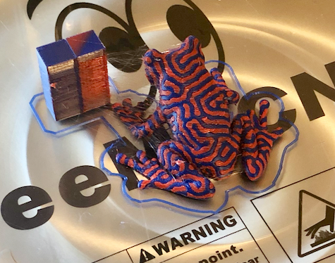

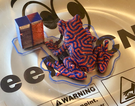

OK, I just upgraded my printer (Artemis) with the Y-Adapter.
Already did the changes to config.g file:
MS63 P1 D1 H1 F1
G10 P1 S0 R0
I'm using Simplify 3D, so I created a Dual Extruder Setup (fff file).
I can print with both extruders NOT AT THE SAME TIME. Individually both are working fine.
My problem is when I try to combine them.
I just cannot get the Script for "Tool Change" right.
I already searched all forums I could, including a setup for the E3D Cyclop (which is basically a Y-Adapter) but it seems that there is not detailed information on how to configure Simplify3D.
Somebody has already this upgrade working for the Artemis?
I read that a guy has a V3 with the same mod, but he says that he did nothing in Simplify 3D, that it was the firmware what took care of it. Already asked for more details.
Do I have to upgrade Artemis Firmware?

Ok, I got a first working version profile for Simplify3D (S3D). You can find it attached to this post.
I'm trying to replicate the same logic used in CURA by using the "Tool Change Script" and "Starting Script".
It is a first working draft of a work in progress, so take it with a grain of salt.
Two things to take into account:
1) You need to set both filaments at same distance as if you were using the profile for CURA, this is, around a 40mm gap between the Y adapter and the end of the filament.
2) I hardcoded a XY postion where the nozzle moves to change tools X=0,Y=-130, if your print is using this coordinate will get that spot with lost of "strings"

This is my second print using this profile for S3D, not bad, but still needs to be improved.
